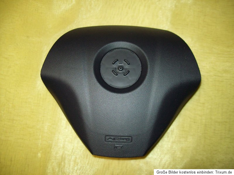

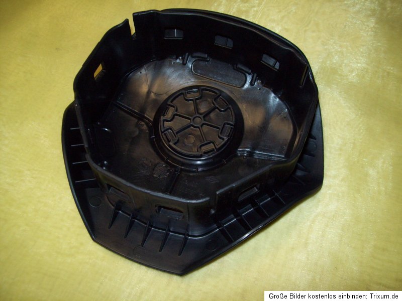

Found this on ebay:
If it is the same as a Lancia delta airbag in construction this is not difficult, disconnect the battery and leave for about 30 mins then release the airbag by pushing the spring bars through the side trim of the wheel hub ( you will see round makers on the trim which indicate where to push in the tool, you need to fish around a little to find the sprung bars. I found an Allen key to be better than a screwdriver). Disconnect the complete bag and Lift this out. You can then undo the nuts holding the assembly together which will allow you remove the back cover/central 'bomb' which is loose simply centred by a plastic protrusion on the back cover and to slide the front cover off ( this hooks around the assembly when the back cover is removed you can simply push the sides out a little, for which you need three long flat objects to slide down each side so that you can keep all three sides released at the same time!) Then pull the cover off. Be careful as you need to keep the airbag folded as manufactured (otherwise it will not deploy correctly) so do not do this roughly or fast. Assembly reverse of the above, simple but a bit scary!
