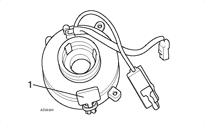

Does anyone have a guide as to how to change the airbag squib on a mk2?
Cheers ?

It's the squib behind the steering wheel not the airbag its self, I code read it at work yesterday
The diagnostics will say something like 'airbag squib open circuit' or 'airbag squib high (or low) resistance' the 'squib is the airbag but more often it's the wiring that causes the fault and is frequently a broken clock spring which I think is why the clock spring gets called the squib because people are fixing a fault with the 'squib' by changing the clock spring.
The issue is Punto clocksprings very rarely go wrong
I thought the squib was the airbag, so I was right, bloody googled it and it was saying clock spring :bang:![]()
