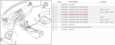

The part in your picture is an airbag control ECU. The part number on it indicates that it's only suitable for a Stilo without any side or head airbags, and without the Occupant Classification Sensor. It's located below the centre console. (I believe it's fitted a bit further forward than as shown in the diagram below).
Correct Davren. It sits on the transmission tunnel approximately a foot forward of where it's indicated in the diagram, and it's a fiddly job getting to it and even more fiddly removing the retaining screws!
