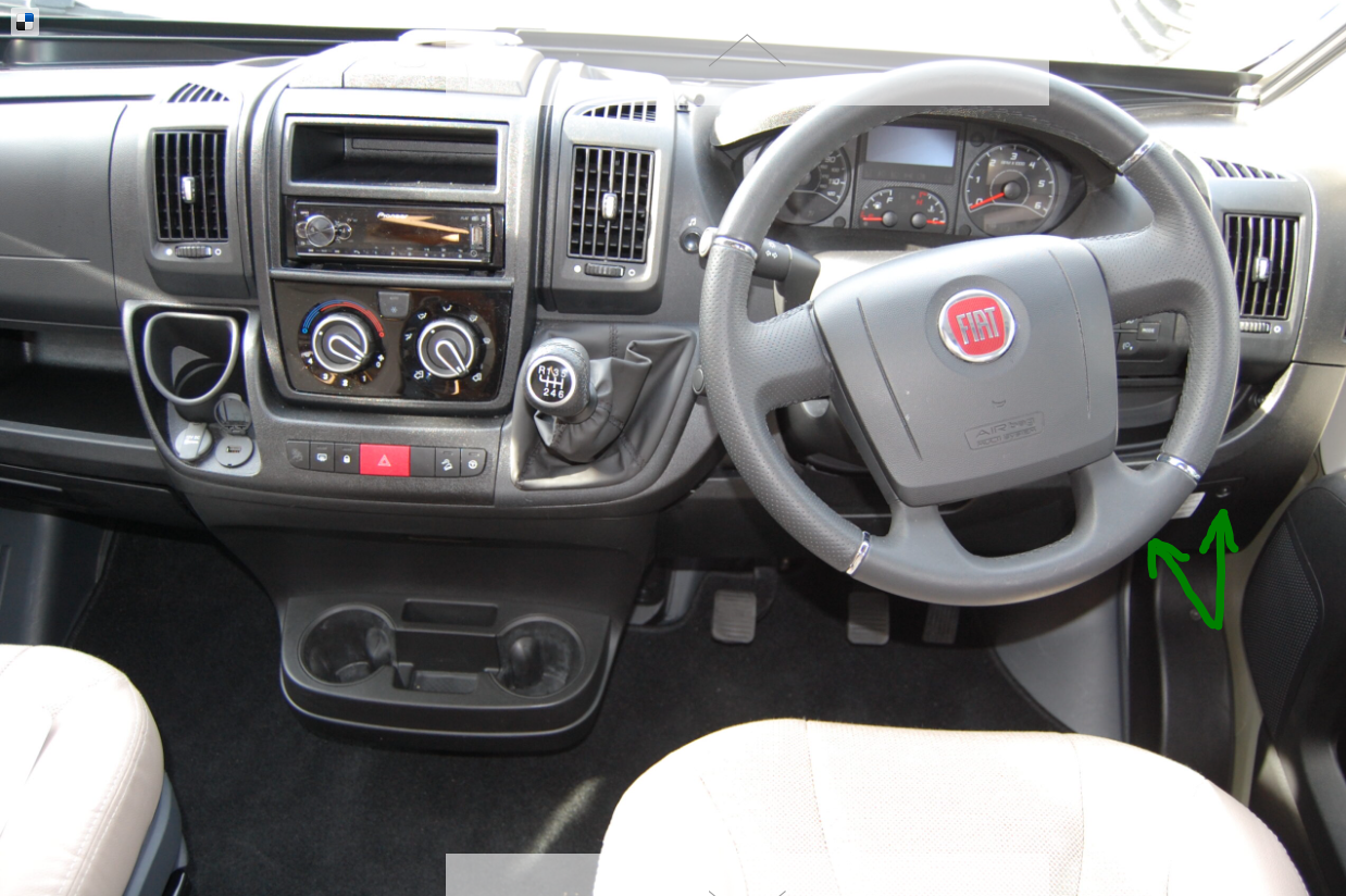

Hello,
There are usually 3 fuseboxes on the Ducato and siblings.
The cab fusebox is generally located around the driver's external knee. Looking at a photo of a 2020 Rapido, it's the same as it was in the previous (2006+) models. There are 2 screws that hold the cover.

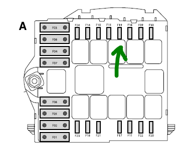

According to this Owners' hanbook (for a 2018 model), the following fuses have A/C in the description (the main fusebox by the driver's knee):
In the engine bay:
I don't know if anything has been changed between 2018 and 2020, but it has not been changed since 2011 to 2018 :)
Hello,
In the engine bay:
it's the AC compressor fuse box Im looking for. looking in the manual the image it shows. is not where the box is. (Image likely from a rpevious model)
