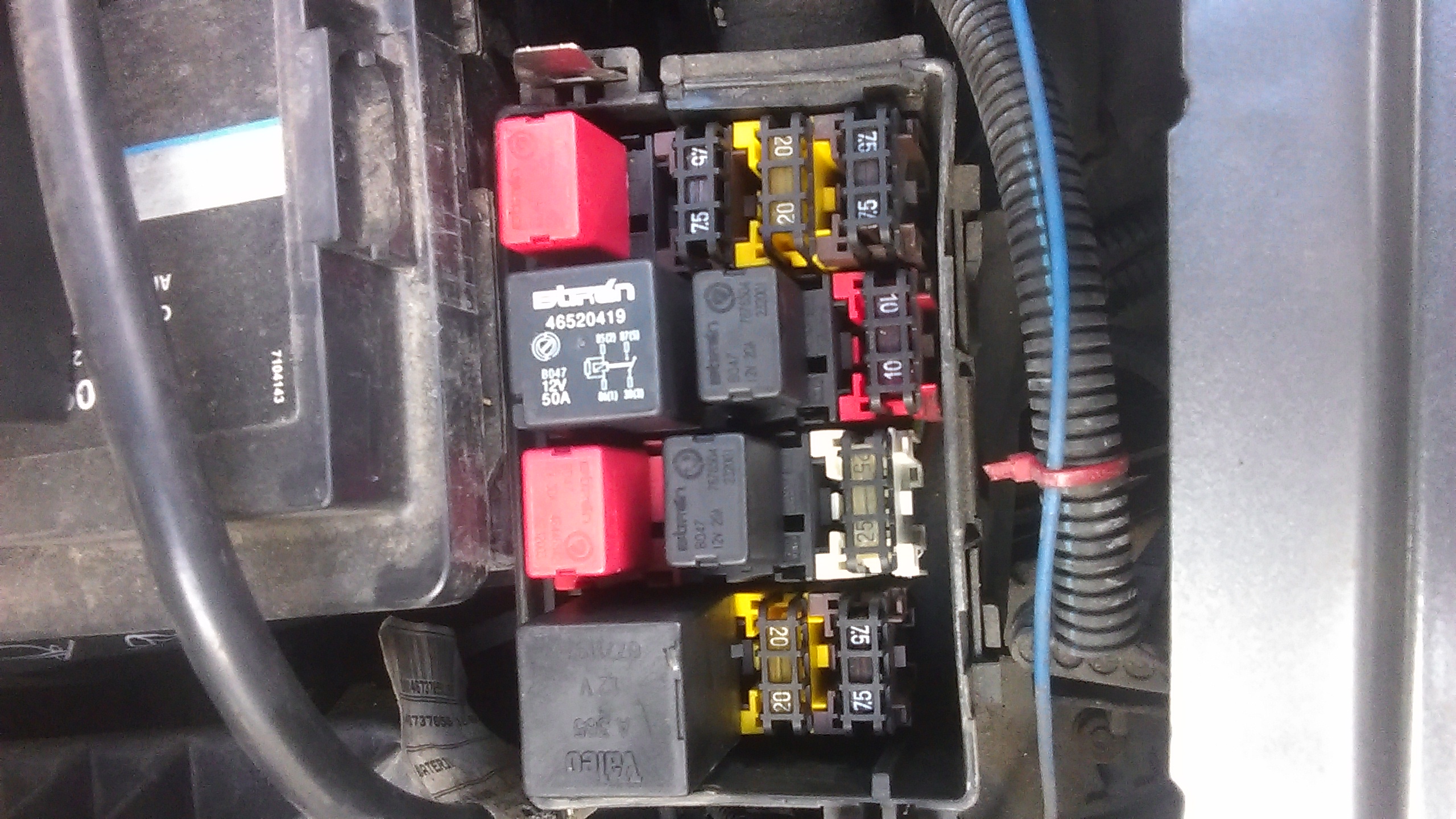

Hello. I have a 2003 Fiat Multipla 2003 1.9 JTDI had my Aircon regassed today. Unfortunately not working. When looking at a self diagnostics noticed that the Compressor is not spinning when the air con button is pressed upon the dashboard. I have checked the cigarette lighter and that is charging my phone. Thought I would check the relay fuse in the engine but do not know what number 41 is! Have taken a photo. Any help on this would be greatly appreciated. cheers

I don't know either but there are only 7 fuses shown in your picture why not check each of them?
I have found that the fuse locations and numbering in the drivers hand book don't always tell the true story!
My aircon pump sprang into life after I took out and replaced a couple of fuses but even after a re-gas the system was weak and not really worth the effort. Much easier to do it the old way and wind a window down ☺
Getting the right amount of refrigerant is just as important as having a sealed system and the compressor working. It might be worth getting it checked. The aircon is admittedly bit marginal on a hot day, but still worth having.
I have a similar problem with my air con system and i have had a good go at sorting it myself. Im going to try that fuse 41 which is actually positioned under the ridge where the headlights sit, just above the battery. there are three here and 41 is in the top left position.
