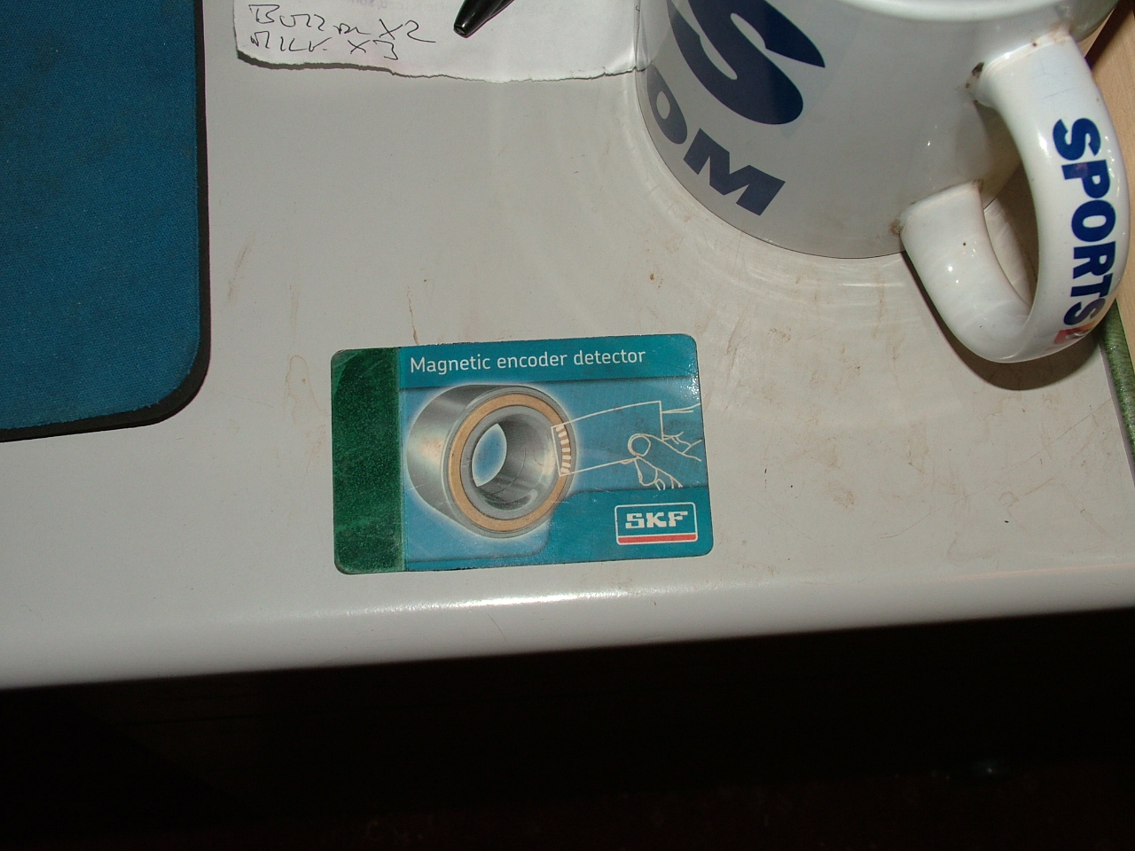

Some sensors can be checked for continuity using a Ohm setting on your multimeter. Photo below is a tester I got at a Mechanics show some years ago to test the bearing type magnetic ring for damage. It is possible to damage them simply by poking a screwdriver down the hole where the ABS sensor fits when replacing the old sensor, once damaged then only a new wheel bearing carefully fitted is the answer.
