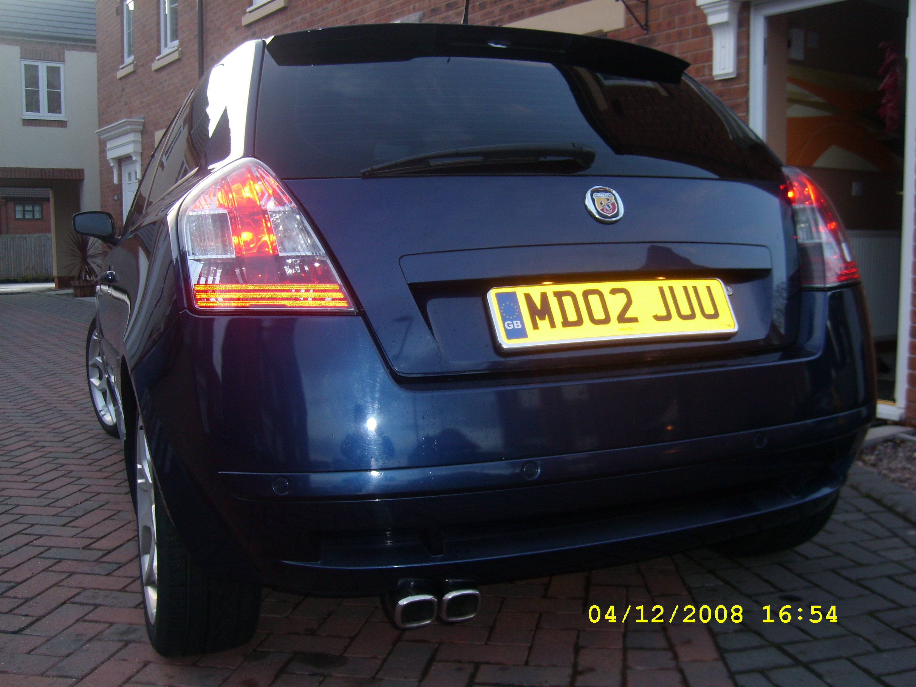

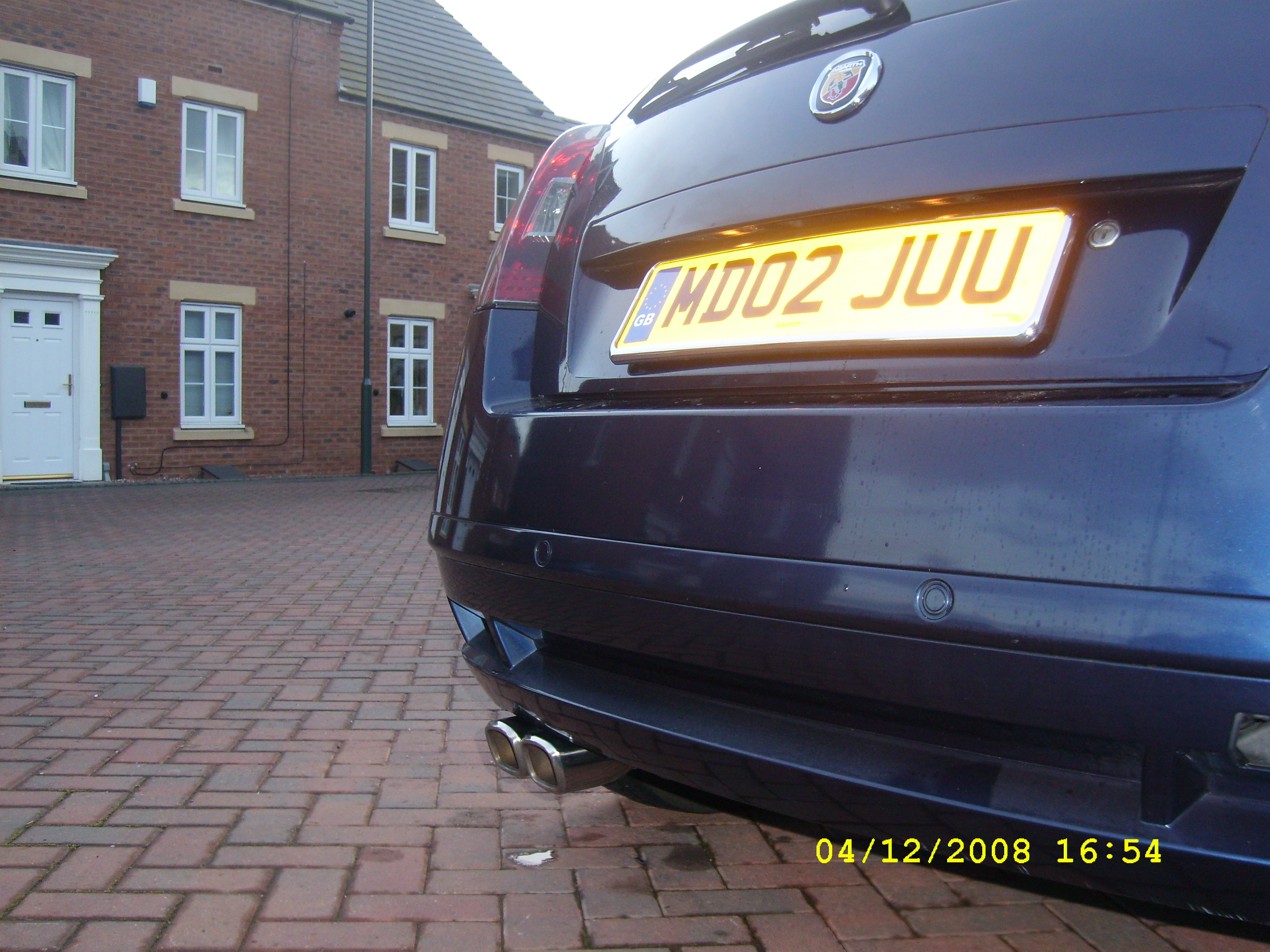

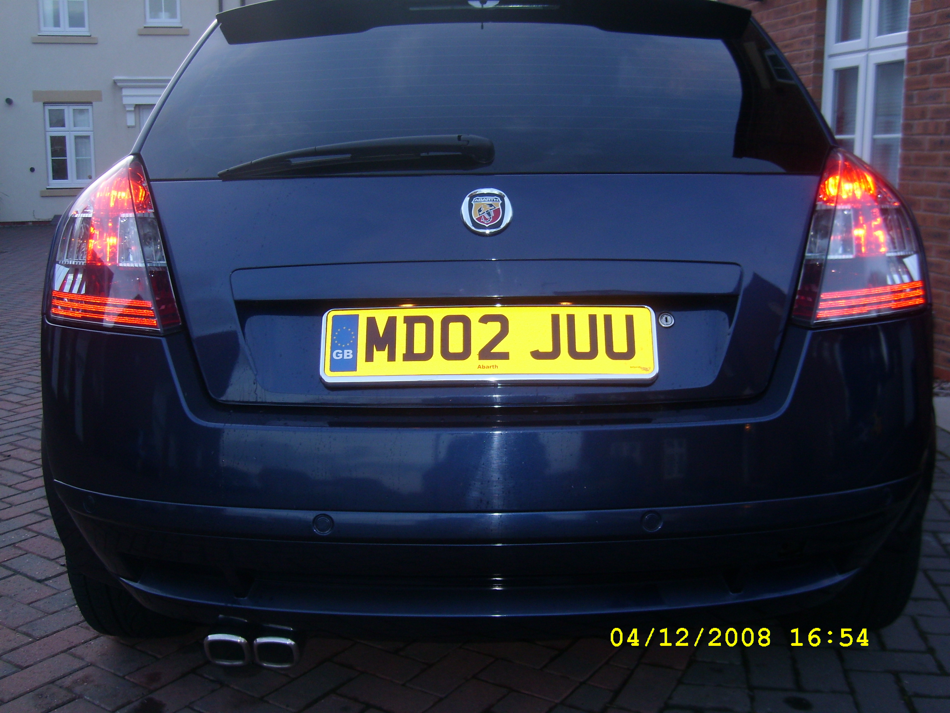

just had a stainless steal cat back fitted today by mij.
sounds great and looks a lot better than that droopy thing fiat called an exhaust.

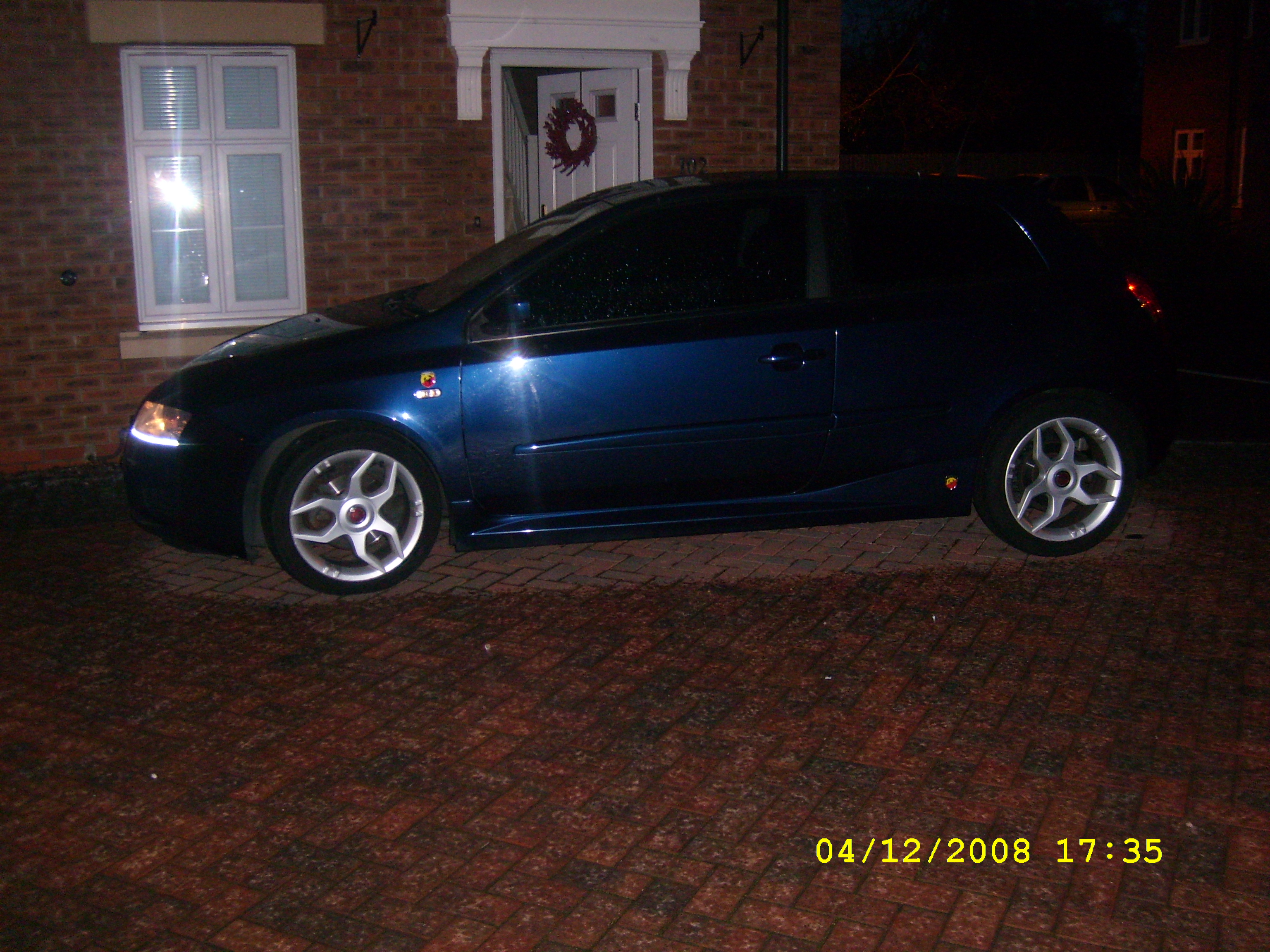

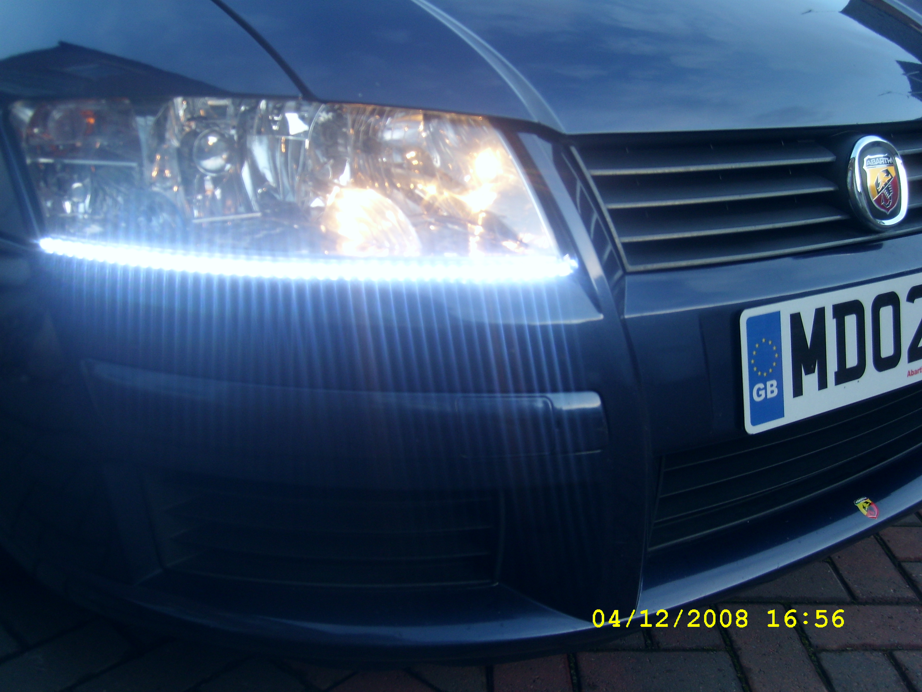

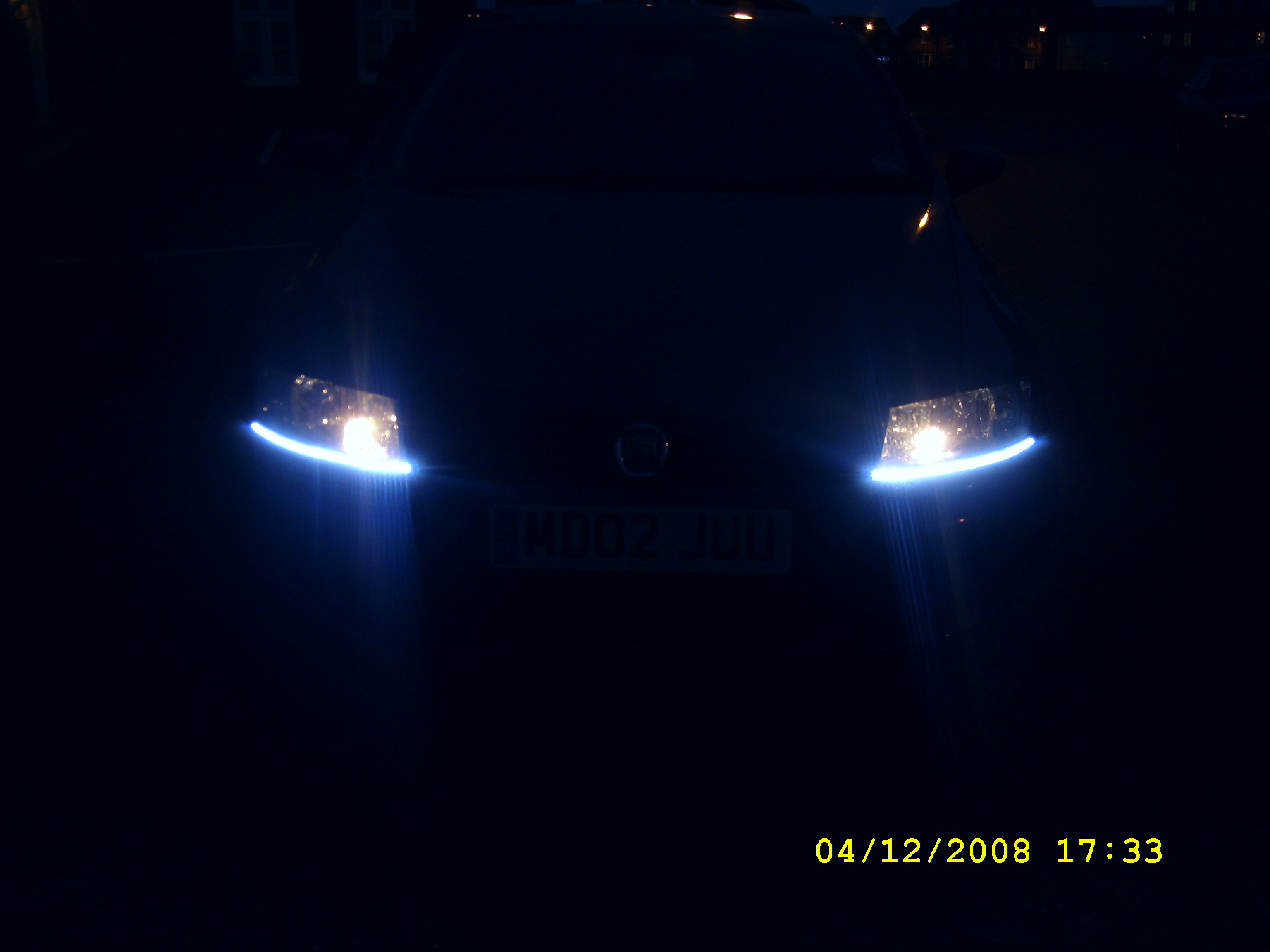

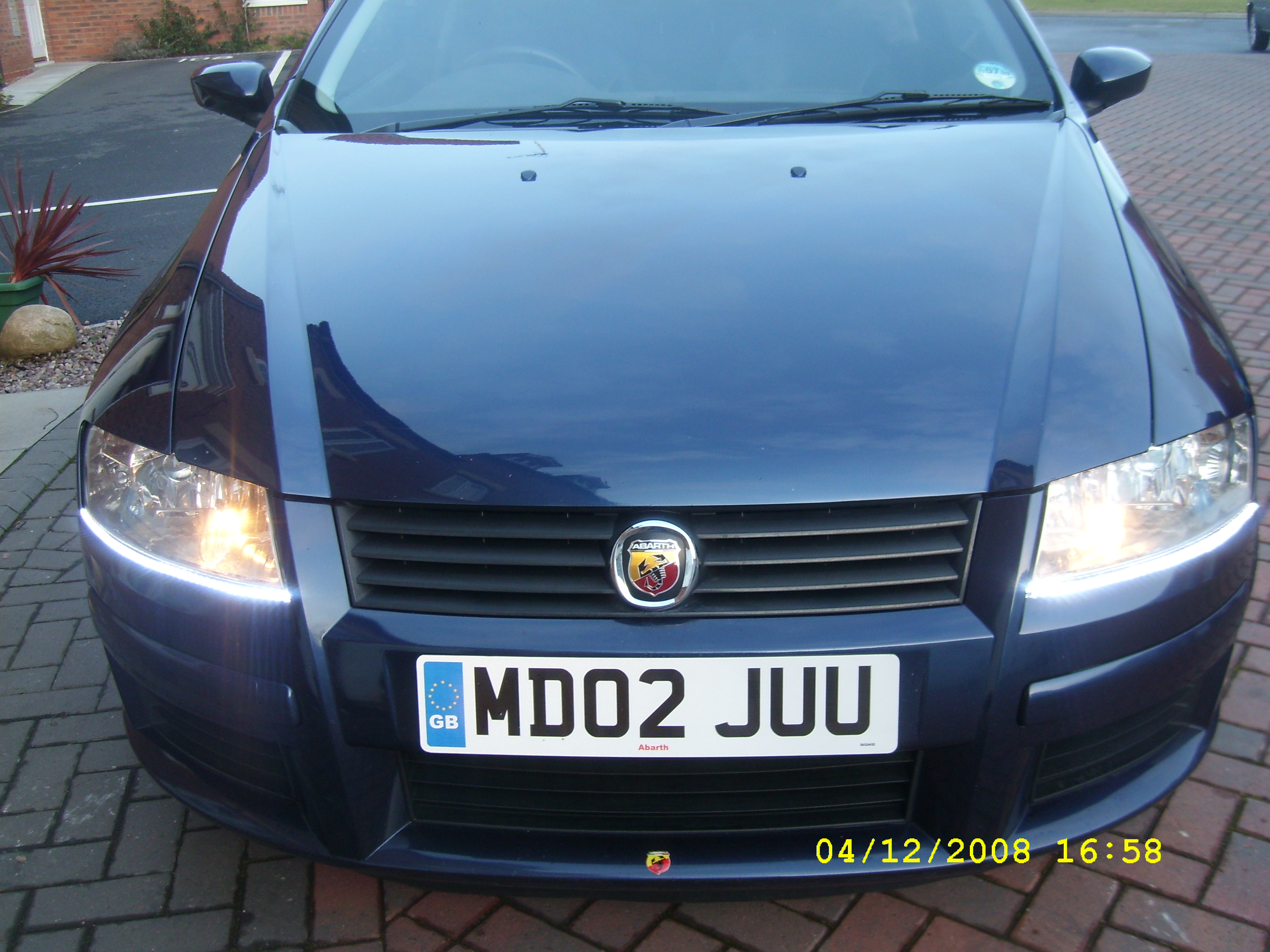

also changed my sidelights for led white led strip lights (however i cant remove the inner most sidelights in the clusters yet)
and finally the new style abarth badges
will post pics as computer starts working :bang:
heres some pics, however cars currently at side of road with a selespeed problem lol

Have you got any details about the strip sidelights? I like them! (y)
i got the sidelights from this seller: http://cgi.ebay.co.uk/48CM-48X-WHIT...photoQQcmdZViewItemQQ_trksidZp1742.m153.l1262
they took about 4-5 days to arrive, iv actually ordered 3 sets from him,
the first i installed on my mrs car (c3 pluriel)
and another set on mer dads nissan xtrail, all the same way, using body gaps between light and bumper.
one set was faulty, (half the led's didnt work) but the seller sent a replacement straight away
Just an update I removed the normal sidelights from cluster so now just neat strip of chrisp ice White LEDs for sidelights that grabs everyones attention.
Also added hid kit 8000k to match the chrisp whiteness, I'll take pic over next few days,
sidenote however is I had to keep 1 wedge bulb plugged in either side to prevent bulb failure warning and prevent the LEDs picking up canbus activity and lighting up slightly when switched off, the wedges are kept in the back of housing with the holes filled up, just a tip for anyone trying anyform of led sidelighting ;)
