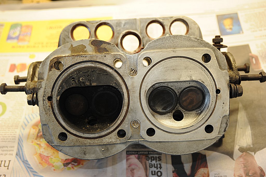

At some time in the past someone has dropped a screw into one of the combustion chambers and left it there. The engine has been run with the screw embedding itself repeatedly in the soft alloy roof of the combustion chamber. After cleaning off a lot of carbon, the imprint is so clear that you can measure the pitch of the thread and the length of the screw.
On the same cylinder, the head is cracked near the exhaust and the exhaust valve on that side badly burnt. Maybe the valve was being held open by a screw fragment and cooked itself whilst the engine backfired repeatedly.

I've attached a couple of photos.

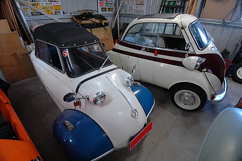

I've attached a couple of photos of my mates microcar collection.
