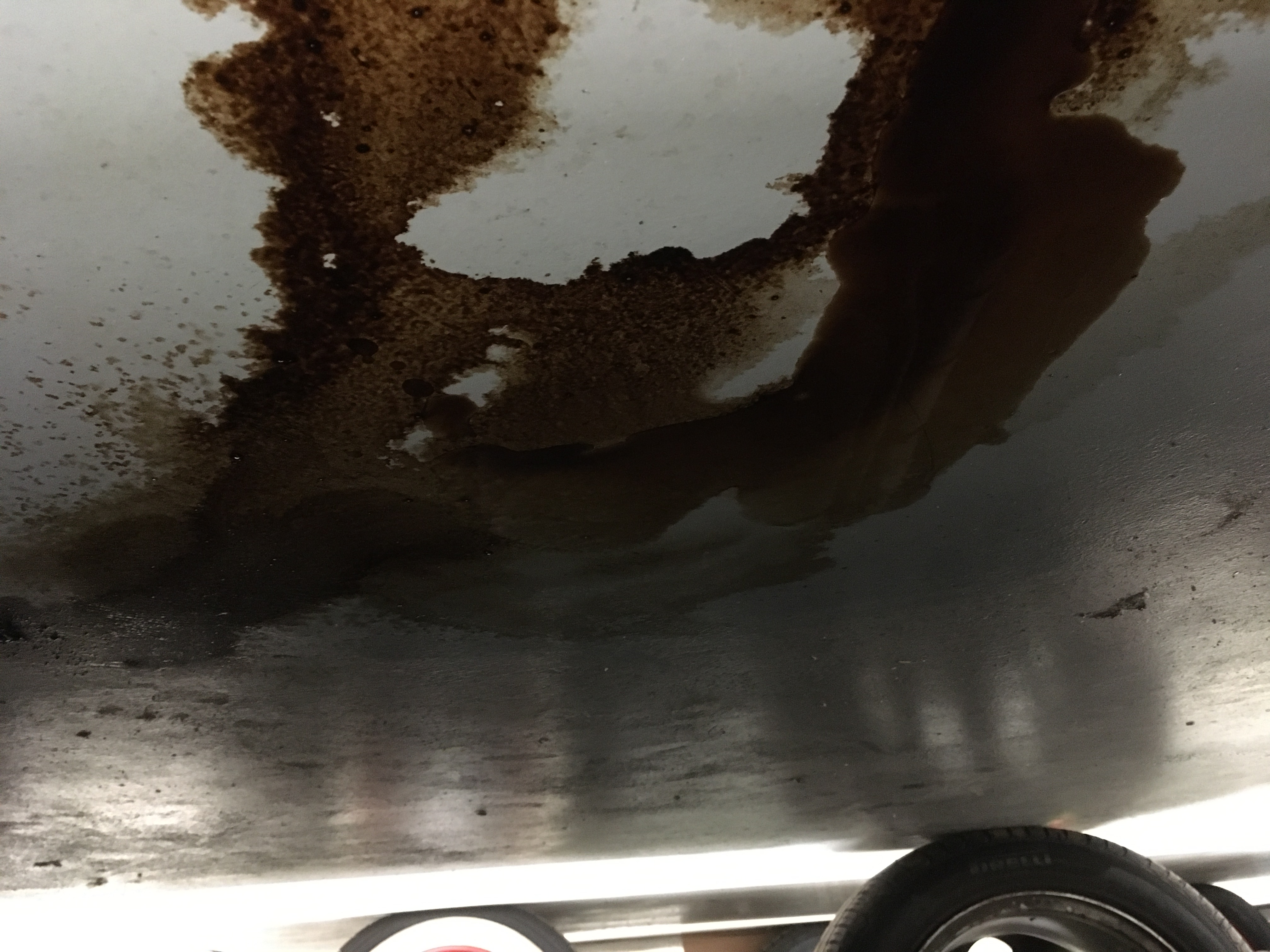

2. A strange spillage - which I cannot work out where it is from.

Hi.
Looks to me it's a stain from a mix of petrol and underseal. As it dries out it will be quite tarry and smell if "bitumen" ???
So a leak of petrol spreading and dissolving the body work underseal and dripping onto the floor. The leak could be from the seals causing the smell or another source.
Best of luck.
Very strange! Can't you see where it's dripping from?
I agree with turining - it's probably petrol dissolving the underseal. Hard to see what else would produce that kind of slick at the rear, unless you've left something to decompose in the boot. :eek:
Thanks both. I think you are pointing me in the right direction. A replacement fuel neck filler has arrived from Henk today. So i will set about replacing this, as the area around the tank is bone dry.

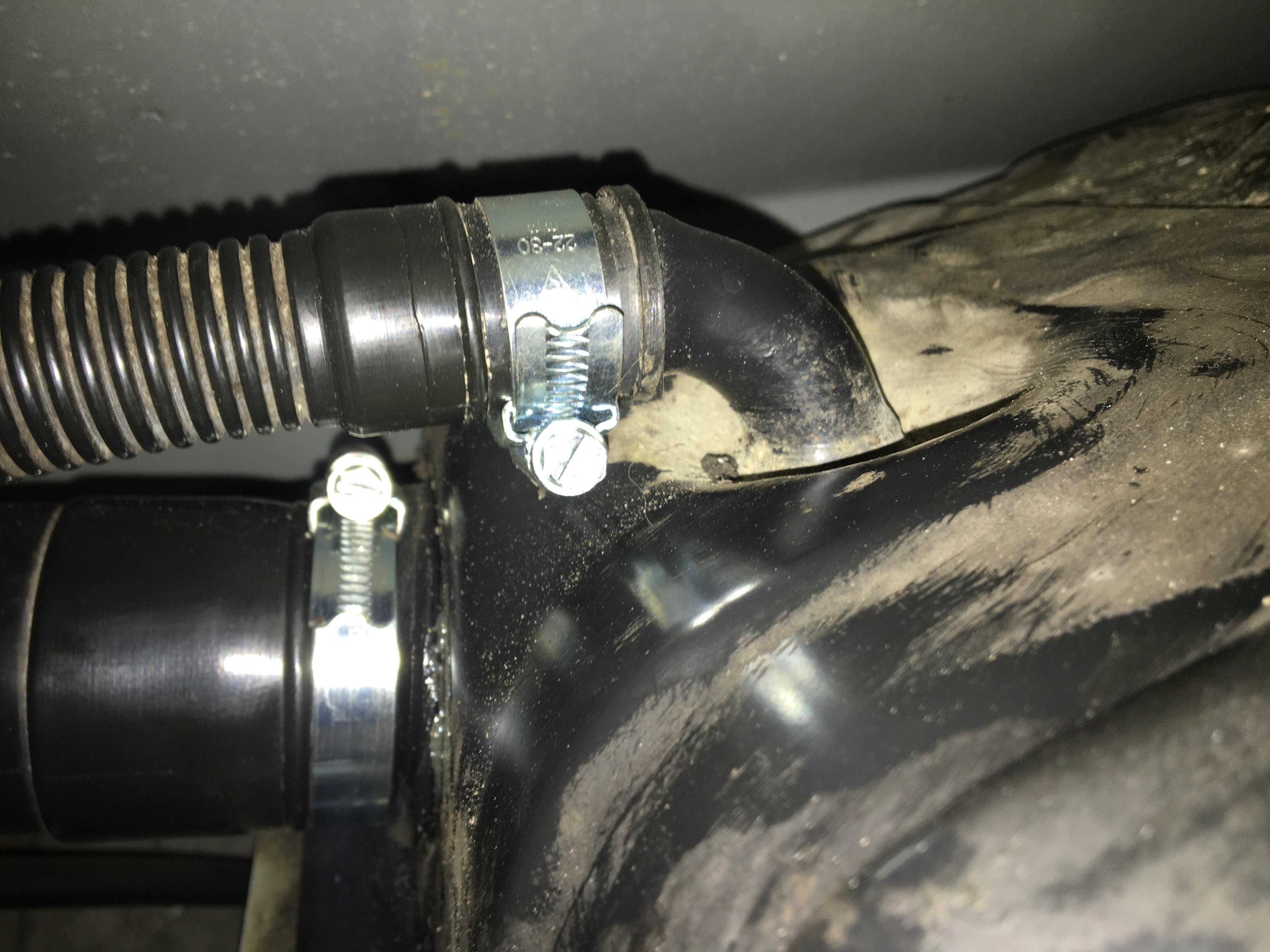

So, finally a solution. Two new jubilee clips, lithium grease around the rubbers, and hey presto problem gone and further more, no smell of petrol, at all!
Who knew that it could be as simple as that - I certainly did not!

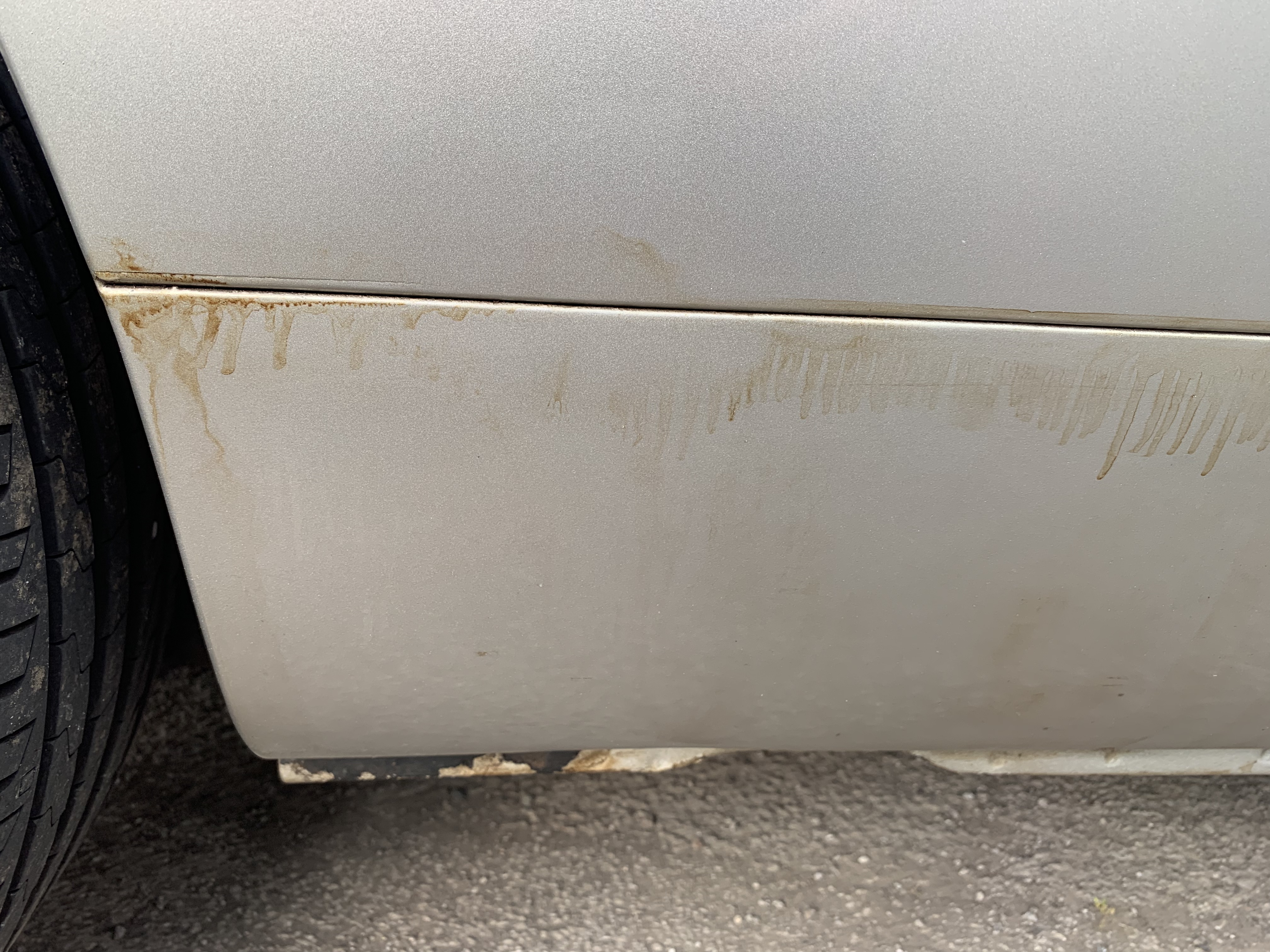

I was just going to post about a very similar issue on the B I’m meant to be delivering to my Dad in the South of France.
Only difference being the leak on this one drips from the rear passenger side just in front of the wheel arch and also stains the lower sill (see photo). How do I access the area you showed with the pipes and the tank?
By removing the bulkhead behind the the seats. I renewed my jubilee clips over 10 years ago. Can't exactly remember the procedure but it wasn't difficult just time consuming! There have been threads about how to do it.
