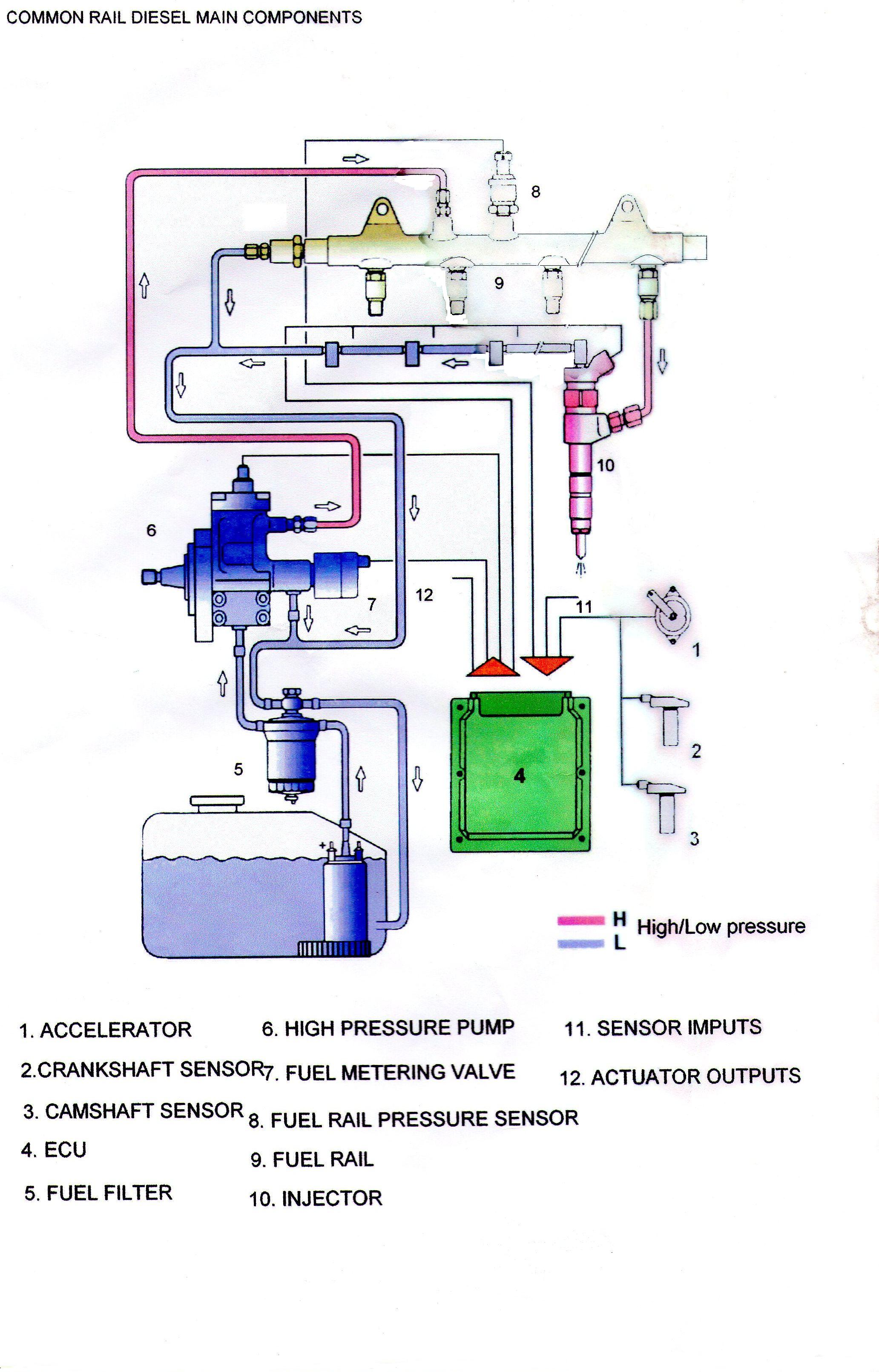

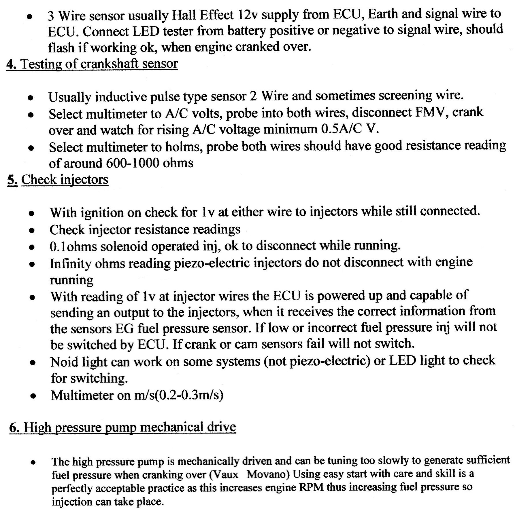

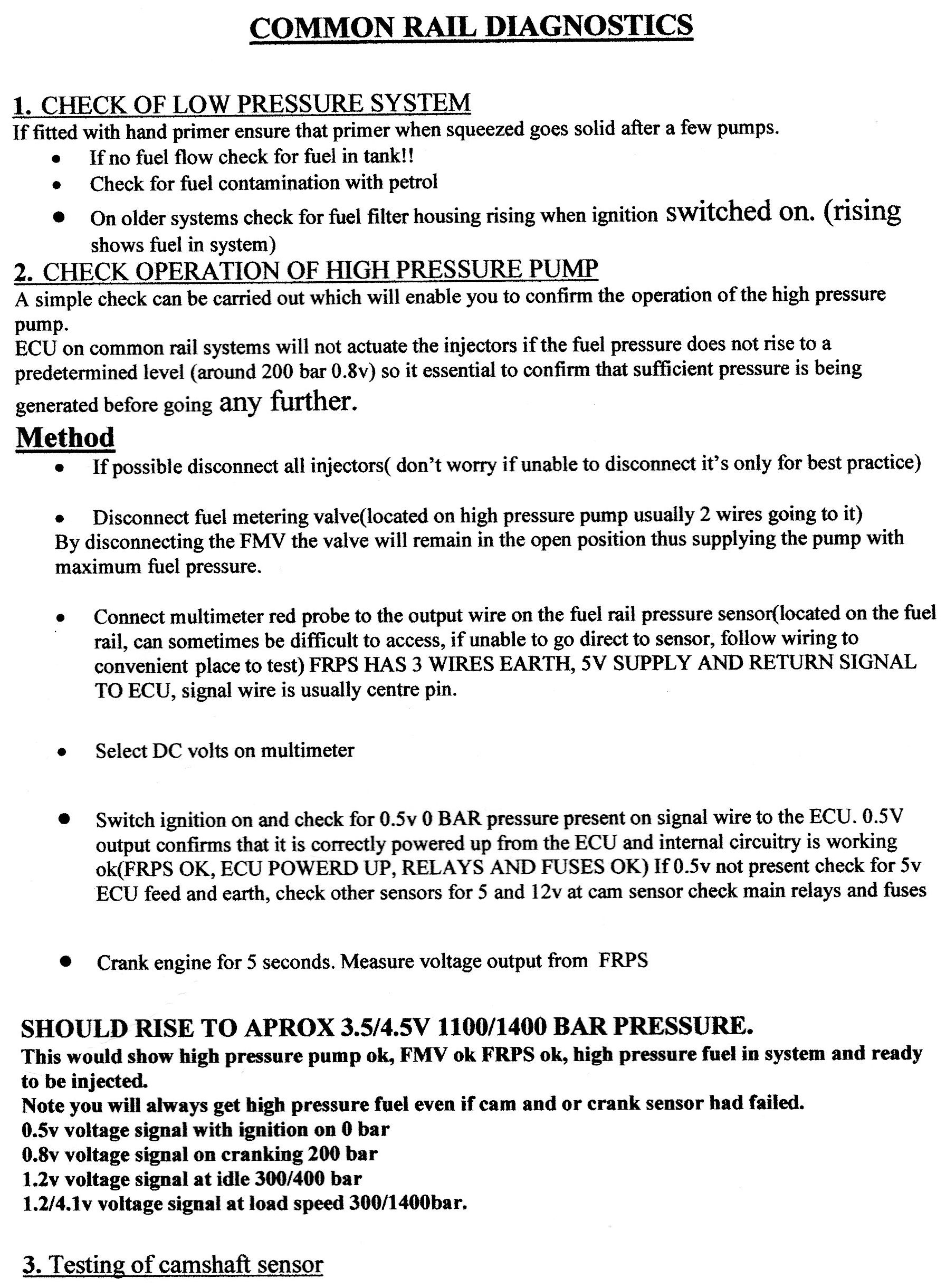

just wondering how old the car is and am i right in thinking its the 1.9 jtd common rail / hdi engine ?
looking at the codes i would go for fuel pump as a starting point as long as the key light is going out with the master key.
undo the air intake a spray a very very very little carb cleaner/ easy start past the pipe (not into it just past it) while cranking and see if it splutters, if so its got a fuel issue (could still be immobilized but its given us a direction.
now to check the fuel pressure of the fuel pump (presuming its a bosh hdi pump) with the multimeter i have attached the test procedure read it a few times before doing it let me know if you get stuck.
