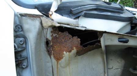

The drivers carpet was damp. I decided to take the wing off to have a look. IMG_0002.JPG
I then dropped a socket into the body so had to remove a bit of carpet to get access to a hole so I could get it out:eek:IMG_0003.JPG
Thats very rare rust for NZ conditions. And a mk2 uno as well...
The stuff in the wheel arch looks the hardest to fix. But it all looks fixable.
I've fixed rust like you have in the floor before. Thats a pretty common place to get rust.
The drivers carpet was damp. I decided to take the wing off to have a look.View attachment 48175

That looks like in-built rust to me - as though the steel was lightly pre-rusted before assembly. It reminds me of a Mk2 door I saw once where the frame had totally disappeared, yet the door skin (hanging free) was completely un-rusted. My guess is that the frame steel was pre-rusted... and similarly in your case the rust seems to run right past other steel without the other steel being affected!

As James says, that rust could be fixed - but yuck, what a job when it goes behind the under-seat crossmember and down to the floor. And, what are the odds of there being rust under the floor as well - jacking points? How about the rear strut turrets?

The rest of the car is sweet. I was talking to Jai about removing the wing and he said that there would be a lot of mastic sealing the wing to the body. Well in this case there was nothing at all. So I think a leak between the wing and the body progressed to the decay behind the wing, the water dripping down to the frame where it sat shielded by carpet, probably for at least 4-5 years. None of it was visible at all from anywhere until I lifted the carpet. I've got a guy who will weld it all up for about $350, and it'll be a good job.

Well it was major. It's all welded and back together. Expensive job.
So anyway, you guessed it, first bit of rain and the carpet was wet again.
And water was running exactly where it used to, but this time on the freashly painted new steel.
A quick check of the forum and up comes 'windscreen leaking'.
Sure enough it was the seal, bottom corner.
As there had already been rust repair on the wing (cosmetic only) before me, It's my guess that the previous owner had driven for years with this leak, getting rust repaired without looking hard enough for the source, and just putting up with a wet carpet, whie the car was being eaten inside out.
To think a $8 tube of bathroom mastic when water was first spotted could have saved all this bother.:bang:
