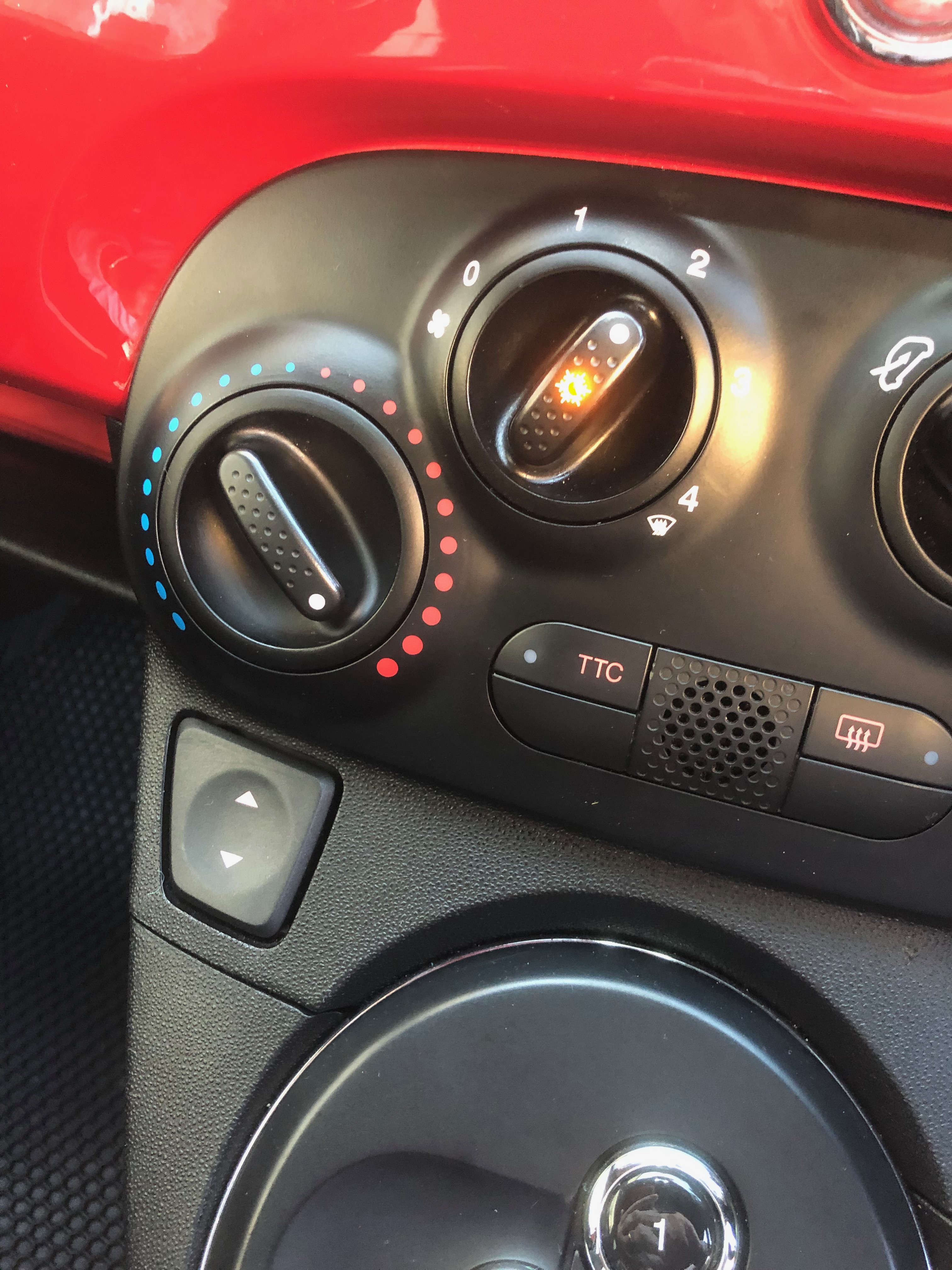

Remove the heater control panel using the earlier guide. I use a plastic trim removal tool but a chisel suitable protected will do the same job. Replace your dim bulbs whilst there. They do make 2.3W versions of that bulb, search ebay for 286X High Wattage Car Dashboard Instrument Panel Bulb 1028 T5 12v 2.3w and you should find them. Remove the fan speed control knob from your fascia, it will pull out if you tilt it at the same time as pulling. Tip: use a silicon mat ( often sold as a non slip mat for mobile phones on dshboards ) to grip the knob without doing any damage. I have a pillar drill but I am sure you could do the same with a hand held one if you are careful. I used a 2.5mm drill to drill out the centre of the aircon symbol so the light shines a lot brighter.Then as the God ( ? ) Haynes says, assembly is the reverse of disassembly. Enjoy
