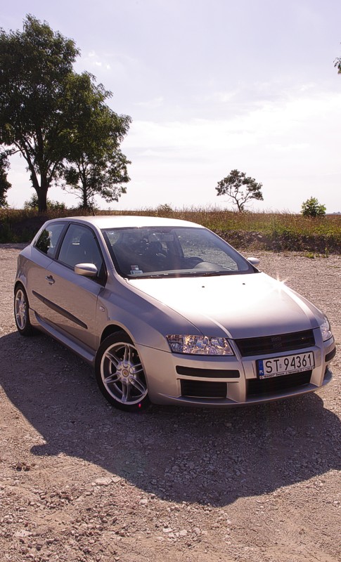

Hi i want to present you my car
I bought it 2years ago and i think it will stay with me a little more time. Now it has 162 000 km on the clock (10 000 after mods).
The description is translated from Polish so sorry for possible mistakes as I dont know the english names for some car parts
Ok, so lets go!
Fiat Stilo 1.9 JTD (192_XE1A), year 2002

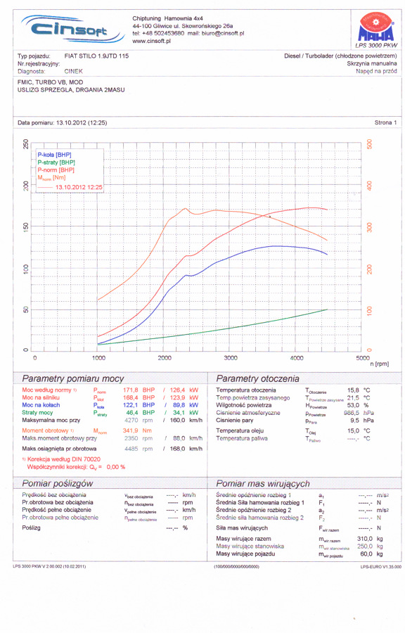

Stock power: 115ps/255nm @ 4000/2000rpm
After some mods: 172ps/340nm @ 4275/2400rpm (only 172ps because of slipping clutch and dual-mass wheel starts vibrating, after changing it i will offcourse do a soft correction. Finally i want to reach ~185ps / 380nm completly fail-safe)

Engine mods:
- FMIC
- Custom turbo manifold
- New Garrett turbo from Multijet engine GT1749VB
- 2bar Bosch Mapsensor
- end CAT out
- Removed EGR and soft disabled
- Fresh injectors (80 000km) (mine unfortunately were in poor condition)
- REMAP
