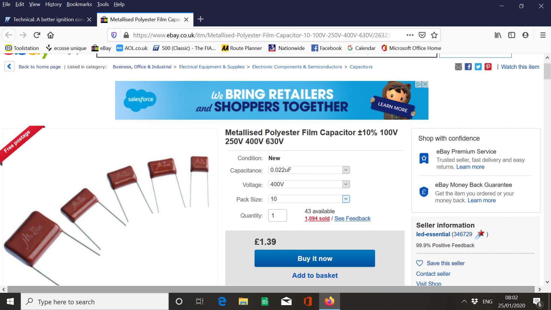

I was hoping some of the members here who have considerable knowledge of electronics would notice this thread and respond with their opinions on using this capacitor to replace a traditional ignition condenser/capacitor.
...perhaps someone can give an opinion....?
Your image in post #4 matches the appearance of the 'polyester film' type capacitor that was shown in the article in Practical Classics magazine and that I was attempting to describe.
