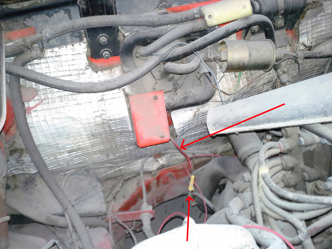

#1 this thick red wire coming out of the harness in the firewall there, is this wire the starter motor signal wire? (I also have some loose wires I believe are coming from the starter solenoid on the starter motor)

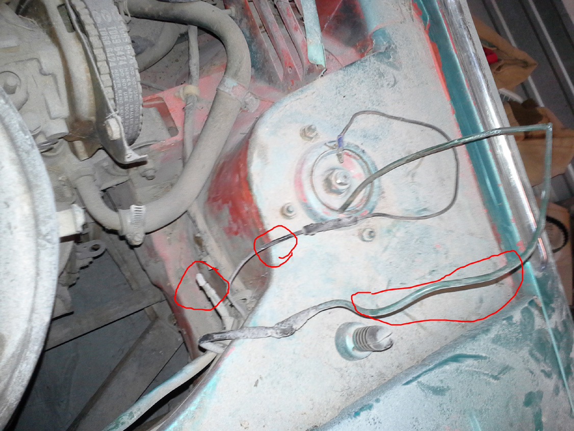

#2 three loose wires hanging near the water pump/alternator area. I imagine one may be a coolant temp sensor wire, is the thicker teal green wire supposed to go to the alternator + output?

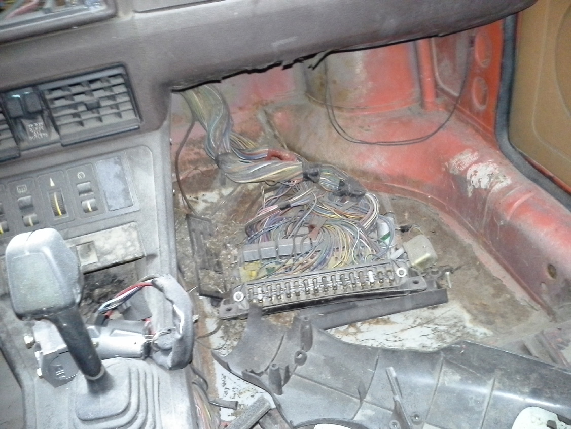

#3 you can see the fuse panel hanging..

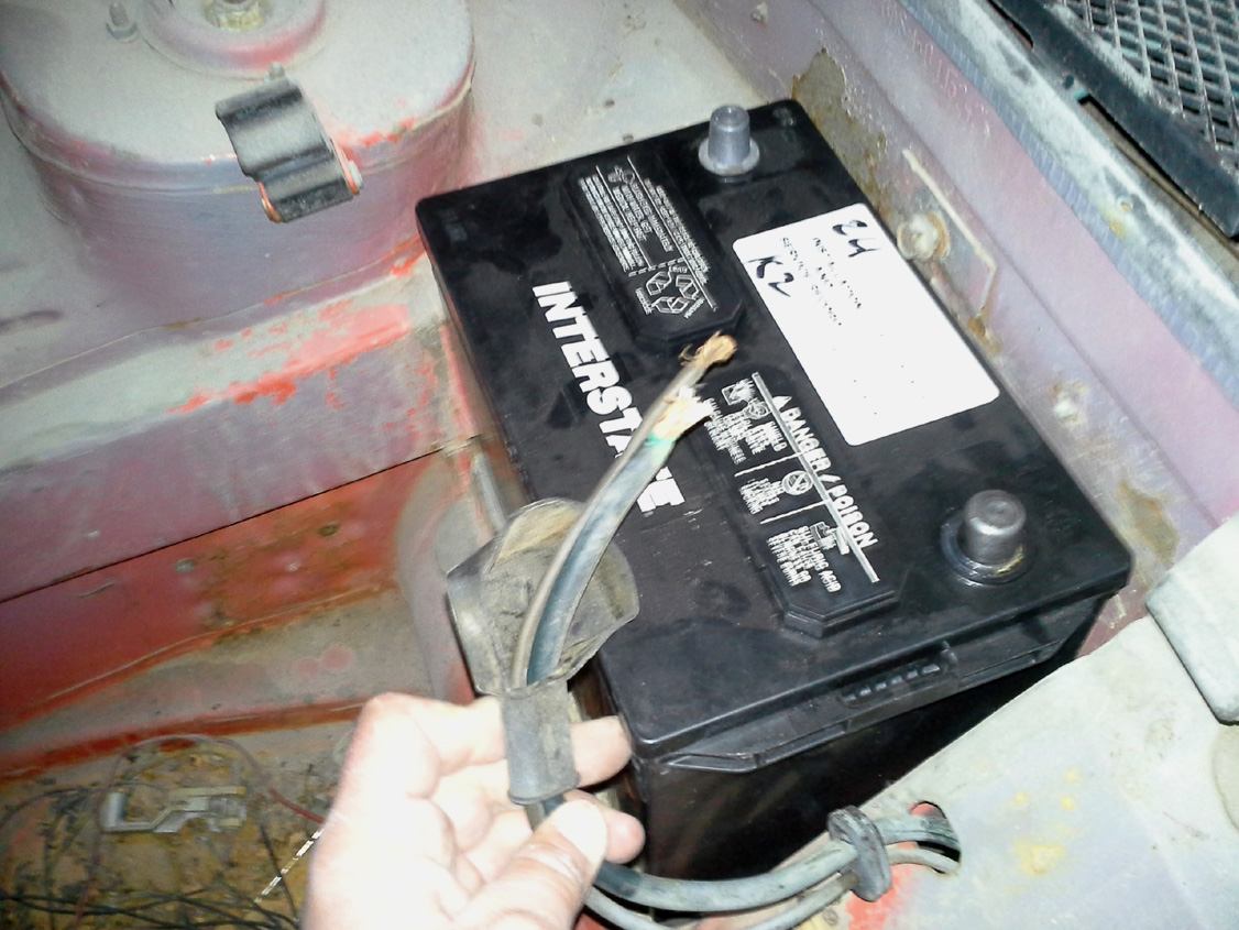

#4 The battery. There are these two large teal green wires coming through the body in the picture, I assume these both go to battery +? And where is the Battery Negative lead supposed to connect? Should I just fashion a new battery negative cable mounted to a large bolt into the steel body, like the location directly above the center of the battery?

I think the red wire in pic 1 is for the card cooling fan,but i am not 100 per cent
You can use the bolt just above the battery in pic 4
The main live runs through the tunnel of the car and comes out somewhere hear the starter
Not sure but it could be the oil pressure switch terminal in in pic 2

Yep, hooked up battery with negative lead to body & new terminal on the + leads.
2nd try on what I wired to the starter solenoid signal wire, and I got the right wire, motor cranked right over!
