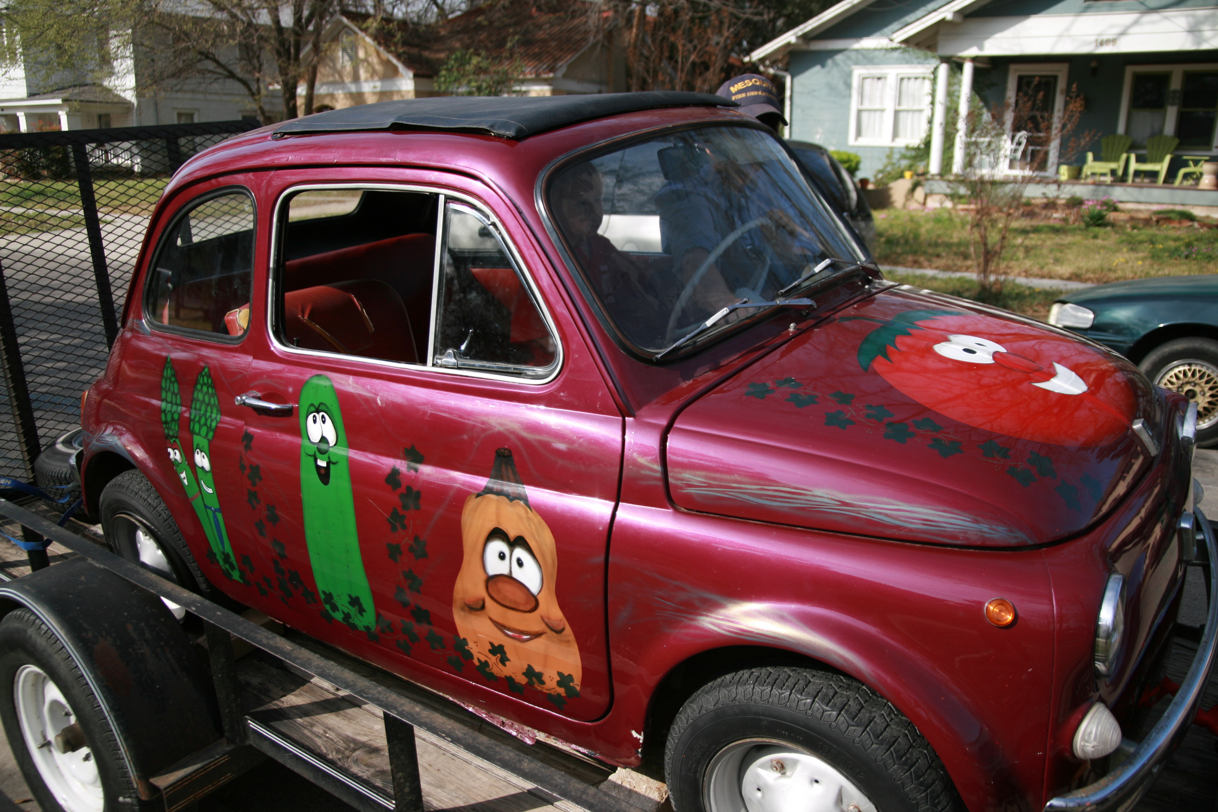

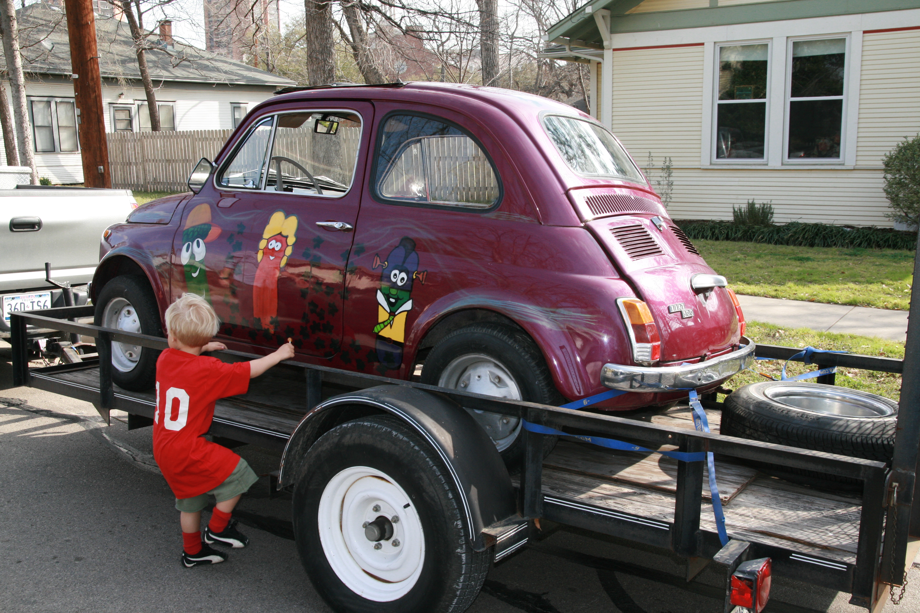

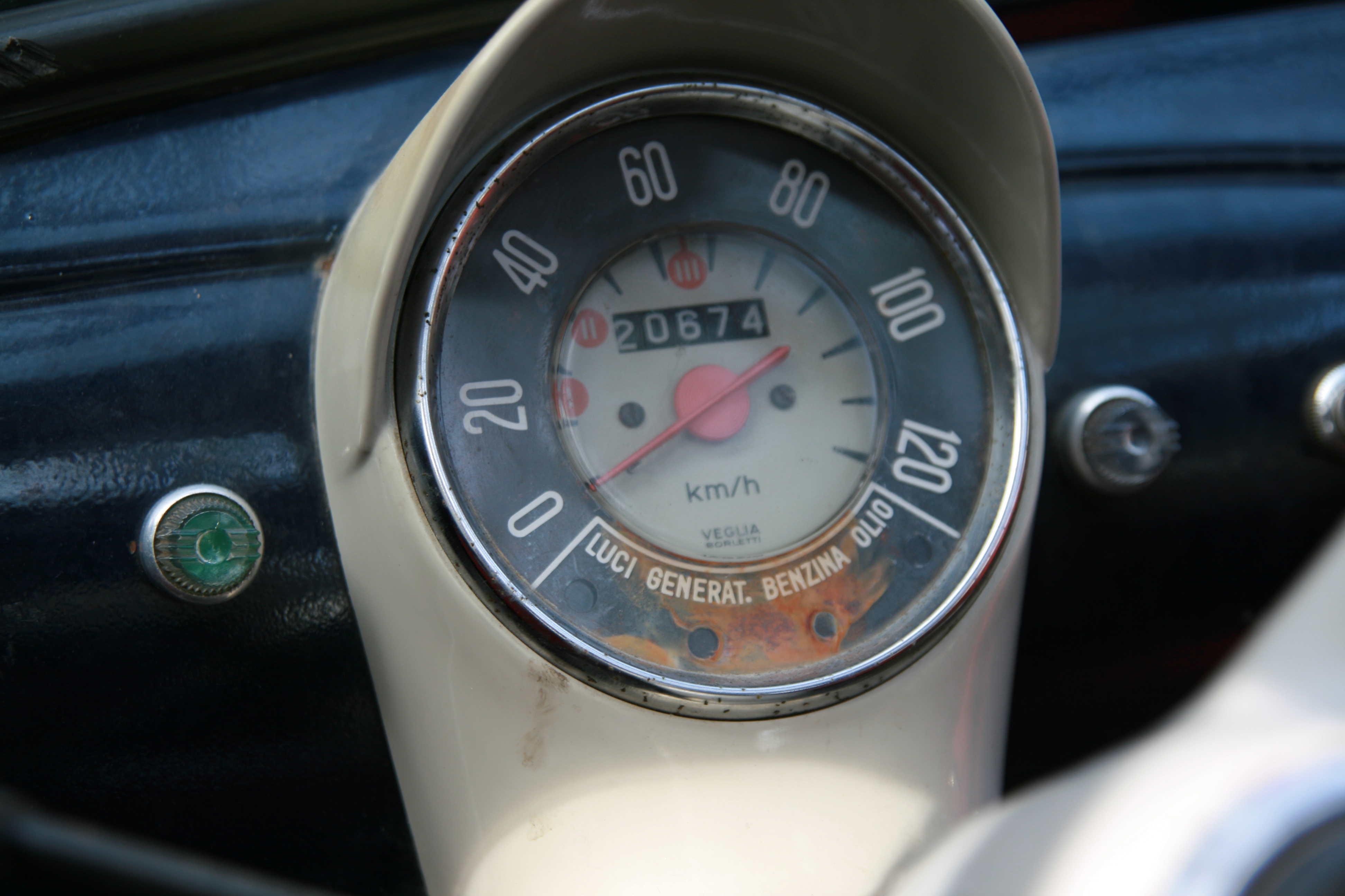

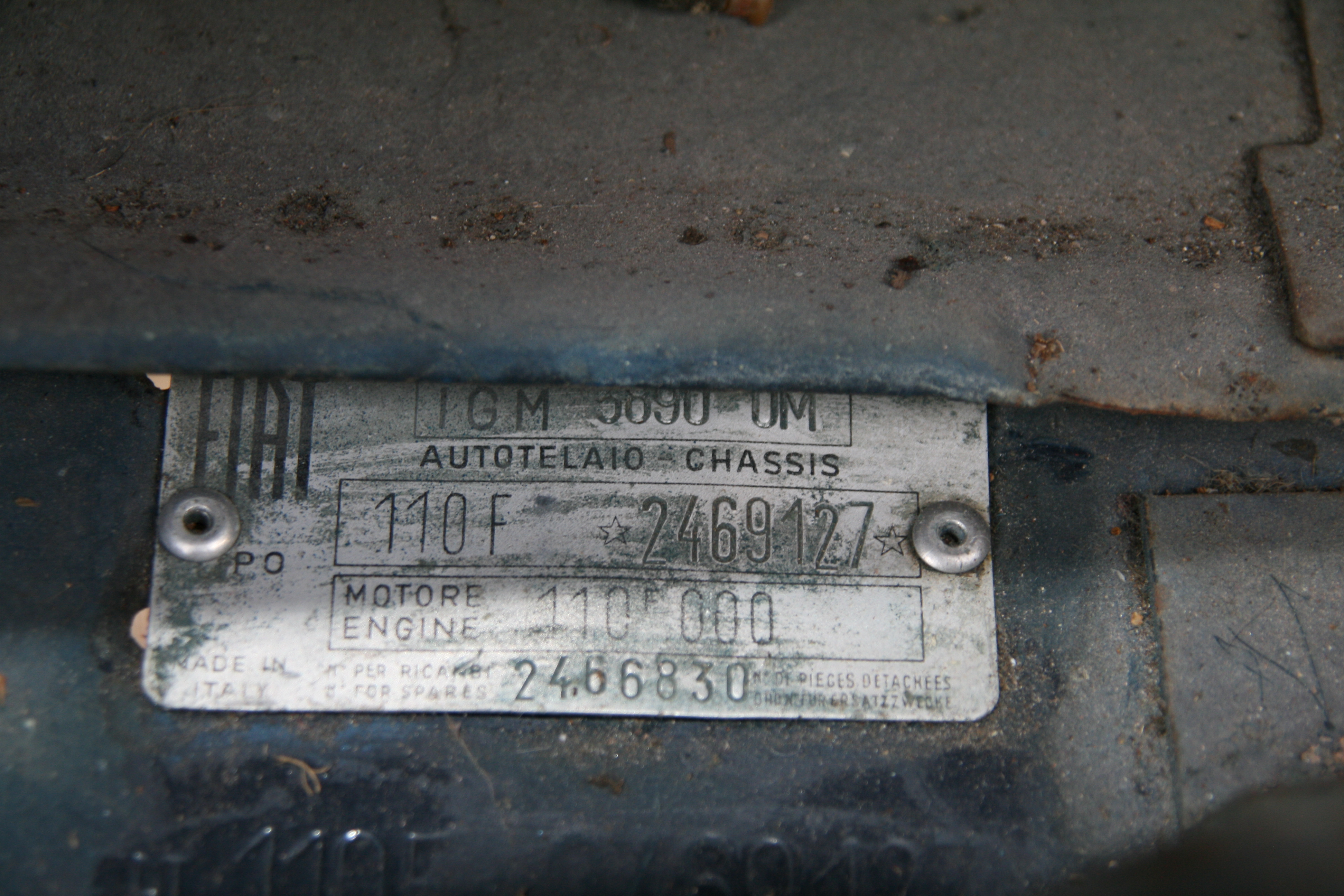

Ok, here it is!!
the amazing thing is, with a new battery and a little fuel directly into the engine, it fired right up!! Apparently the previous owner bought it awhile back, took it to get tuned up and running, then parked it in the store for 11 years. the spark plug, oil, distributer all looked brand new! I took off the fuel tank, cleaned it out, and replaced the fuel filter. Somewhere in the fuel system i am losing gas, possible clogged fuel line or bad fuel pump. once the weather clears I will get back out there and trouble shoot it. It will require some body work and a new floor, but everybody I knew is real excited to lend their talents in helping me get it up and going. You can imagine the looks and conversations I've had just trailering it around town!

Great little car you have there! Looks in good condition, good luck with the restoral project!!
That will get some looks from the public eye once its complete!
