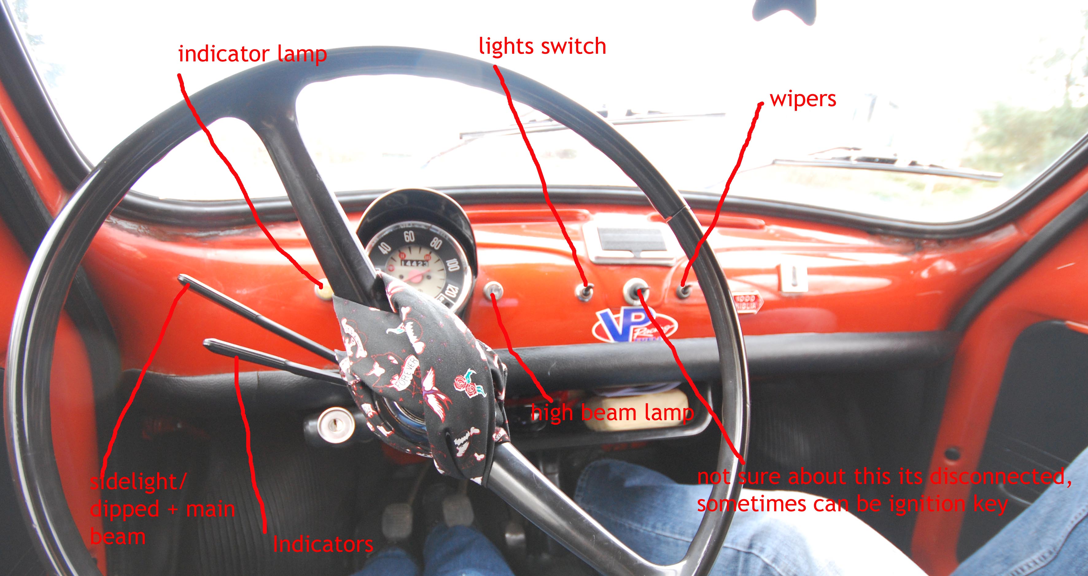

Okay, this may help, i'm not sure if your layout is the same, this is in a 500R.
Not entirely sure what the middle switch does or was, on some cars its where you put the ignition key, but its not on mine as it now has a barrel type ignition with steering lock. Dont forget to click the thankyou button if you found this helpfull !!!!(y)

Hi Thanks for the quick update I also have the ignition key hole in the middle but on either side 2 orange lights for the signal, is this correct or should there be 2 switches on either side?

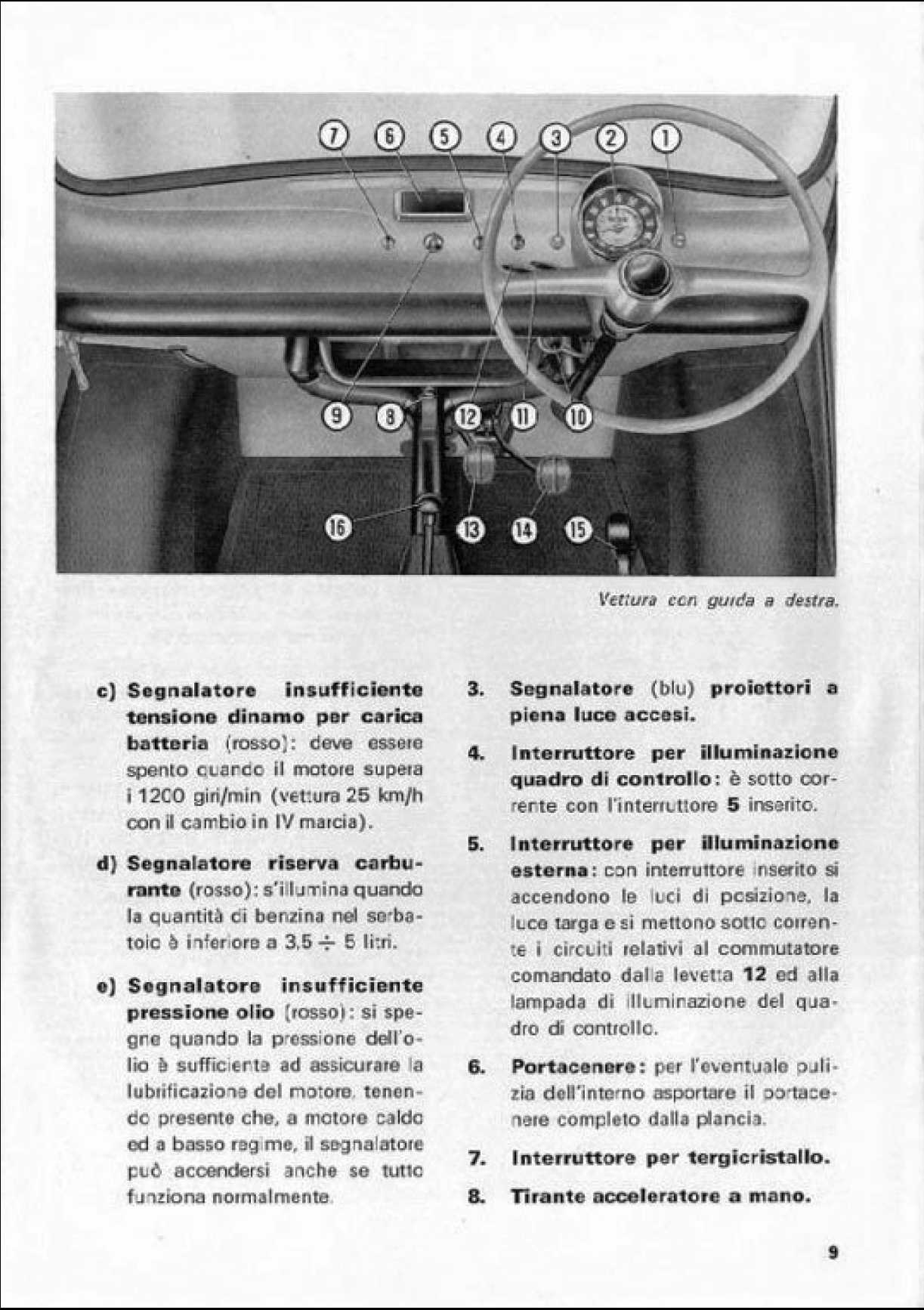

Got these pages from the 500L Owners Handbook. They may give you a clue.
1 = Direction Indicator Warning Lamp.
3 = Main Beam Warning Lamp.
4 = Side Lights Switch
5 = Head Light Switch
7 = Wiper Switch

Our car is an "L" and has three switches plus the ignition switch.
The three switches are for the wipers, lights and panel lights.
As far as I can recall on the "D", there were three indicator lights, one which showed the indicators were working (yellow?) one which showed the lights were on (green?) and a high headlamp beam indicator (blue I think)
