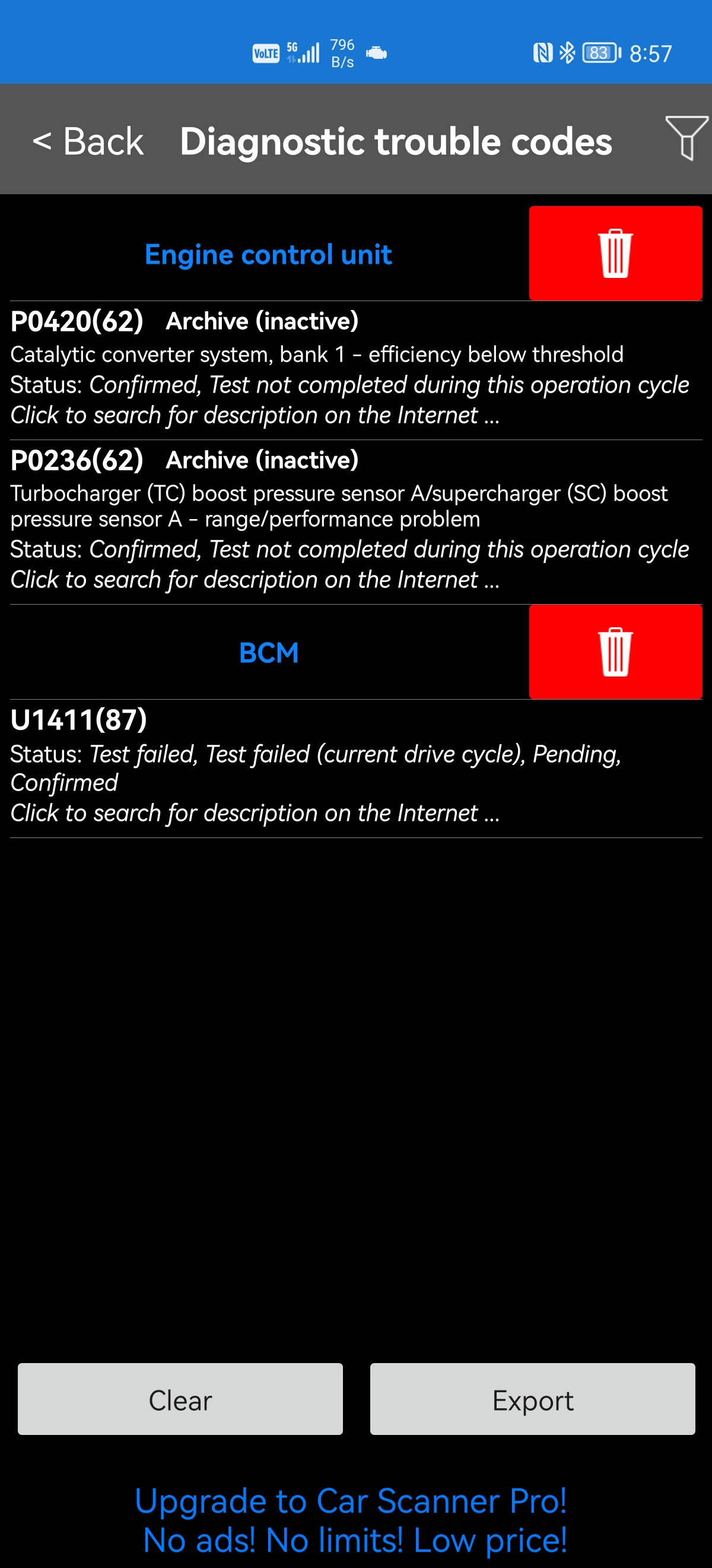

I have the same car and I had the same issue from time to time, the car was entering limp mode and did not accelerate.
Also no warning indications.
So I connected an obd reader and I got the P0236 error.
After a research I found out there was probably a problem with the boost pressure sensor.

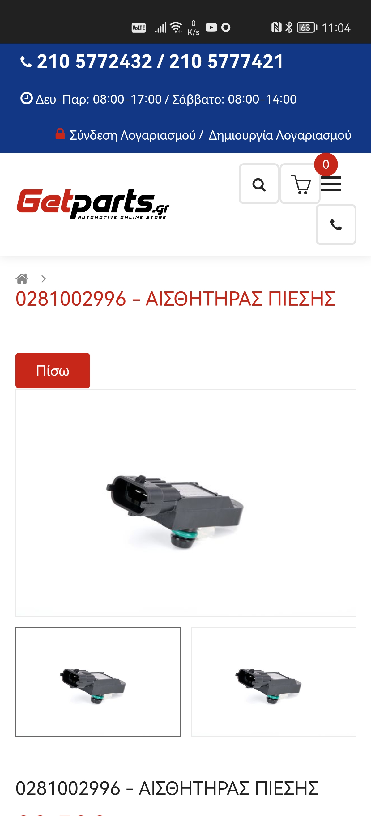

It's a Bosch part with code number 0281002996.
I bought it 30 euros from any eshop easy to find it.
Also very easy to replace it only one torx screw.
So I did it and so far not happened again the last 2 months.
I will give you feedback for any news on it.
