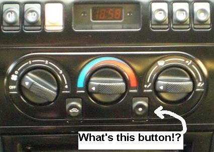

Is this only on air-con models? My trouble is I'm not sure if I HAVE air-con, car didn't come with a manual and I haven't noticed the button to the right of the 'air circulate' button doing anything (it's just got a dot on it?).
No, that's just a spare button. If it had aircon it would have a little snowflake symbol on it. Hope that helps.
