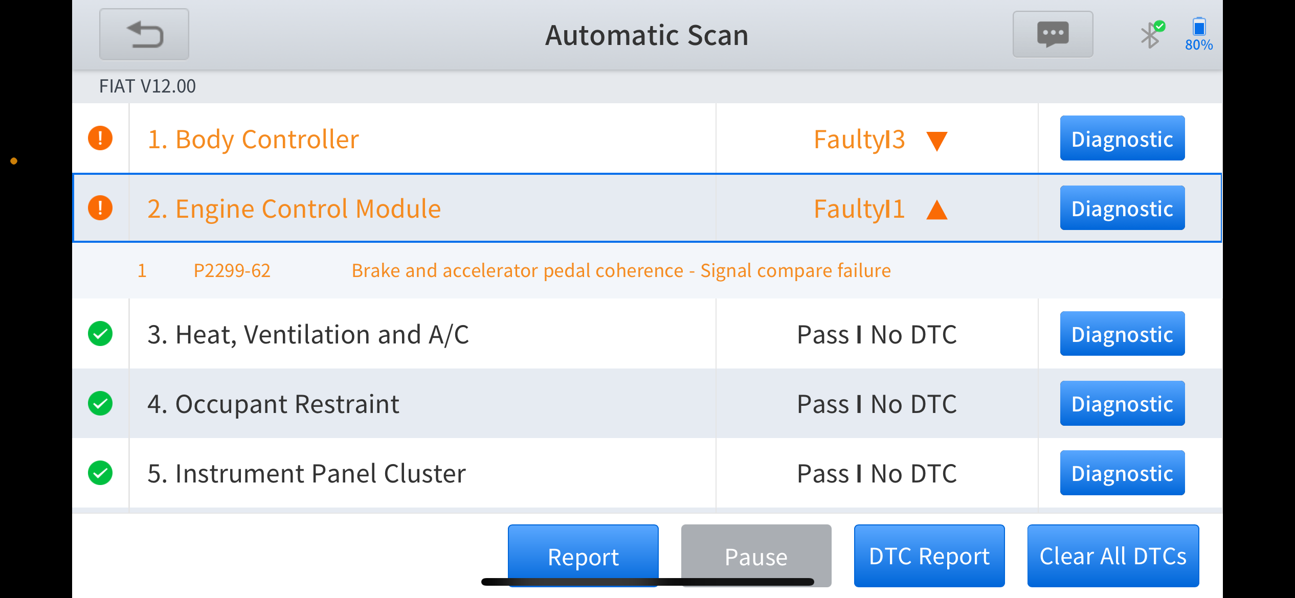

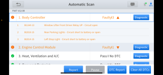

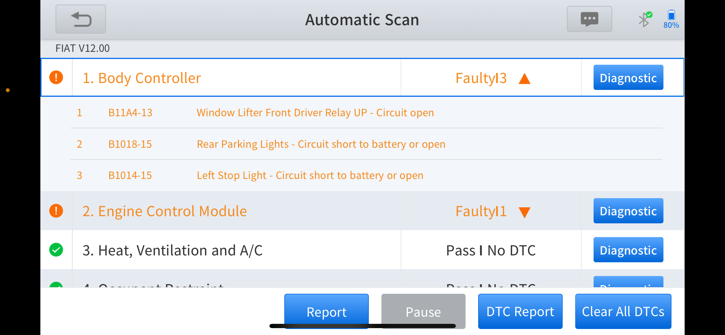

I bought the car on auction and they didn’t mention the problem :/. The fault code won’t get clearared after testing with my Xtool A30M.
Brake light is working, i’ll try to recalibrate the acccelerator pedal tonight hope it’ll help :/.
What else should I do please?

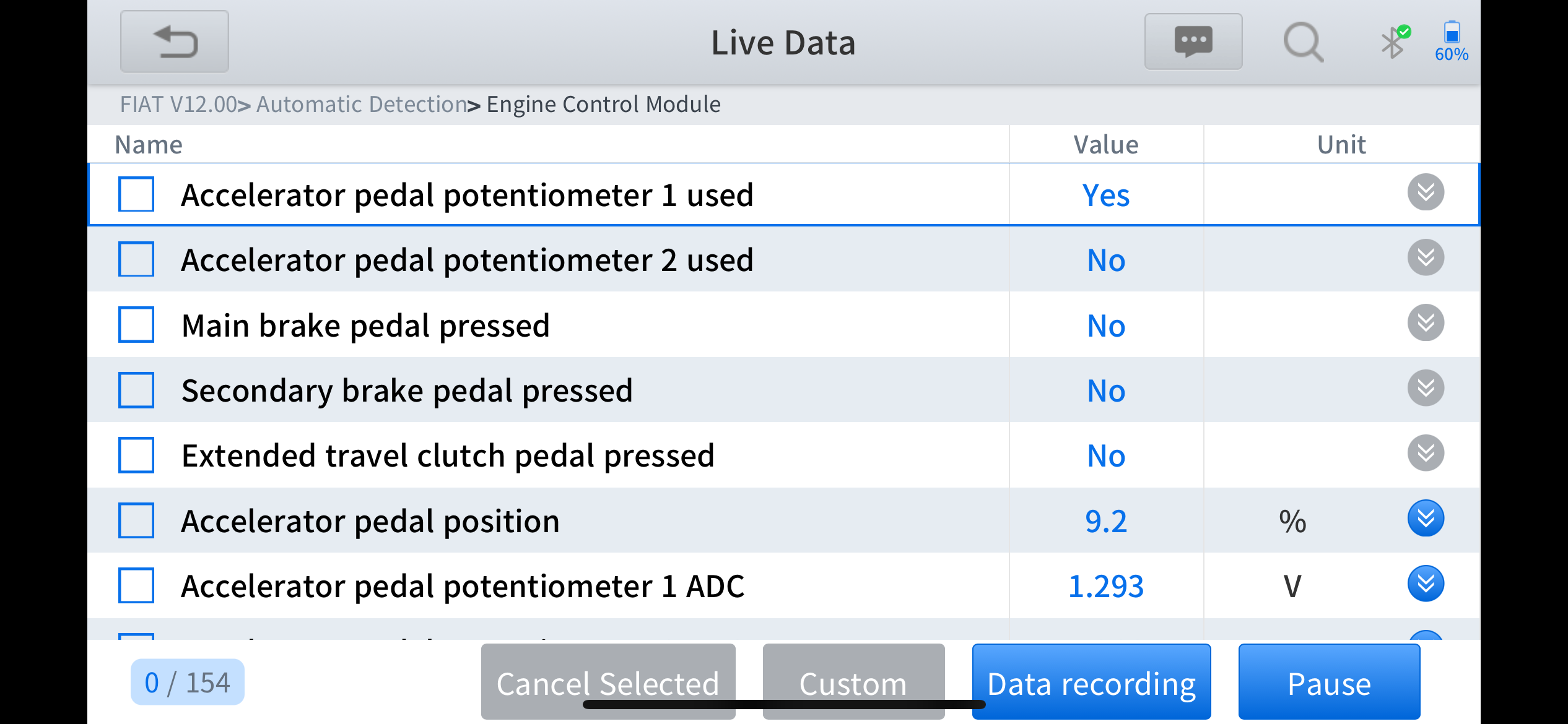

I haven't used the A30M, but it looks like it has a live data option. Can you use this to see the pedal status?
For the Body Computer faults you should also be able to use it to see the signals that cause the light and window lifter faults.
If the A30M doesn't show the live data and you're going to keep this Fiat vehicle I would invest in Multiecuscan and the ELM327.

Accelerator pedal sensor is working. After reading the car my OBD didn’t give any errors but the car was still showing the triangle :/
I've only looked at the data from a Ducato, but this looks similar. You should see the two brake pedal values change when the pedal is pressed slightly, and you should see the two Accelerator pedal potentiometer voltages (only one shown in the image) change when the pedal is pressed. If they all look consistent then the original 'coherency signal compare failure' should be cleared. The throttle should show 0% (1.0v and 0.5v) when it is not pressed.
If there are other faults (e.g. from the Body Computer) they could be causing the dashboard light.
