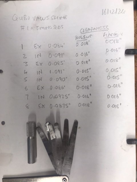

Hi BugsyMike and Zardo
Thanks guys for your input.
I've now checked mine with the newly assembled head on the bench. Inlets are between 0.015" and 0.016", and the exhausts are all a generous 0.018". Both show a little over spec, but I think they will tighten up a smidgeon when the head is torqued down. It defies logic why they do this as the head bolt platforms are well below the tappet block, but this has been my experience with other engines.
The clearances are the same whether measured opposite the cam nose or on the flank.
I think this is pretty good for 60,000 Miles with them not, as far as I know, having been adjusted from new. It is common to see some closing up over time from valve / seat recession (particularly on the inlets) with direct acting bucket tappets. Noticed the valve seats are less than the usual 45 degrees (possibly 30) which will be less prone to recession.
Delighted that I don't have to try to source new shims over the Christmas period, so can go for re-assembly over a mince pie or two.
Thanks again for all your help and best wishes to all for Christmas and the New Year.
QuboPete
QuboPete
Yes, better a little wide than a little tight. They used to say with the 1960s Jags if you couldn't hear the tappets it was bad sign.
It may be after grinding in, that once run for a little while they seat in better on the contact area.
I recall one of the earlier ones I did was after rebuilding a V8 Triumph Stag and having to root through the local Rover Triumph Dealers stores to get all the right shims with my micrometer. Most of my earlier years were on push rod Fords so easier.
I used to hate grinding in loads of valves until I bought a S/H Sykes Pickavant valve seat and valve face cutting sets, so after cutting the seats to the correct angle then it was a quick job to lap them in.:)
Re the opposite the cam nose or flank, I was shown by my lecturer the "on the rock on No4 Cyl, do both valves on No.1Cyl." method (similar process on 6 and 8 cyl etc) at the same time as much quicker and when I checked using the other method they were always spot on.
I used that method on a Tickford 2.8 Ford Capri and the previous owner, a garage proprietor who was friends with my customer watching and saying "Oh! You will have do adjust them several times to get them quiet". He shut up when I started it and it ran perfectly and quiet:) I also fitted German Mahle pistons to it which cured the previous owners problem of burning holes in pistons as 5 Star petrol was no longer available, so 150 psi instead of 180psi compressions so no "pinking/detonation" when on full boost from the turbo, my customer was well pleased.

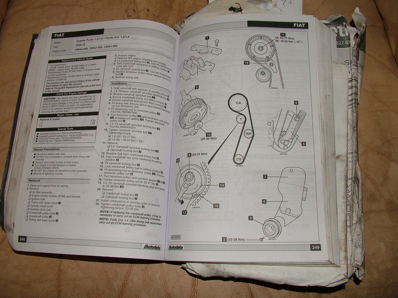

This is the timing belt fitting details I have for that engine in an earlier model than your Qubo and I note at the bottom of page it mentions it may be necessary to carry out an ECM learning procedure.:(
Hi BugsyMike
Many thanks - that's brilliant! - your book refers to the same engine code as my Qubo, and the diagrams look just the same as my engine looks. The step by step instructions in the book are of exemplary clarity.
The cam locking tool I made held the cam with the slot level with the cam box joint face, then I just made and fitted a ring gear lock with the cam lock in place. If the cam pulley had stayed put relative to the cam (as it did when I did the cambelt about 2,000 Miles ago) it should have worked and I'd be home and dry now. Frankly, I didn't even realise it was VVT until it was too late and I had the cam out. I suppose the hefty look of the pulley and the solenoid on the cam cover should have given me a clue, but the penny only dropped finally when I saw the two oil grooves in the timing side cam bearing journal and drillings going off towards the pulley.
