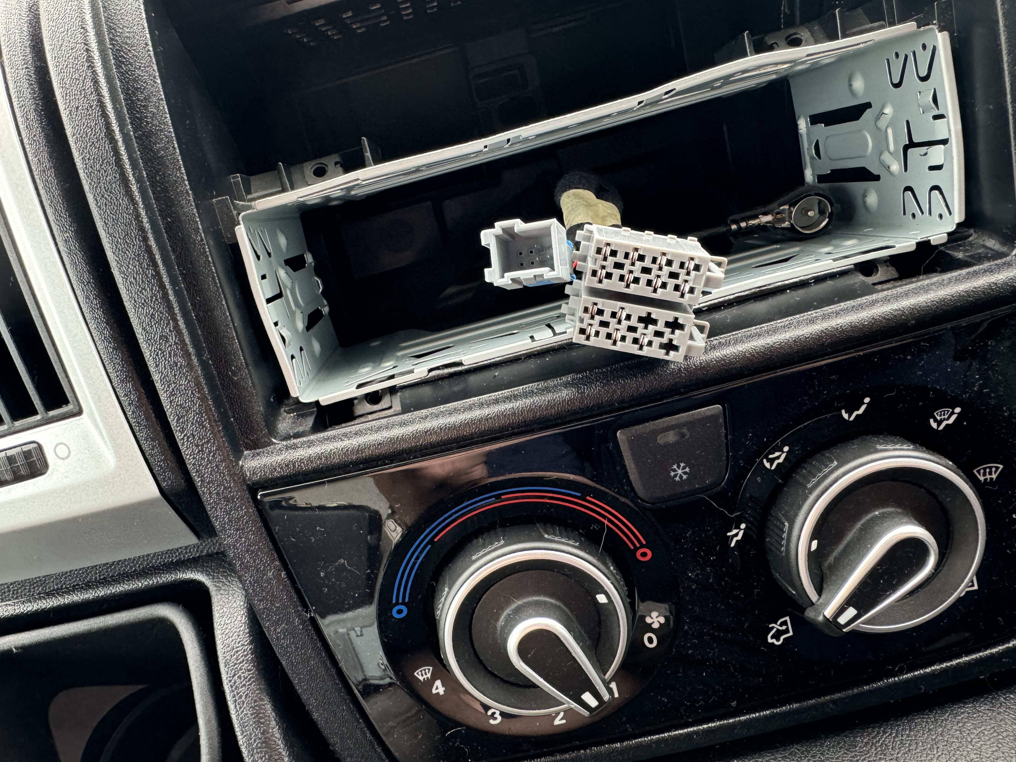

I have a 2018 motorhome and have the stereo adapter in the picture. Can anyone identify the stereo it actually fits as the Fiat one I brought for a 2018 Ducato doest’t.
The picture you show looks like a (two-part) standard ISO connection.
It looks as though your Ducato is one that came from the factory without a factory-fit radio (which would have had a Fiat-specific connector) but with radio-prep (no radio, but speakers and preparation for an aftermarket radio with ISO connectors - it's a fairly common option and the radio may have been fitted by the converter if it's, say a motorhome).
I'm interpreting that you're trying to fit a Fiat "factory" radio?
Yes I am wanting to fit a fiat Bluetooth radio into the space. Is there a connector I can buy or is it a re-wire job?
You can certainly buy adapters for the reverse of what you're wishing to do (Fiat to ISO), but I'm not sure about reverting the ISO to a Fiat connector.
I suspect you might end up with Canbus issues anyway fitting a Fiat radio into a vehicle that isn't prepared for it. (Certainly earlier bluetooth radios were Canbus "aware")
