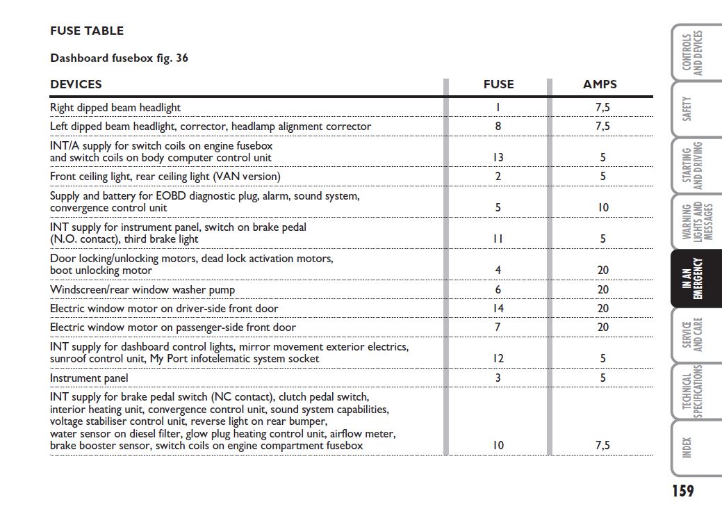

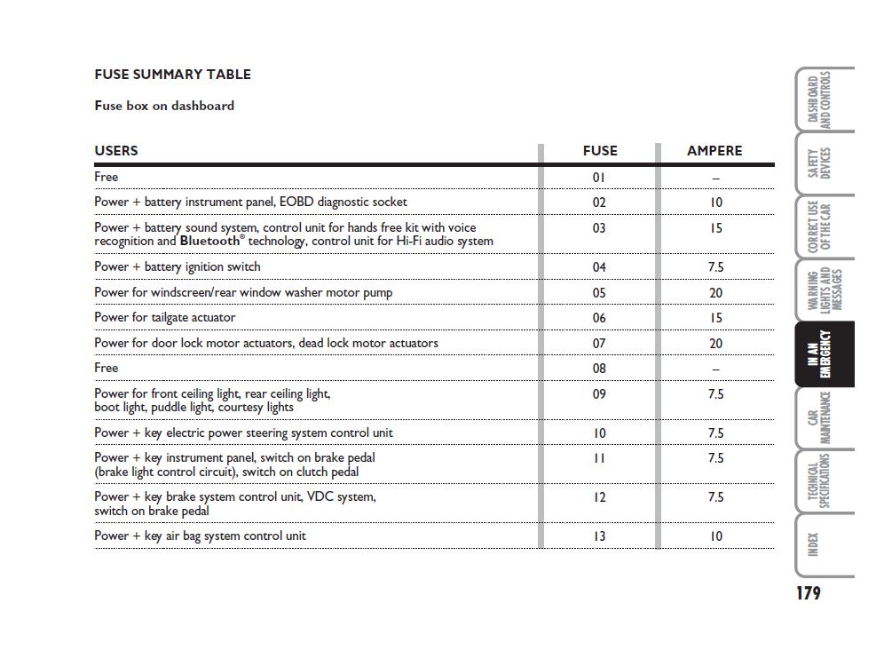

I have looked at two Owner Handbooks from around 2009 and they show two different fuse layouts so if you've got the handbook that came with your car it's probably best to consult that (the 'In an Emergency' chapter). I've attached the pages I found below. In both cases it is a 20A fuse and will be in either position 5 or 6.
Earlier models:
Later models:
