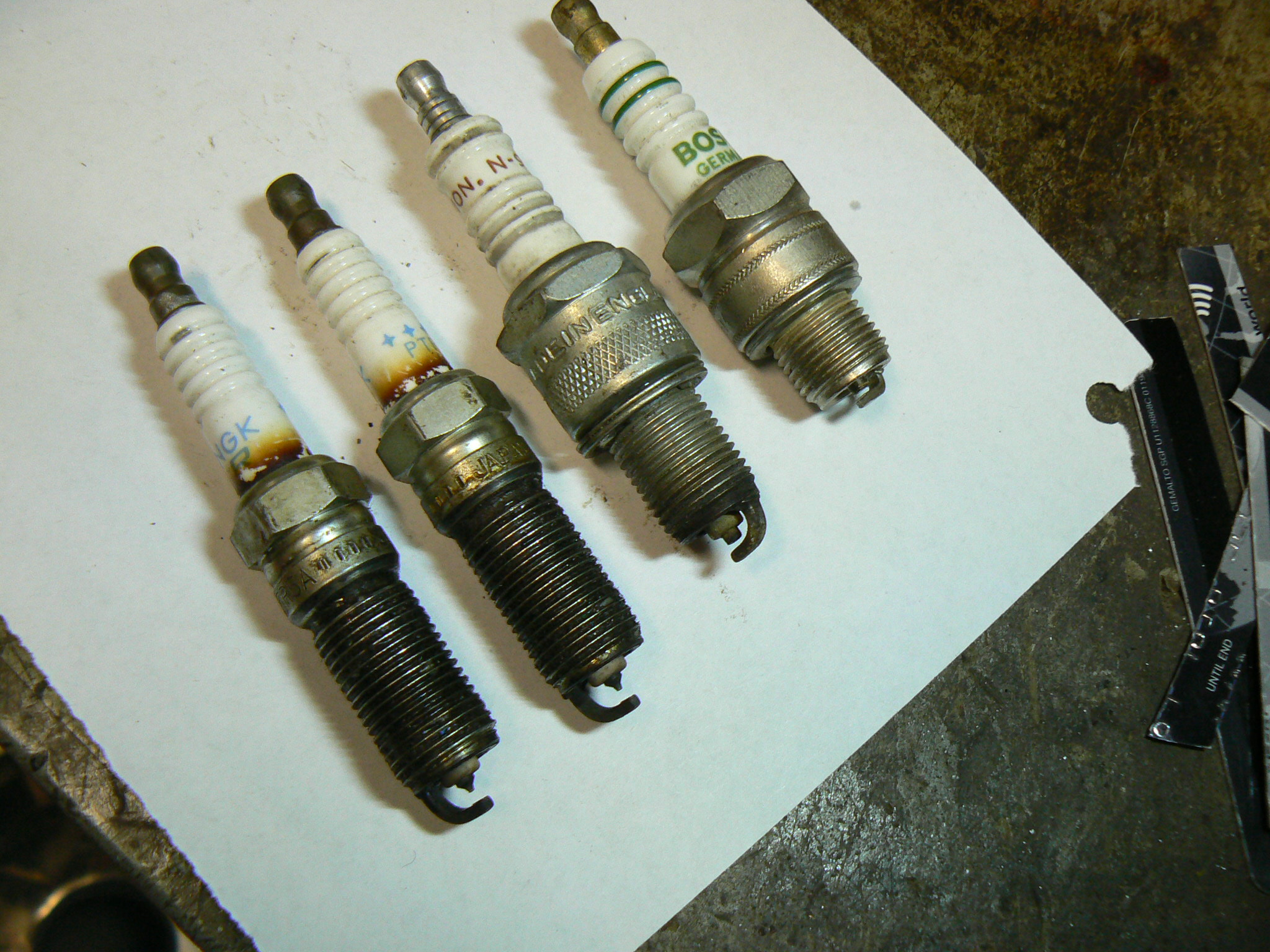

In my 600D (I know the Forum says 850, but where else to go?), I'm tracking down a problem with starting and idling. It only starts occasionally, and it won't idle when it does. I'm still checking on various things, but I noticed something curious yesterday. When I pulled the plugs, expecting to see them all wet from flooding, 1 and 4 were bone dry while 2 and 3 were wet like I expected.
The theory that I'm pursuing is that 2 and 3 have a weaker spark because of a problem somewhere in the circuit. I have confirmed that they spark when dry.
What I'm wondering, though, is if this could be a symptom of a carb problem causing unvaporized gas to be leaking down into cylinders 2 and 3? If so, what would it be? Carb's been recently cleaned and rebuilt. No leaks on the bench with a full float chamber.

First I assume all four compressions equal and good.
Any chance of a hairline crack in distributor cap across those two cylinders.
Spark plugs in good condition and correct heat code for your environment. Never wire brush plugs to clean as the metal particles cause breakdown of insulation and misfire.
No wear in distributor cam lobes i.e. same points gap on each lob when opening points.
No head gasket issues, water or oil losses.
Are your HT leads copper cored or radio suppressed carbon string. Test with multimeter Ohms setting to check for continuity, similar on all four leads plus HT to coil.
Re carb cleaning, does your carb have an idling jet and if so is it possible to remove the emulsion tube below it as some carbs store dirt and water there. No leaks with full float chamber as you say, but were you able to test needle valve by blowing (with a clean tube so you don't taste petrol all day;)) then keep blowing as you turn carb upside down so float shuts valve etc. without sticking.
This is all general knowledge from fifty years in motortrade, I did have a Fiat 600d with suicide doors around 1972 and a Fiat 500 around 1978, but none recent.
Final thought for today inlet manifold air leak / warped etc. between center cylinders. Sometimes you can hear this with a length of tube placed to your ear and other end run along between head and manifold.

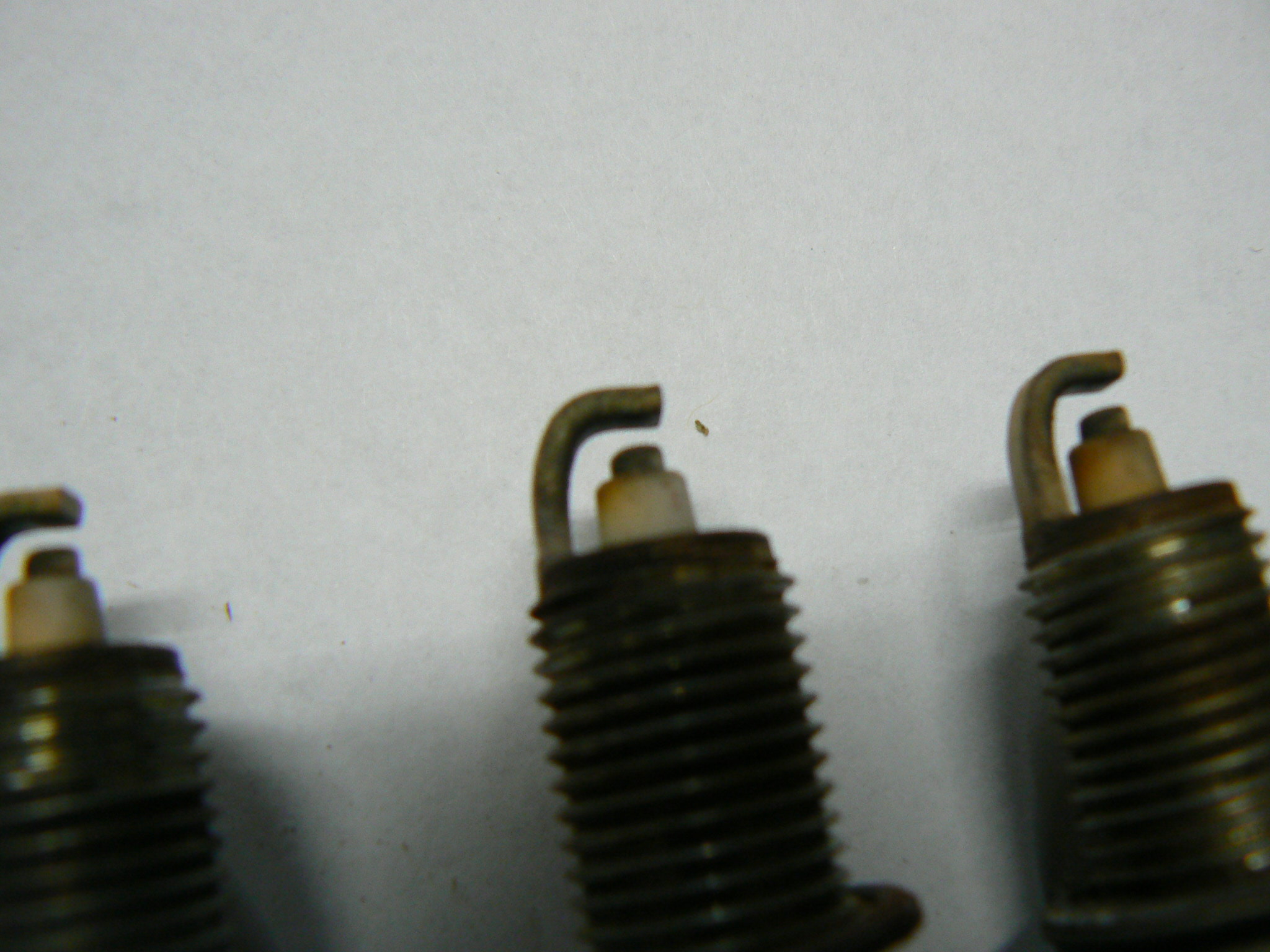

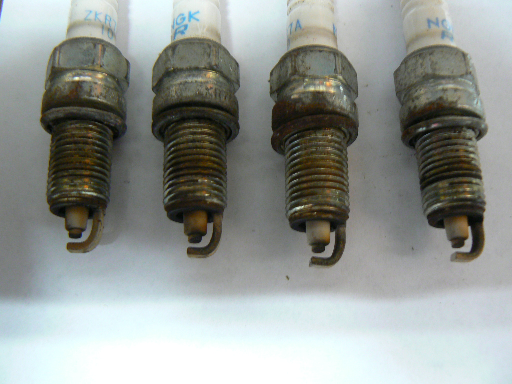

If your engine is in good order and not allowing excess lubricant to enter the combustion chamber then modern spark plugs are, to a large extent, self cleaning. Just look at these plugs which came out of Becky (2010 1.2 Panda Eco Dynamic 60hp) last year at service time:
The first thing to notice is that they have, in common with many plugs today, extended "noses" which project the centre electrode well into the combustion chamber which allows normal deposits to be burnt off during running. Look a little closer:
You can see there's been some degradation due to heat - you can see the discolouring of the ceramic nose - and erosion of the electrodes due to spark jumping that gap - Look at the centre electrode and you can see it's corners are a bit rounded off, so far no metal has been leached from the side electrode. These plugs have been in the engine for a couple of years and are looking pretty much as I would expect them to look, which is - No great build up of carbon deposits. Some evidence of wear to the electrodes (metal gets burnt away by the spark over time) Threads looking good and undamaged thus indicating that the threads in the head are probably in good order (they unscrewed without jamming up too which is another good indicator). I'm sure I could have just stuck them back in and the engine would have run on them just fine but maybe with a little reduced efficiency. If I was doing this I wouldn't have done anything to them except check the gap. However they've served me well for the last couple of years and there's always the increasing possibility of electrical breakdown of the insulation due to age so now it's time for new ones. These are normal, some call them "copper cored" plugs, which my local factor sells very cheaply so that's what I run both my Panda and my boy's Punto 1.4 8 valve on (NGK ZKR 7A-10). I could choose to fit "long life" iridium tip type (ZKR 7AI - 8 I think?) and "forget" about them for 60,000 miles/10 years? but that's not for me as I like to pull my plugs every year at service time and examine them so they can "speak" to me about what's going on inside each cylinder. Also by removing them every year it pretty much ensures they'll never have time to corrode/seize in place.

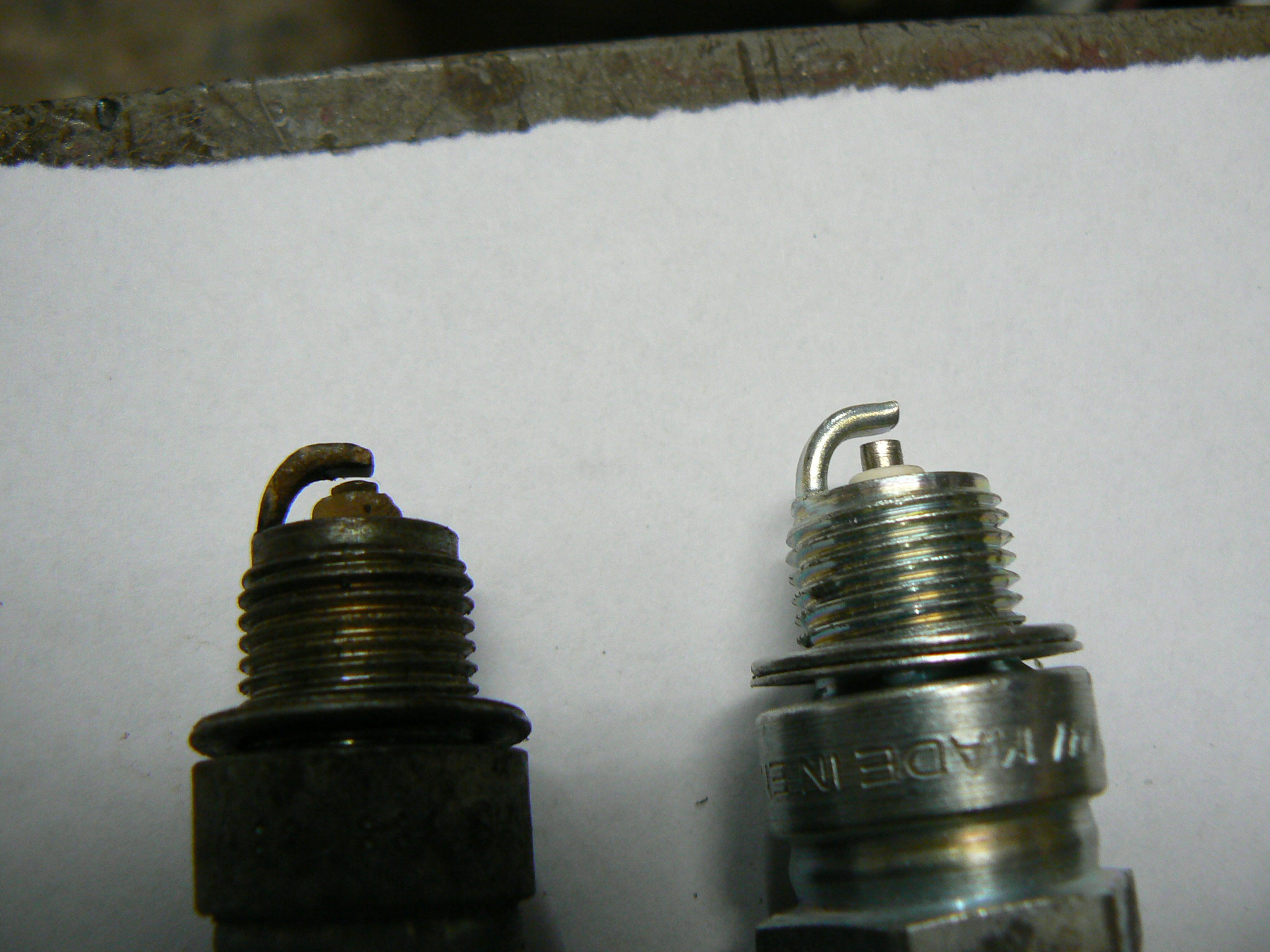

For those reading who don't have much experience of examining plugs here's a new one - on the right - compared to a well worn one - on the left. Just look at how much the centre electrode has burnt away:
Close examination will show the side electrode is also suffering slight erosion as it's tip is slightly hollowed - I've seen them much worse than this with side electrodes almost burnt away and. usually the engine missfiring - which is why the customer has brought the car in of course - nothing to do with them having missed the last 2 services?!

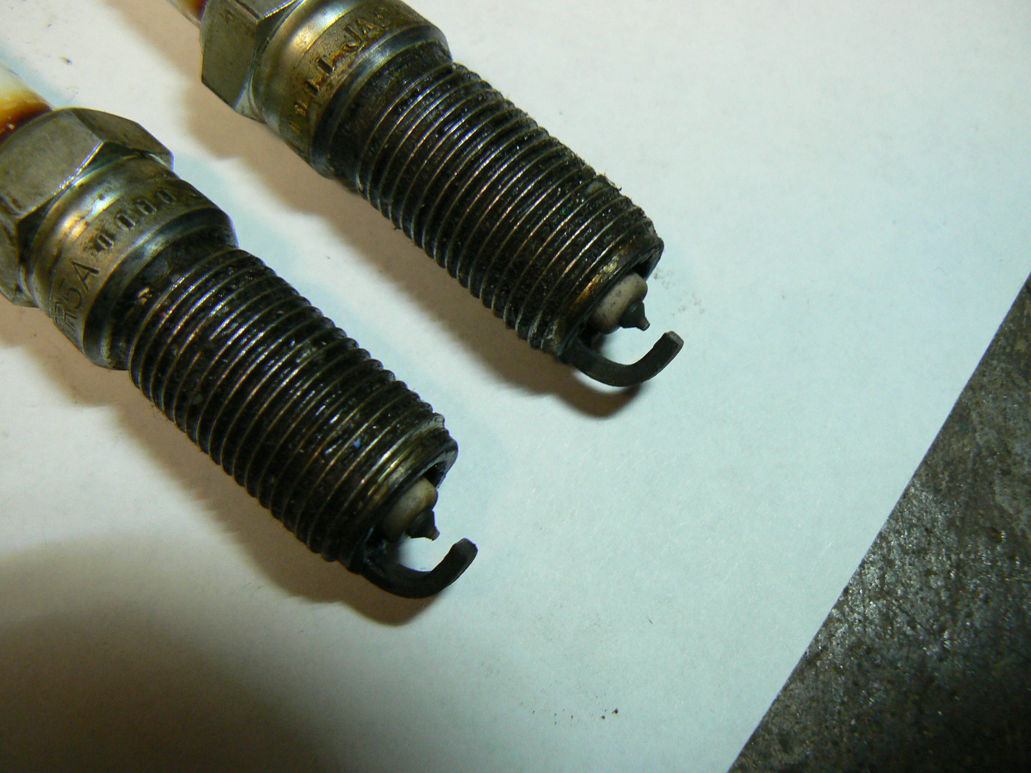

If your plugs look like this:
Where the plug is heavily contaminated with black carbon (soot basically) Then you've got an over fueling (running rich) problem and it's not at all uncommon to find this will be due to the air filter needing to be renewed! Of course other problems can be the cause also but checking your air filter should be a first stop check.

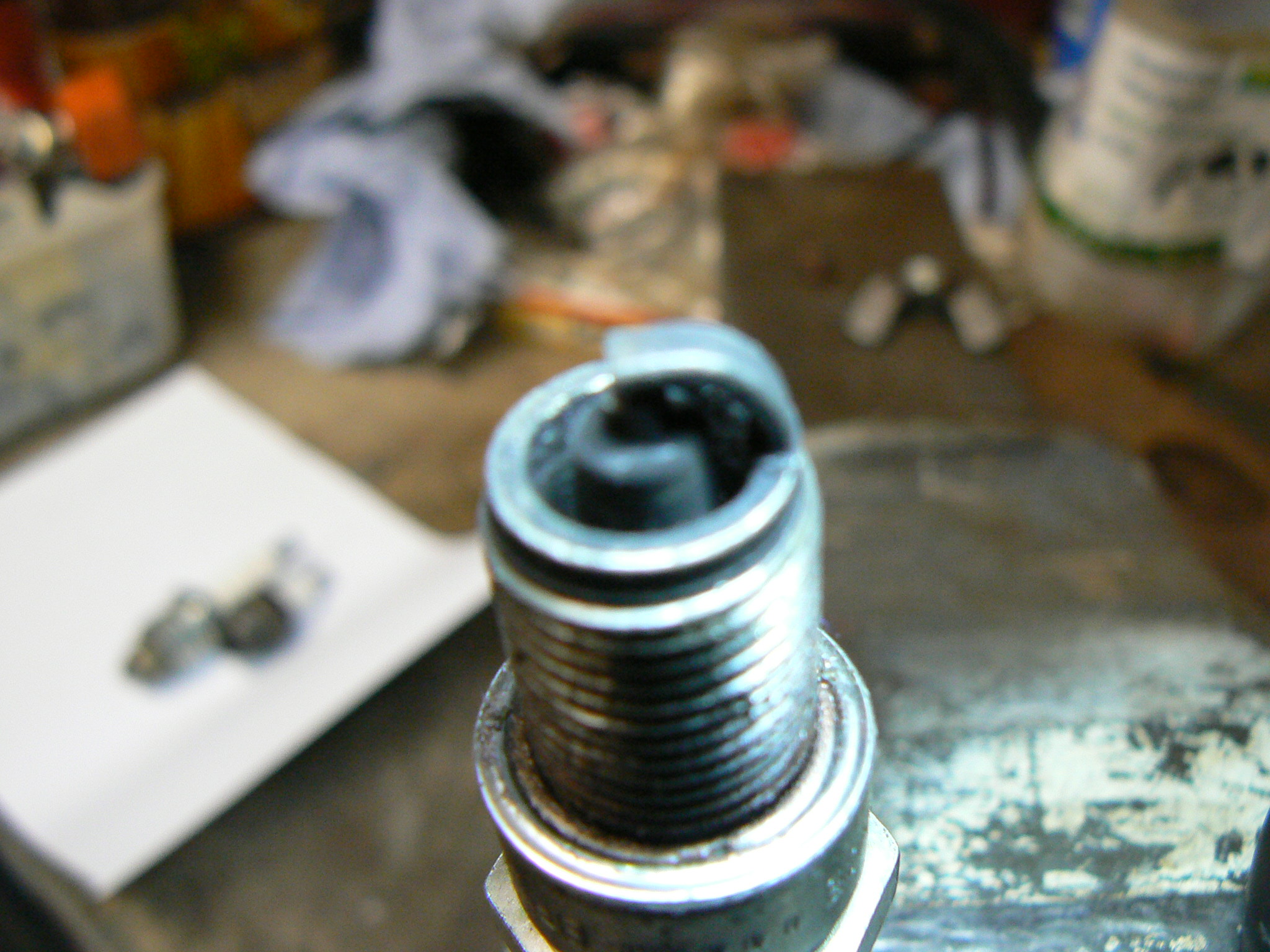

Or
Wet and "gungy" with often heavy deposits inside the end. Oh deary me! this is due to oil being burnt. might be something "simple" like a blocked crankcase breather but more often due to a worn engine - commonly valve stem seals, sortable at a price - or, more seriously, piston/ring/bore problems which often means a new engine needed as labour to "fix" it will be prohibitive. By the way, Any "clever clogs" reading this will probably recognize this oily plug is actually from a 2 stroke but I didn't have an oil fouled plug from a 4 stroke to take a picture of - sorry! So, at the end of the day, If the plugs are nice and clean burning like mine above which you saw in my first picture then, if the electrodes are in good order, you can reuse them, just screw them back in. If they don't look "good" then, if it's just electrode wear renew them but if it's contamination you need to sort out the problem, no amount of wire brushing will sort that.

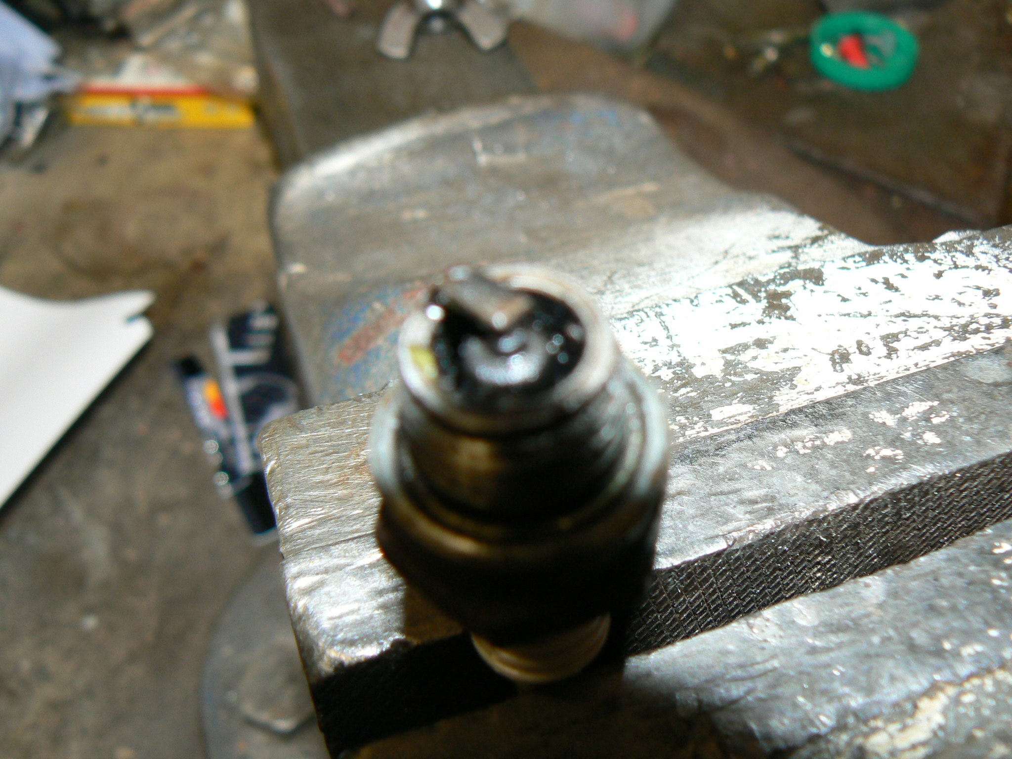

Just to finish off, again for the information of our less practical brothers (and sisters), here's what the business end of a couple of "long life" iridium/platignum/whatever plugs looks like:
You'll notice right away how different the centre electrode looks - very thin and "pointy". These centre electrodes are very brittle and should not be abused with gaping tools as they can easily snap off! The manufacturers claim the plugs are pregapped and should be fitted without attempting to adjust them. I still check visually just to be sure they haven't been damaged in transit. The NGK "jobbies" have a hard cardboard tube in the package which protects the threads and electrodes, I've never had a damaged one.
If course if your engine only has a long life plug specified - like my IBIZA - then that's what you should use, but I'm very happy to go on running "copper cored" plugs in our wee Fiats.
Finally, another thing which "bothers" me is the length of the treaded part of the typical plug on modern engines. Just look at those two Iridium plugs compared to a couple of older plugs:
