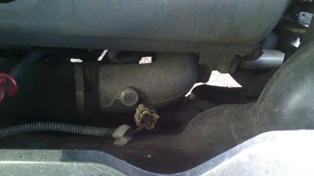

Hi again, so one quick question . . There is a pipe tucked under the bonnet release with a filled hole for a sensor, and the cable for said sensor is hanging free. What is it for? Also it does not have a DPF. See the pick for the sensor location.

Not a hole for a sensor its the bearing/pivot for the butterfly in the throttle valve. Not sure re: connector maybe its for an optional bonnet switch.
