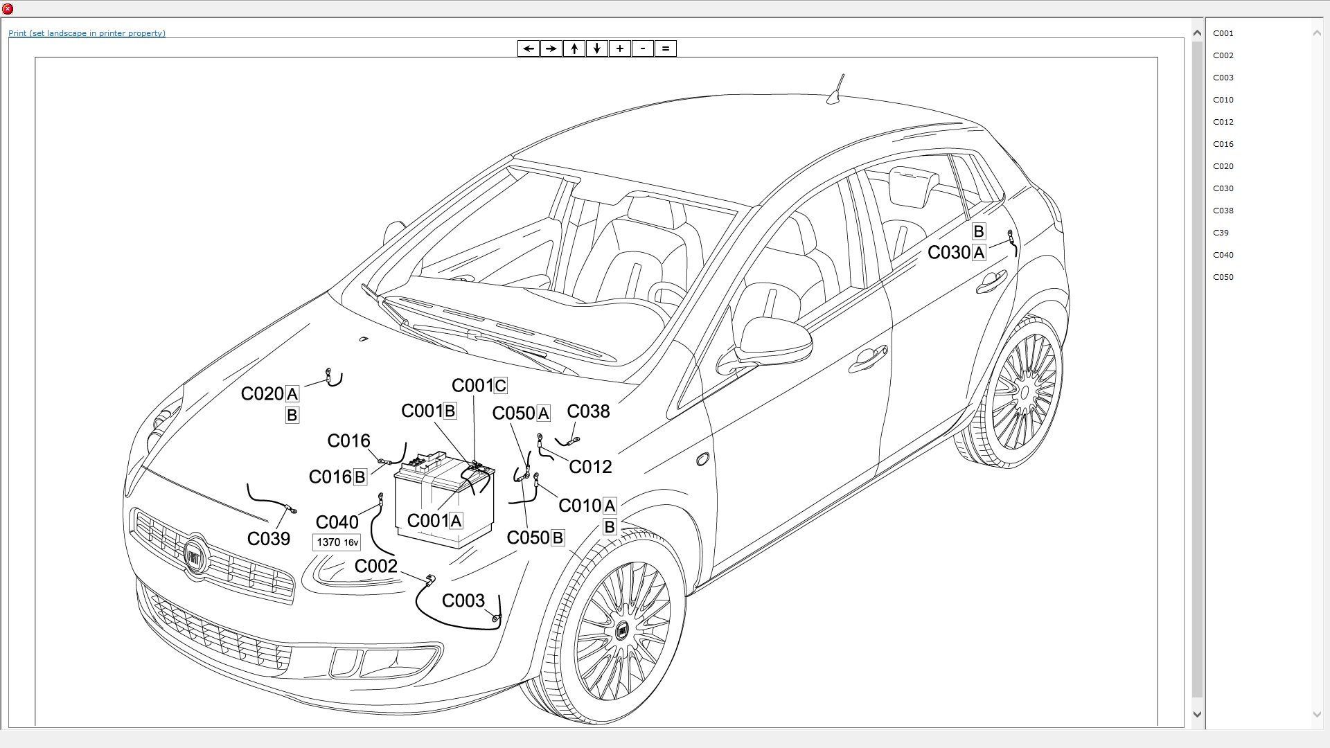

This is my first post here. Unfortunately I need some help. So, In the morning I started the car, went a few meters, than every sensor in the car went nuts. ABS, ESP, Doors open, no brake fluid, no turn signals, no power steering, radio volume went up and down. I turned back, unconnected the battery and charged it.
Next day I gave it a try, the car started, took it on a test run and my turn signals were totally random, sometimes it went on from itself, couldn't turn it off etc. But the warnings went away. Ok, stopped again.
Next day I couldn't even start the car, the immo blocked it.
Next day I started it and everything was working. Ok, maybe the ****ty battery, I measured it and It went 9V below when I started the car, but it started the car, and when the engine was running it was above 14V. Ok, I bought a new battery.
But still my turn signals are random, my fuel gauge shows empty, but it's not empty, and as I discovered I can't turn on my front fog lights (It works when I turn the wheel).
My guess was a bad earth, so I checked the engine bay, the engine ground and the ABS ground (at least I think that one is that) was total ****, I polished them, they are doing their jobs now. But the problems still persist.
Checked the Bravo eLearn, now my suspect is the "C038 EARTH ON CENTRE TUNNEL":
But I don't know where can i find this one. Do you guys have any idea? What can be the problem other than the grounds?
