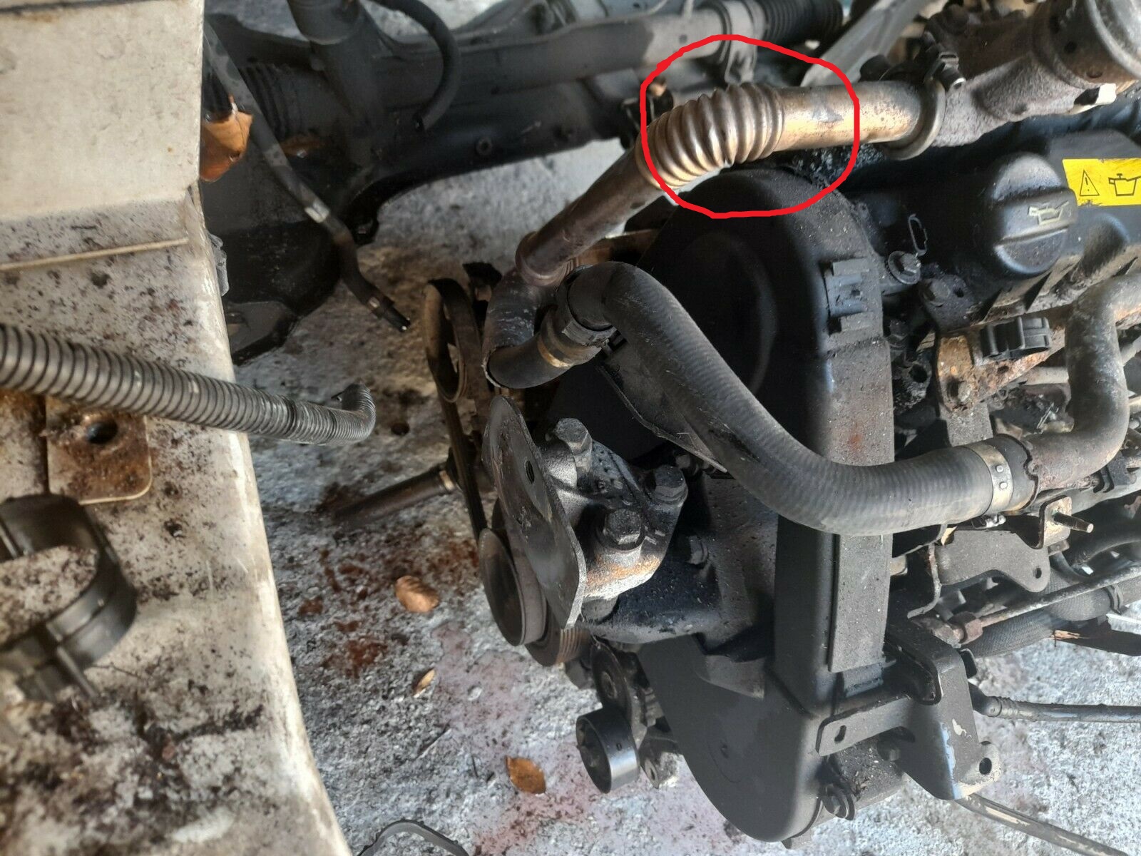

Hi guys, I. trying to replace the hp pump on my Ducato, fell at the first hurdle! For the life of me I can't
get the top cover of the cambelt out! There is a stainless steel pipe that runs past the cover on it's way to the turbo, this looks a pig to remove! I've tried every which way to wiggle the cover out but no chance!
Anyone done this job before give me any tips please?
Thanks Ronnie
This is a picture from ebay showing the pipe

I am not familiar with the 2.0jtd, but it is covered by my copy of eLearn.
I have had a quick look, and it seems to suggest that the timing belt cover is in five sections, and that the top section is not the the first to be removed. It confirms that the stainless steel EGR feed pipe will have to be removed.
I am attaching a pdf copy of the relevant pages.

Thanks very much for this, it confirms what I thought about the egr pipe.
On mine it's the same but the clamps are crimped on to the egr valve, I would need to break one off and find a bolted replacement. The funny thing is I had the belt changed by a local garage I guess he must of had to remove the pipe also but not sure how he done it.
