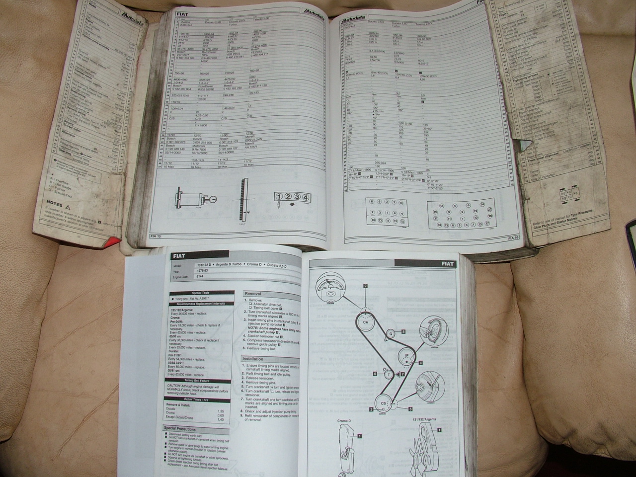

This is around that era. The cam belt book is only for the 8144. If you need the 8140. I can get it later, it's in my Scudo out in the rain:)
The torque details index is on the right. Let me know if you need a more close up pic.

Your a legend. So no new bolts needed then. Excellent.
Unfortunately the picture is a bit hazy. You could email them to me for higher resolution perhaps? Or some closer pics would be better alos for anyone else searching and finding their thread.
Thanks a million!

Shakey 71 year old.;)
Excellent. Thanks legend! Clear as day ;) If you do have a break in the rain the 8140 information would be interesting. Just to compare. I doubt they differ.
