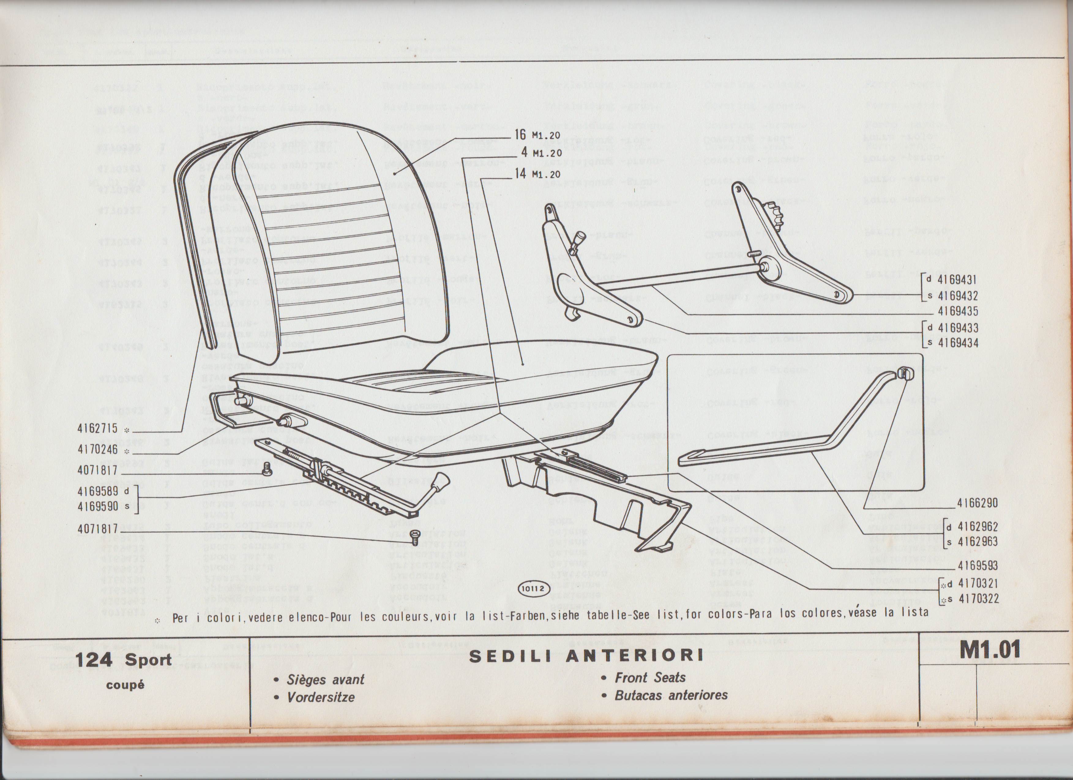

I don't have info on the 124 Spider but here's an image of the seat used in the 124 Coupe - I believe they're very similar.
I can recall that there are 2 meshing gears inside the seat back angle adjuster (i.e. seat back hinge) that has the round adjusting knob but I'm not sure if the seat back adjuster on the other side also has 2 internal gears but likely does have. There's also a connecting bar/rod between the 2 adjusters that has a square formed on each end that synchronises the movement of the 2 adjusters. So, it's possible that one or more of these gears has stripped teeth if the seat back is not being firmly held at the chosen angle. The (124 Coupe) seat back adjusters had a plastic cover plate that could be gently prised off to view the gear teeth. Iirc, removing the adjusters from the seat requires the use of a No.4 Philips screwdriver/drive bit, a size that's not often called for and therefore many don't have (iirc, this size of Philips screwhead is also used on the 124 door hinges).
I've seen these broken seat adjusters 'repaired' by someone having welded the 2 damaged gears together with the seat now being held securely in a fixed, i.e. no longer adjustable, position. To each his own, cheap too...
midwest-bayless.com have some seat adjusters listed for the 124 Spider, click on 'Interior', then page 2. They also show an image of the seat components for the 124 Spider on their image for the 'connecting bar' I mentioned above.

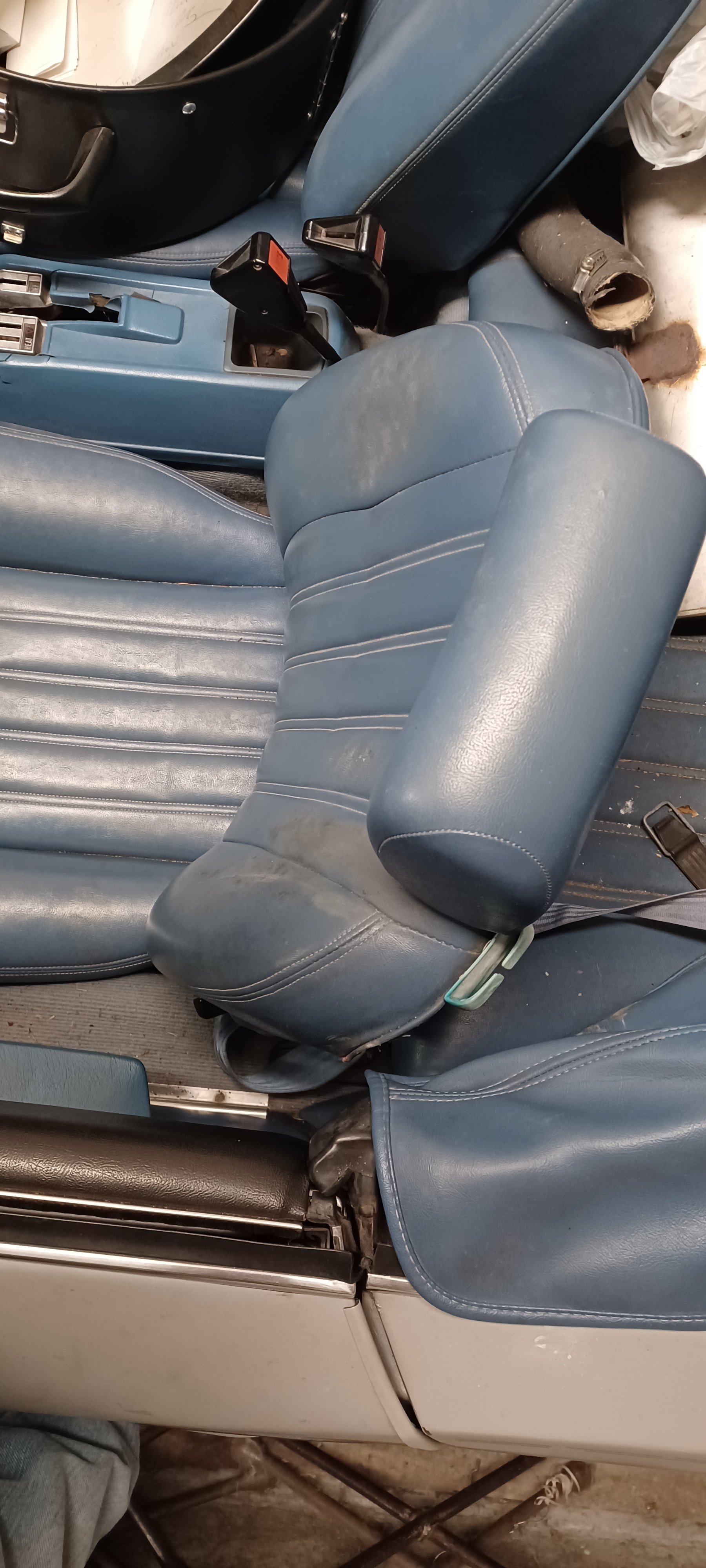

We have Flys here like the ones you speak of, "deer flys" you swat one biting your arm and they only move over a few inches and bite again..thought I would post this pic of the condition of my seat, I hope it can be noticed the "twist" of the seat back, I thought I remembered seeing this before in other spiders so what ever happened might be a somewhat common problem? I'm sort of stuck at the moment until I shift a couple project cars around so I can fully access my spider and get access to it 360 degrees, currently in the spot where it's slept 12 years I can only access the front, I'm hoping soon to have pics of the seat apart...Terry

This is my spider, was a California car prior to my ownership, automatic trans, 60k miles, no rust to my knowledge, been stored indoors so the seat issues I guess are structural..
