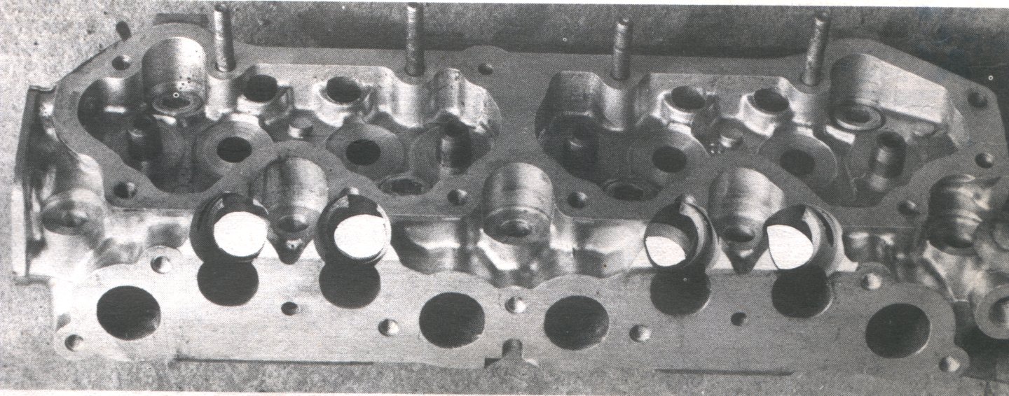

if you wan to go really radical.... try something like this!!!
I'm planning a 1603cc sohc engine for my 128 sedan! :) I have some details on that if your interested.... should make good hp.... but will have great torque, which is what these engines really need more of..
SteveC
