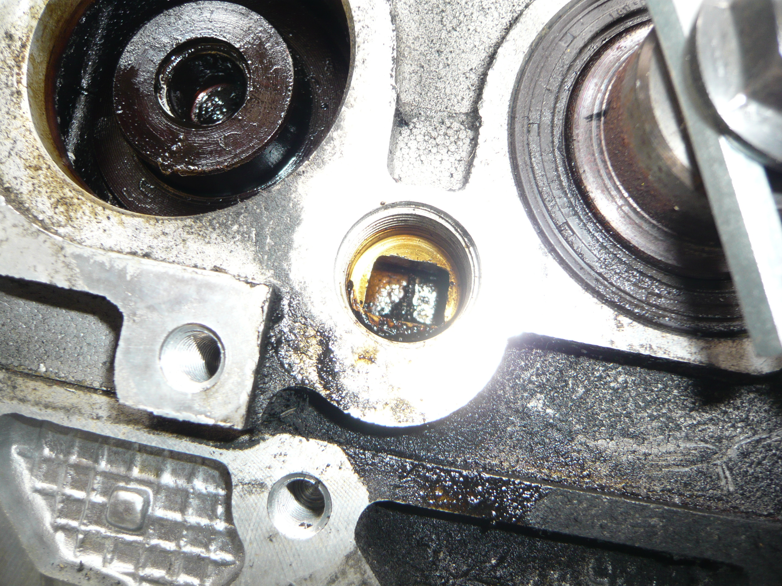

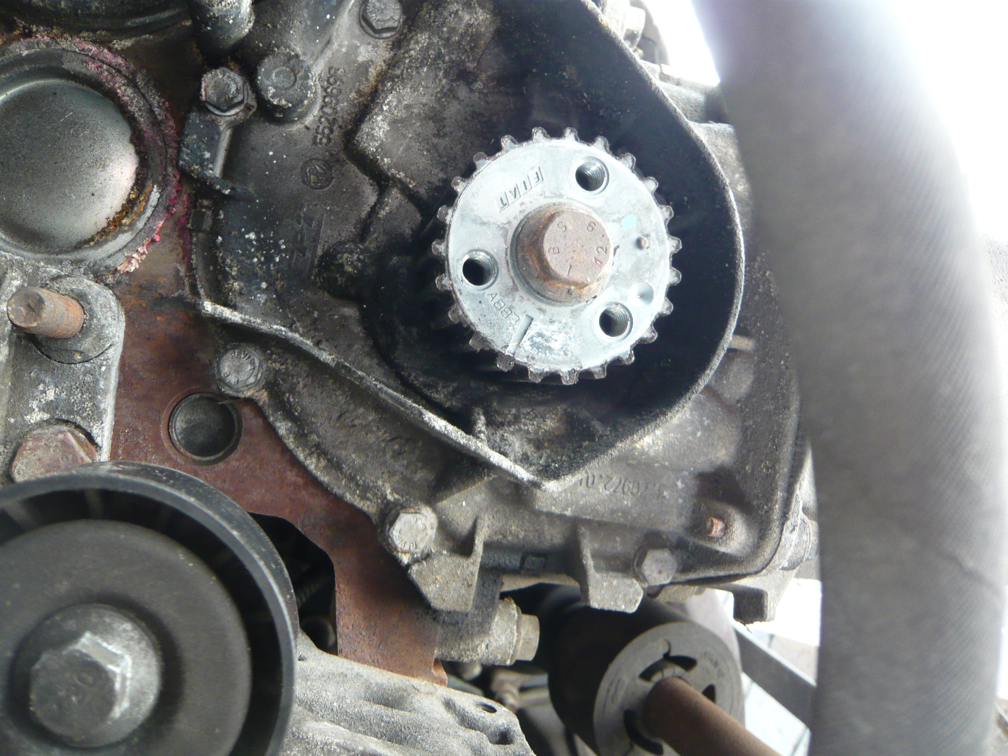

I'm a little confused here - I can only see one plug. I've had to remove the sprocket anyway to get access to the plug, and I've removed the small cover next to it but that has only exposed the end of the other camshaft. Would the second plug happen to be behind the first one? I've stuck a 10mm allen key in there and it's locking in to something...
F123C this is what I'm seeing in the hole. No movement of any sort. Am I in the wrong place?

Regarding the camshaft cutouts (I eventually realised which plugs I was supposed to be removing... :rolleyes:) if the cutout on the front cam is visible, surely that means that the rear one must be in the correct position, so there should be no need to remove the rear plug? I mention this because in doing so, I managed to snap off the fuel pipe feed which resulted in a trip to the nearest scrapyard, who, fortunately, had a car in the yard which had the correct fuel rail. I also had to cut the fuel line off, and surgically insert a new section from the donor car :mad:

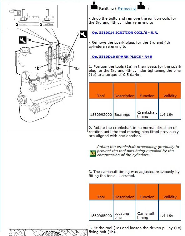

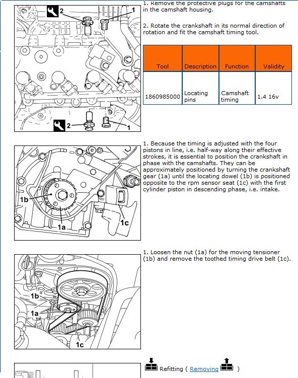

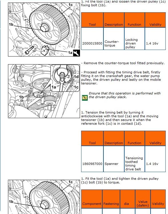

'Aschiuta' has very kindly posted the info I mentioned that can be found in the Downloads section at the top of the page (eLEARN, then scroll down to and select New Bravo), which probably answers your other questions. This info mentions the engine is timed with No.1 piston on the intake stroke - in your 1st attempt at timing the engine, maybe No.4 piston was on the way up rather than going down i.e. 180* from where it needed to be relative to the camshaft/s position (set using the cam locking tools).
Re:- only needing to lock one cam in position, as the other is gear driven from it, you're probably right if just changing a timing belt. But what about a situation where someone has also removed/refitted a camshaft/s (e.g. to work on the valves), how would you time the second cam?
