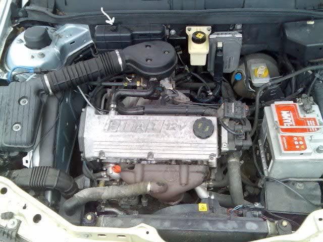

i searched a lot and i found a clue: there are 2 fuses of 7.5A one for immobiliser and one for injection(or smth like this) anyway both of them are connected to the immobiliser.I am looking for them for 2 days now and i could not find them .can someone help me?
my car is fiat brava 1.4 12v 1998
the exact name is :
7.5A fuse protecting ignition switch
7.5A fuse protecting Fiat-CODE/electorinic fuel injection
can someone help me with location of these fuses??
