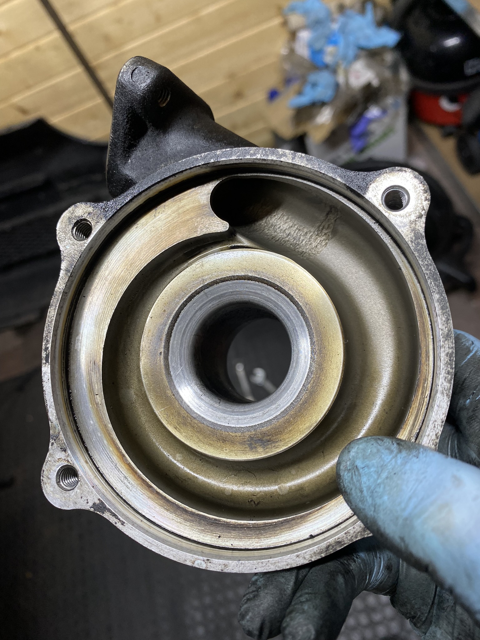

I might buy one but the turbo didn't look great. I think the nut has made it's way off the turbine into the engine.
I fitted a turbo supplied by a customer (so his liability) on a 308 Peugeot, worked great for a day then the nut ran off the impeller and lost boost, luckily it had stopped in the inlet hose. If only the nut I would have thought if it had got in and jammed a valve open then there would be zero compression on that cylinder. To mess up like you suspect then I was thinking bits of impeller inside the engine. You never know, I learn something new every day.
If no other damage than the nut off couldn't you get a good quality heat proof nut and carefully refit it? To test it could you run it up with the pipe to the engine off and see if it was giving pressure. Keep your fingers out though;)
The turbo is knackered anyway so couldn’t reuse it, maybe new cartridge would be ok. I’d be surprised if the nut made it to the engine past the inter cooler and pipe work bends.
