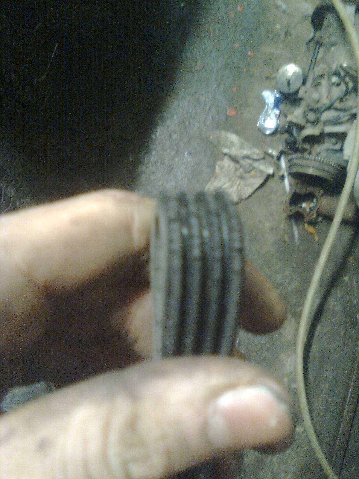

You'll need the 2 aux belts too, power steering and alternator belts, as if you try refit the old ones they will snap after a few hundred miles. Another €15 tops.

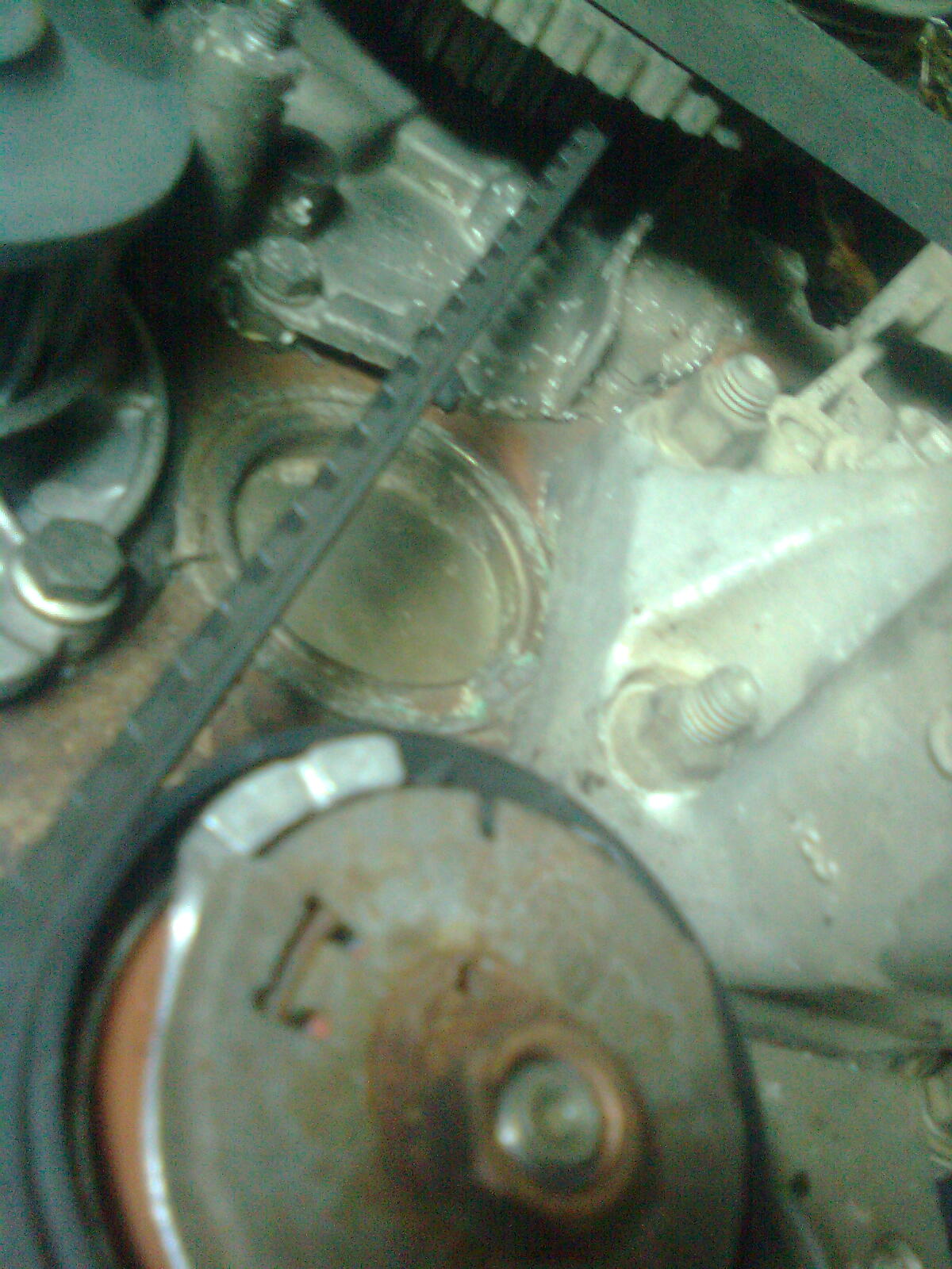

It can be but I wouldn't recommend it. At the very least the cams need locking... Ideally the piston tools aswell to see if the pistons line up (see below)
The little weight has to line up with the cutout to tension properly. This one wasn't done right

Here is why you shouldn't reuse the aux belts:
