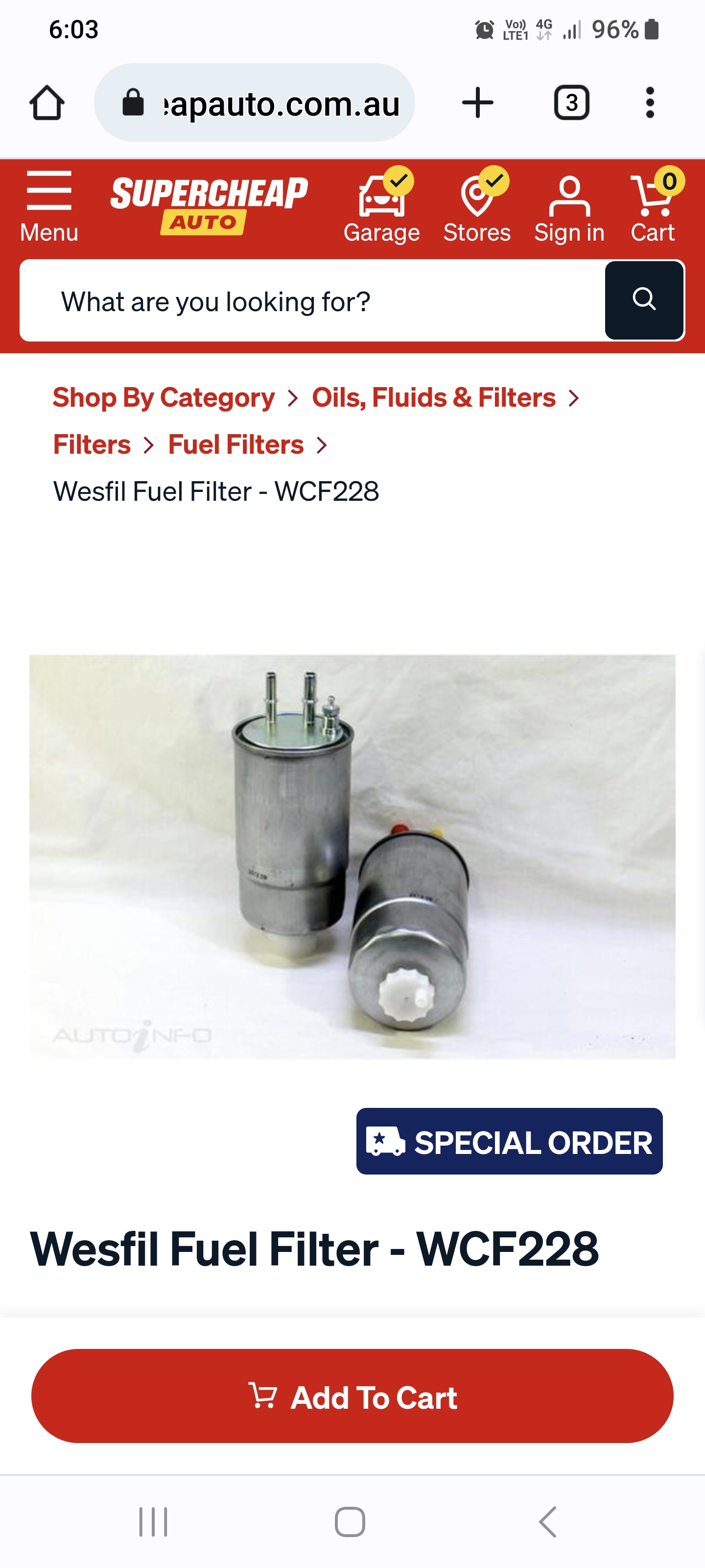

I have read a few similar threads and found some possible causes including fuel filter, split lines, bad turbo and bad egr valve. I have tryed checking all hoses and.pipes for leaks but they seem fine, except for being coated with oil all through them. I want to.now try and change fuel filter and was wondering if anyone had a part number for it. The one.that comes up at supercheap doesn't look like the correct one. I'll attach the link to it below.
The one in the picture they tell me is correct but mine has an electrical plug that goes in the bottom unlike the one in pic.

Re the filter, any chance serial number still readable on the old unit?
Re performance can you draw off some of the diesel before the fuel filter in case the tank is full of crap also, if so you will have to drop the fuel tank and clean thoroughly the whole system, then put new fuel filter in. Water etc. can give surging etc.

I am guessing the plastic nut and the bottom of the filter if connected to a pipe could draw off water as on some they have a sensor fitted in place of the plastic nut that activates a warning light for water in the fuel. You could use that as a guide to dirt in the fuel.
Though if there is more than a little I would suggest dropping the tank and through cleaning.
