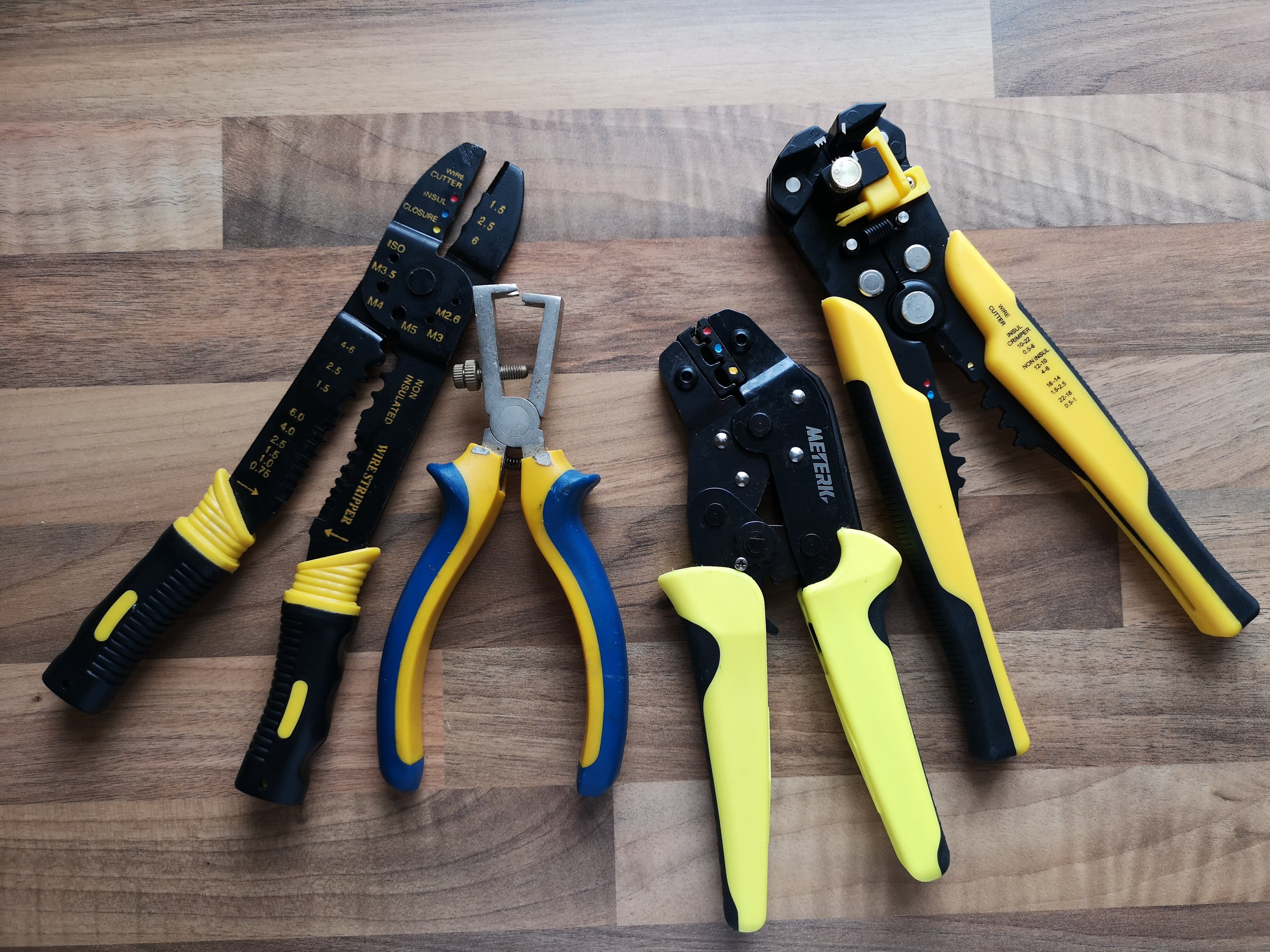

You mention your basic tools a crimper and wire stripper. I presently don’t have either so would appreciate a photo of yours as you mention size is important! ;)
Thank you.
Many thanks
Knowing I had to do plenty of stripping and crimping I used the excuse to buy myself better quality tools.
On the right in the picture you can see my new ratchet crimping tool and strippers. I'm sure these are very good, but too bulky to use in the space. My old cheap ones on the left worked fine, it was still a little fiddly but manageable.
Removing the trim from the boot and pulling the wire through to get more space was vital. It may be possible to strip down the trim at the back of the car to free up the wiring loom from the car side, but I managed without doing this.

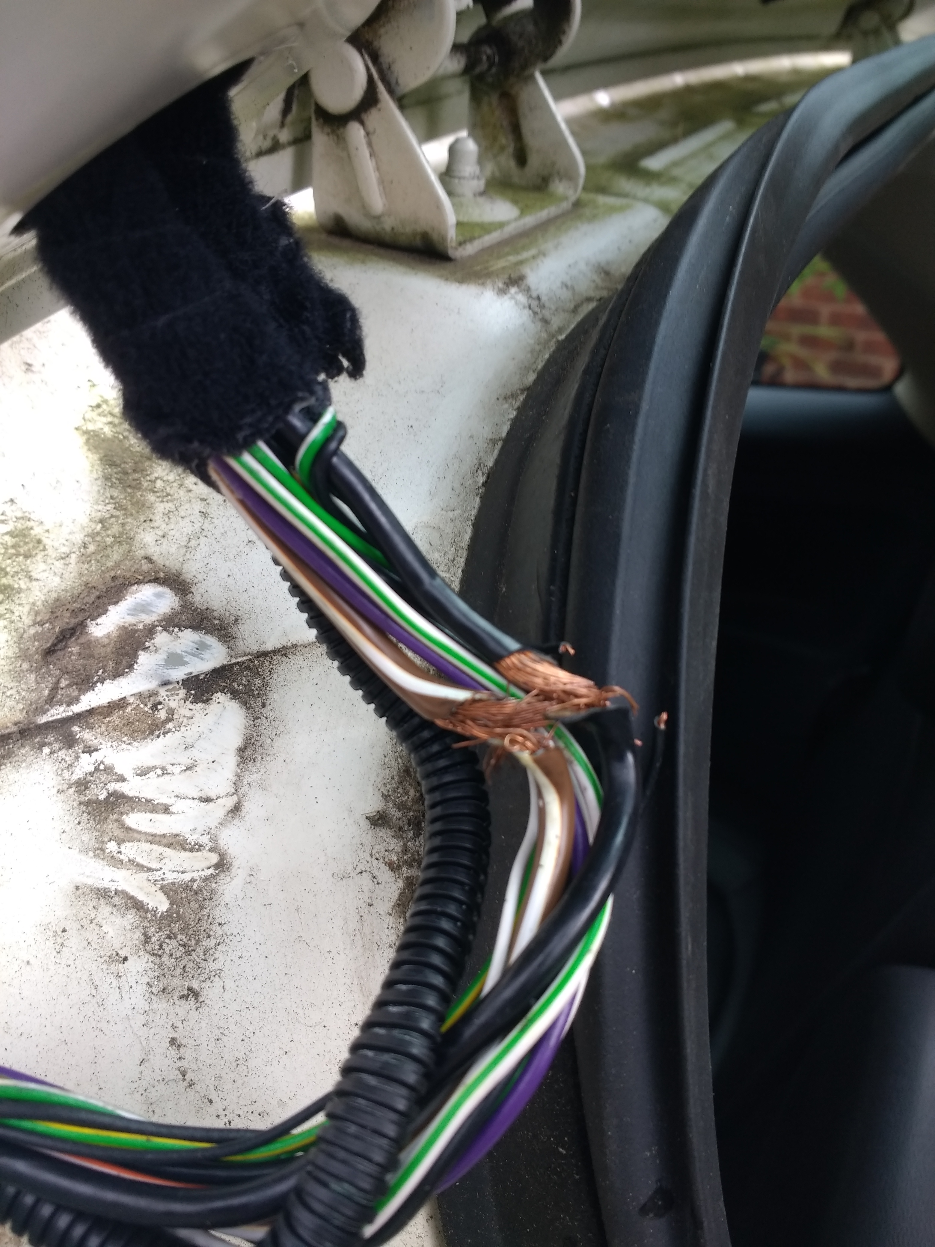

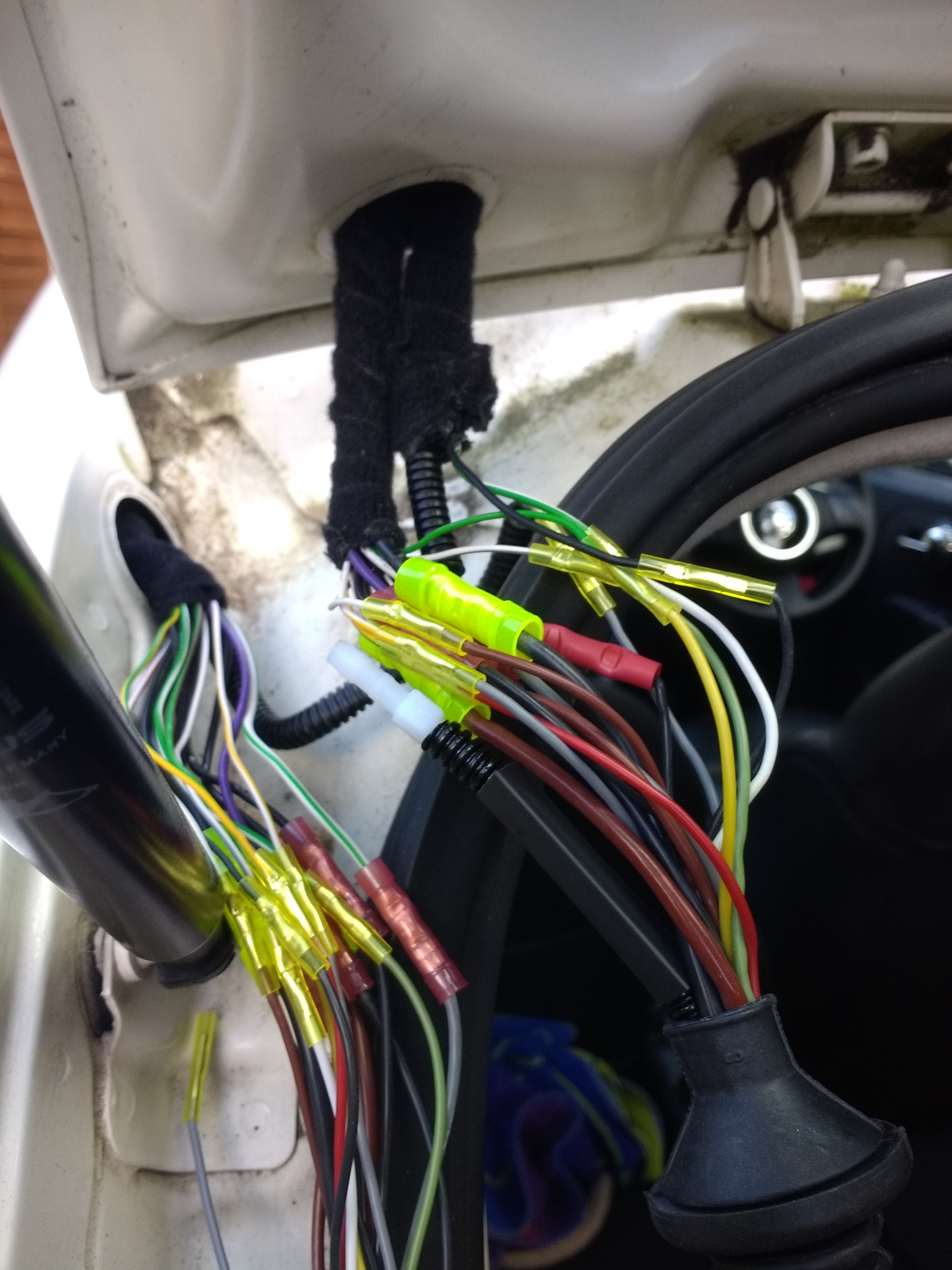

Just wanted to follow up and thank everyone for this informative post, my wifes car had the same issue transpire and i hadn't even noticed the number plate lights not working just the failure of the tailgate to operate from the button. Read the post and found the suggested repair and bit the bullet and ordered a sencon repair kit from Amazon for £22 plus i paid an extra £4.99 for next day delivery. Great bit of kit but scary as hell looking at how many wires are involved.
The kit arrived and i ventured out and began to gain access as bob suggested as with others kits no instructions included but once i realised the colours didn't need to match on the new section as long as they matched the rejoined section (obvious really) then everything fell into place.
Getting the cable harness pulled through took a bit of work but cutting off the gaitor and the proted wrap was fiddly as i didn't want to cut any of the wires with the blade, when i got it off i too was shocked by the sight of both the cut wires but also the bare exposed wires.
I had an old wire crimping set in my shed that i had never used but it worked a treat although it is very fiddly but doing one wire at a time is best. I made one mistake getting too confident towards the end and actually snipped the connector in half with the cutter instead of the crimper but luckily there is a spare wire in the harness which i recut and used instead. I added plumbers ptfe tape to the water pipe and also used the heat shrink and a hairdryer to seal.
One all the wires are connected getting them back inti the roof and tailgate takes a lot of poking and prodding but it does eventually go in and then its a case ot trying to get the grommets to fit in place. Once everything was back together i refitted the negative battery terminal and tested the number plate lights were working they were so i was pleased, then i pressed the boot opening button on the car and nothing happened. I was gutted and sure i had maybe snagged one of the wires etc etc so i locked all the doors again and tried again and this time everything worked perfectly i think the car had to do some sort of system reset and it now works perfectly. Thanks for the help and here is a couple of pictures to show what mine looked like. Hope it helps someone else.
