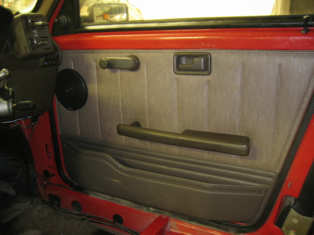

Right, so in the past I've plastered on underbody coating thickly as a cheap sound deadener - but what is even cheaper is to apply a thin coat of the underbody coating (1L tin costs equivalent of 5 pounds, sufficient for all four doors) and then cut some flooring vinyl into rectangles (offcuts free from a dumpster outside a carpet warehouse) to stick in place onto the black goo. See the first picture.
The second picture (taken several hours later) shows the unorthodox location I chose for the door speakers. The door cards (from another red Uno 45 5-dr) had no speaker holes, in fact they were truly pristine, with all clips in place and waterproofing sheet AS WELL as black vinyl on back of card, and no warping... hey any of you with Mk1 Unos will know how rare that is... :)
The convention is to cut a hole near the bottom, and attach the speaker to the door card itself. Then screw on the door pocket (screws from the back of the door card) and finally clip onto door. This is not the best because the speaker has only a flimsy mounting, particularly if the door cards are in 'average' condition (unlike mine!)
If you're keen, you can move the speaker closer to the edge of the door card to get some of the screws into the metal, but you still have the problem of the door pocket getting in the way when you try to put the speaker screws in after fitting door card to door.
Soooo... here are the benefits of my installation:
- 4" speaker fits neatly into rectangular slot in door structure (as shown by white ellipse in first pic) with no cutting into the sheetmetal
- All four screws go into the metal so no need for those 'spire nuts', just cut hole in panel with jigsaw, fit panel to door, drill four holes, and screw in
- Sound imaging is improved with speakers further forward and raised (IMHO at least, maybe Tipo drivers will agree)
Because the speakers are mounted extremely solidly, the improvement in sound quality amazed me. These speakers are Jensen-branded and cost equivalent of just 5 pounds (Jensen went bust and most of the products are really poor quality, see the third pic for a closeup of the CD Tuner, with non-motorised CD transport, bought new for 35 pounds-equivalent).
Anyway, I can feel the bass through the floor, which really surprised me, and of course the doors sound so much better when you close them - no tinny clang.

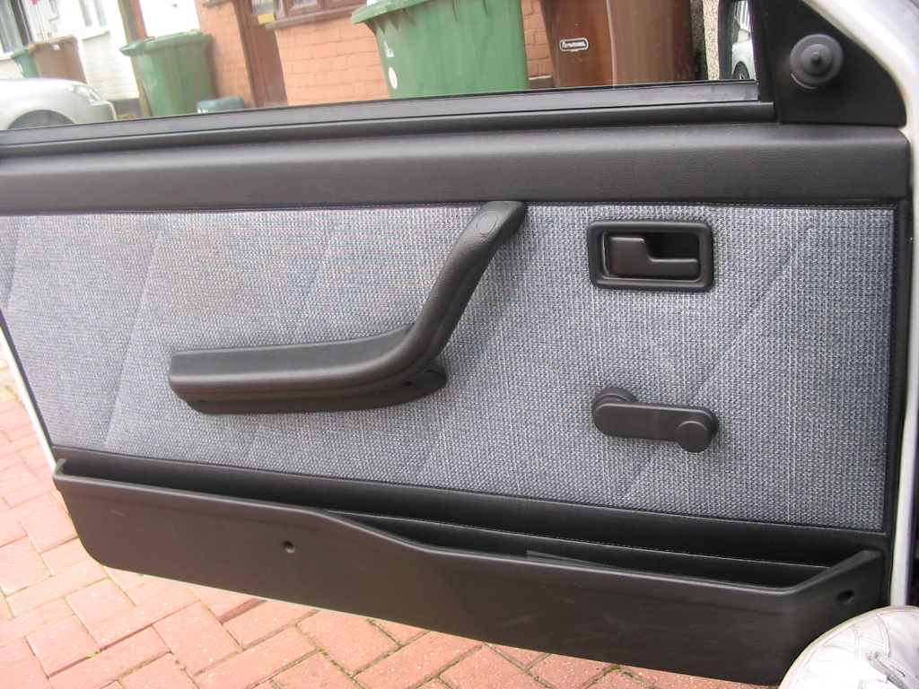

I don't think they're the same doors though. The attached photo is what mine looks like - the window winder is in a different place. The actual metal work behind the door card might be similar, but I couldn't check as it started raining.
Ah, yes, I see the square rubber plug. I was looking for a groment before - never mind! That's actually quite a neat place to put it - all hidden behind carpet and upper (vertical) sill plate.
I don't have any previous metalwork experience, so I wouldn't know where to start. I figured I would probably need to strength something with a speaker install in the doors, so plan was to use plywood or MDF or similar thin-ish sheets of wood. Maybe speaker rings etc. - Can't think yet though until I pull off the door card.
In a way, I guess, it would be easy to get carried away - 4" at the top, 6.5" at the bottom, maybe tweater in the arm rest... Hey, any experience of the rear door cards on a 3door Uno?
