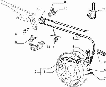

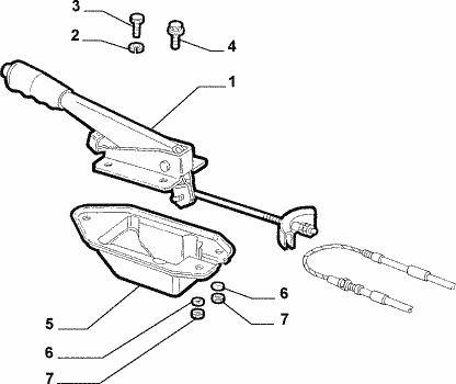

The handbrake on the cinqs and seis are different.
On a cinq you have a pulley wheel where the adjuster is and on the sei its a crescent shaped jobby. Its hard to explain i know. Heres the ePER cd picture, explains it better(Cinq on the left Sei on the right).
Incidently these pics were both taken from the cinq section suggesting that some cinqs used the sei system.

Hmm, I'm kinda tired and maybe my brain is not working but I think my car has had the Sei cable on it previously and now it's back to the Cinq one.
Will clarify soon.

My car has the first system on it. I'm looking to change the rear brakes soon so if you can find out, liam? That'd be fantastic :D I can get hold of a 899cc handbrake cable without any hassle at all

Liam,
They changed the handbrake late 97 and used the parts intended for the seicento. You can tell because the handbrake lever looks a bit weedier. I just fitted a new cable to mine last week. Cable is easier to fit as you dont need to remove the lower cover from the lever assembley. My cable is exactly as you describe. It could be that the revised handbrake went along with the seicento type steering wheel/column
