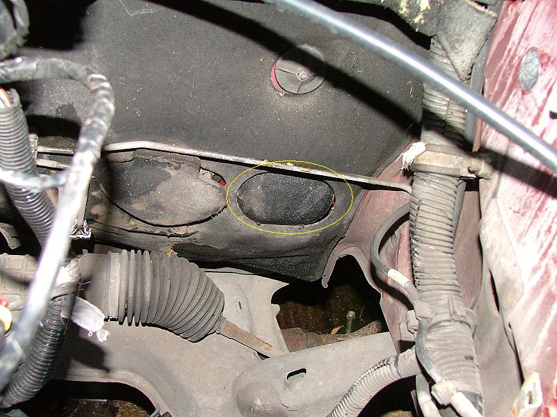

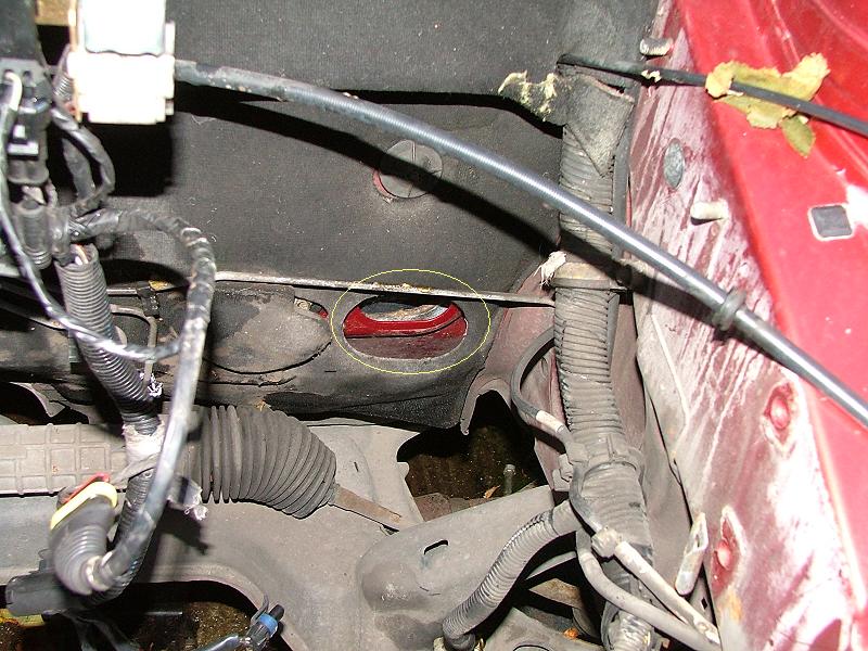

Hi welcome to the forum, there are 2 picks below showing the back of engine bay you will see thay there is an oval of the black sound proffing that you can pull out, pic 2 showes a hole in that hole you will have a big rubber bung you can make a hole in this for the cable,

i just when and had a look, but on mine its not rubber, its the same sound thing, and i lift it up and bare metal was there :confused:
i'll look again in the morning
EDIT:
:bang: still cudnt ffind it so i just ran it through the wing into the car, all working :D

I too am trying to wire an amp in my Fiat Punto 60 S (T reg 1999) but when i remove those patches of sound proofing, one of em is just solid metal body work, and the other is that rubber plug with the bolt on either side (i.e. the left hole in the image u've attached). in ur image, its quite clear that the right side hole is a bung that can be removed. i dont have that.
shall i try removing the proofing away from the body and see if its hiding elsewhere? strangeee!!!

Thats really odd because I have recently installed a sub in my boot (96 P Plate 55sx) and there was no problem using that grommet shown in the pic.
I have read elsewhere that if you pull back the sound proofing on the right hand side of the engine bay (batt. side) then there is a small 1" diameter grommet than can be used aswell. I was going to use this one but routing it through the other one at the bottom was much easier, but seen as though you dont have that option then the smaller grommet behind the sound proofing is a better idea!
