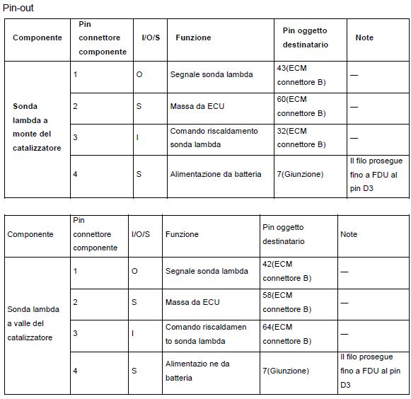

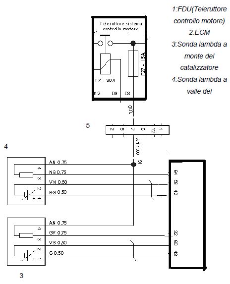

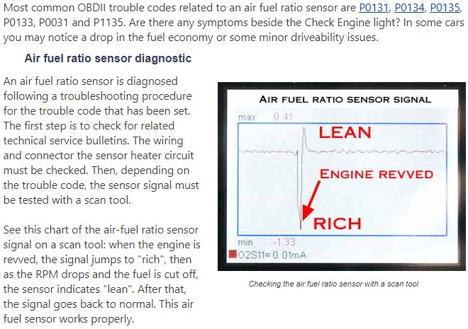

λ (O2) sensor's heater is two wires fed and the signal is returned to ECU with two wires, so it should not be sensitive to battery to boddy earthing, while A LOT of other errors and misbehavior would pop-up.
Here are some info about the λ sensors ...
BRs, Bernie

Thanks for the pinout I've been looking all over for it ? I have found oem sensor on fleabay so have ordered and will make sure its not the one I've fitted playing up ?

If on o2 sensor you removed it has two white wires,white is usually heater wires, measure resistance on those wires and post result.
A sensible check is for battery +ve feed at the o2 sensor plug on one of the heater wires with ignition on, checking fuse for heater and relay for heater working.
From the battery positive to heater pin on o2 connector? Sorry I'm just double checking don't want to blow anything up ?
