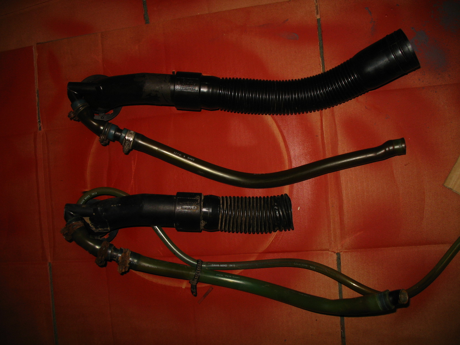

Dear all panda 4x4 users.
We all were living under constant fear of geting our precious and hard to source filler pipe damaged.
No need to be affraid any longer, if somebody will face this problem please get in touch with me as after some deep research and hours off browsing through the web, numerous contacts with manufactures and stockist i have come up with solution.
As long as your filler neck will not be damaged above middle of the corrugated it is still repairable.
An example of damaged filler neck next to good one.
The repair section is a proper fuel hose made from rubber resistant to all type of petrol, wire reinforced but pretty flexible, suitable for instalations when exposed to the elements while under the wheel arch. Supplied with Hi-Grip UK made 12mm jubille clips.
