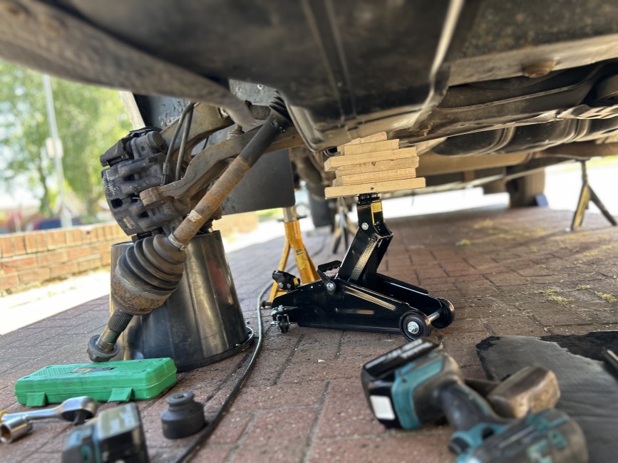

First things first, get it nice and high, I used a workshop jack and 2 sets of axle stands. Here you can see a spare jack for belt and braces as well as the stands.

Release the lower arms and get the driveshafts out the hub, I was replacing the shockers as well at the same time.
The left hand side just comes out. Remember to drain the oil out first, or it pisses all over your drive. :-(
The right hand side needs the bearing hockey sticks releasing and turning before driving it out with a chisel.
