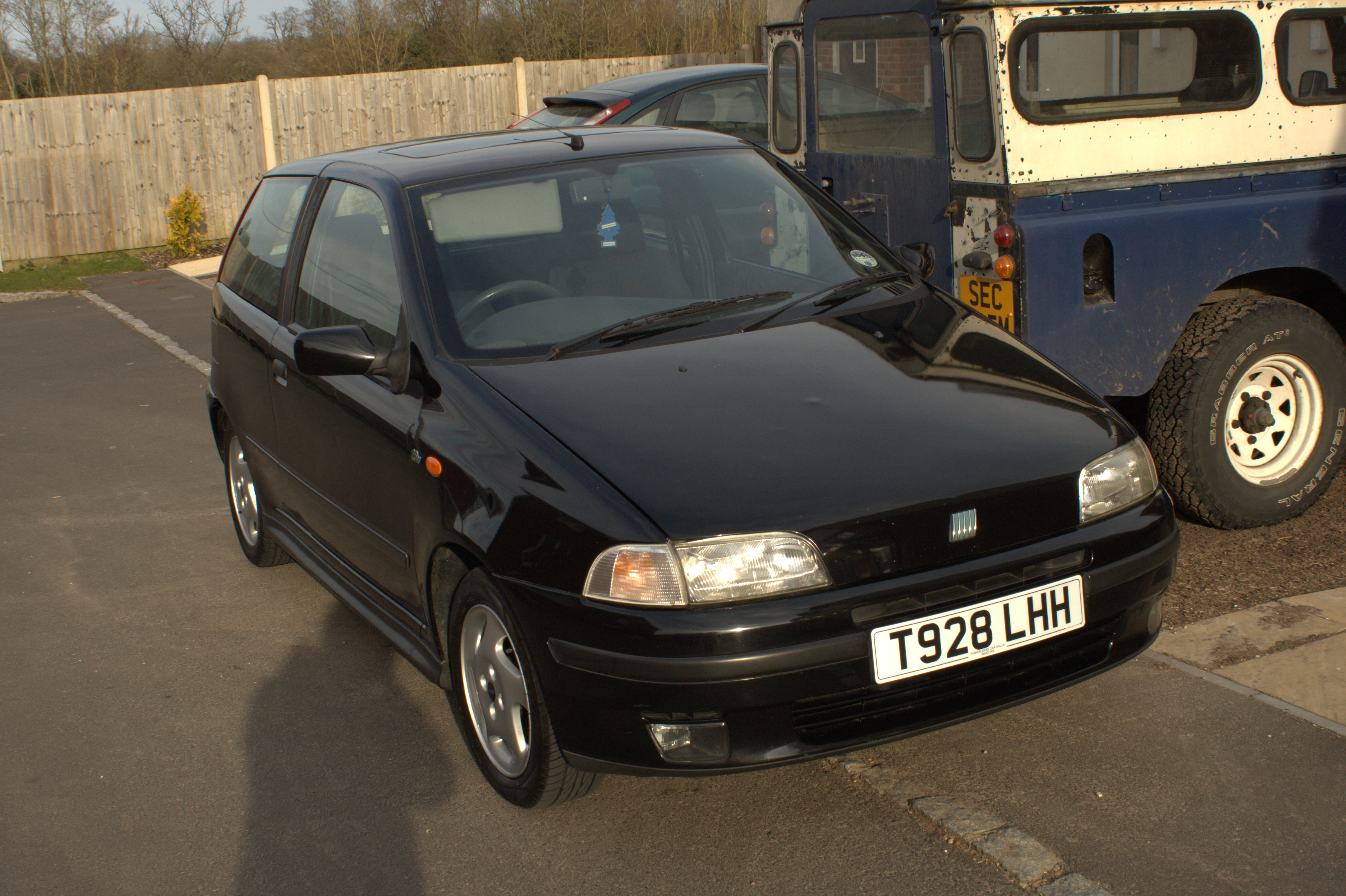

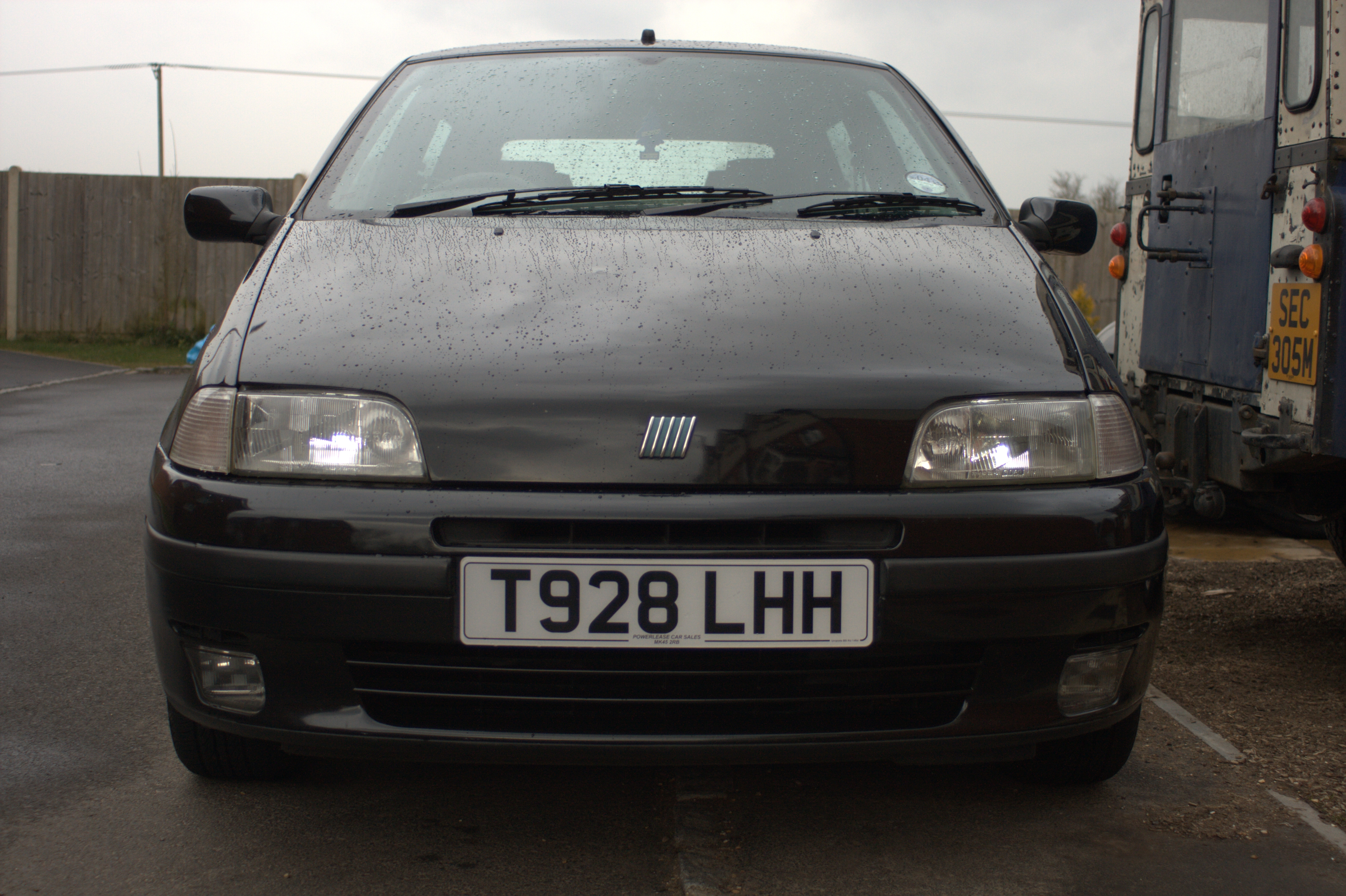

I figured it was about time that I introduced you to my little project, she is a 1.2 16v Sporting in black and I am in love. As with all cars of this age she came with a few problems but I am progressively working through them as and when time and money will allow. So before I loose your interest with endless text take a little look at her just after I brought her (note I had given her a quick clean prior to these photos as she was filthy).

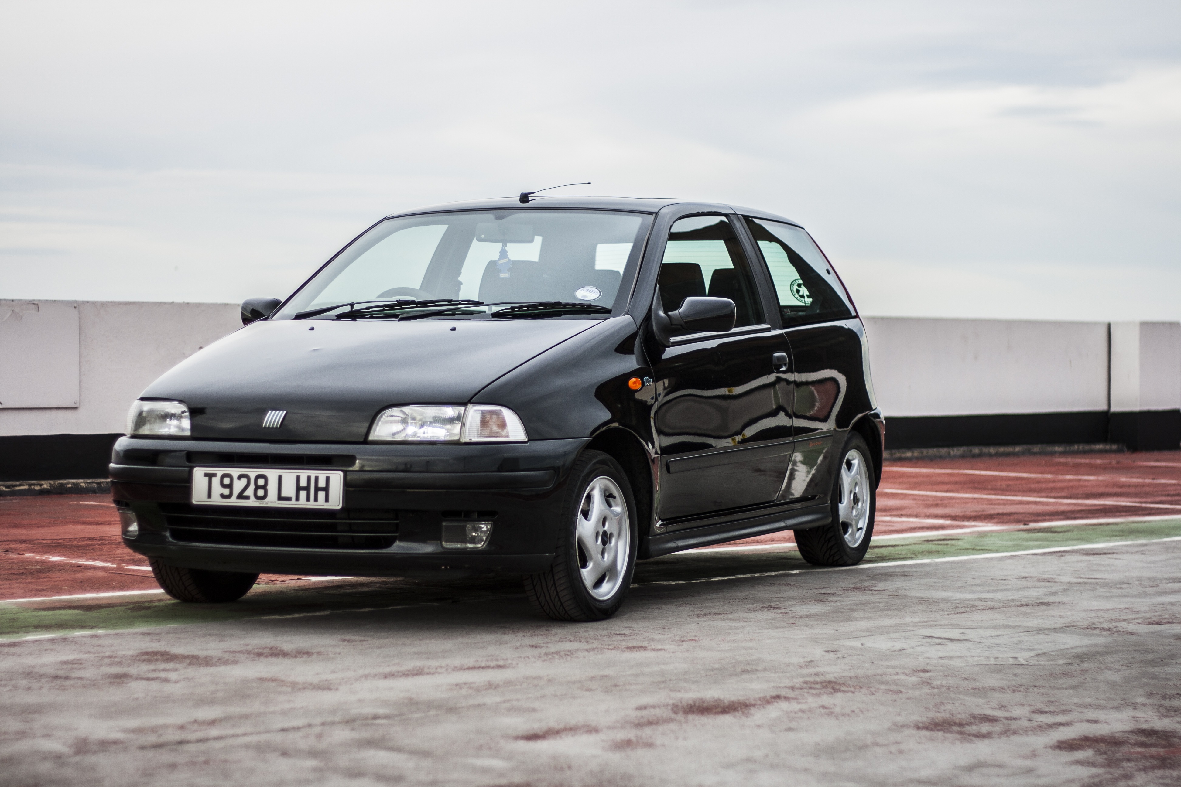

In fact this is a small example of the dirt.

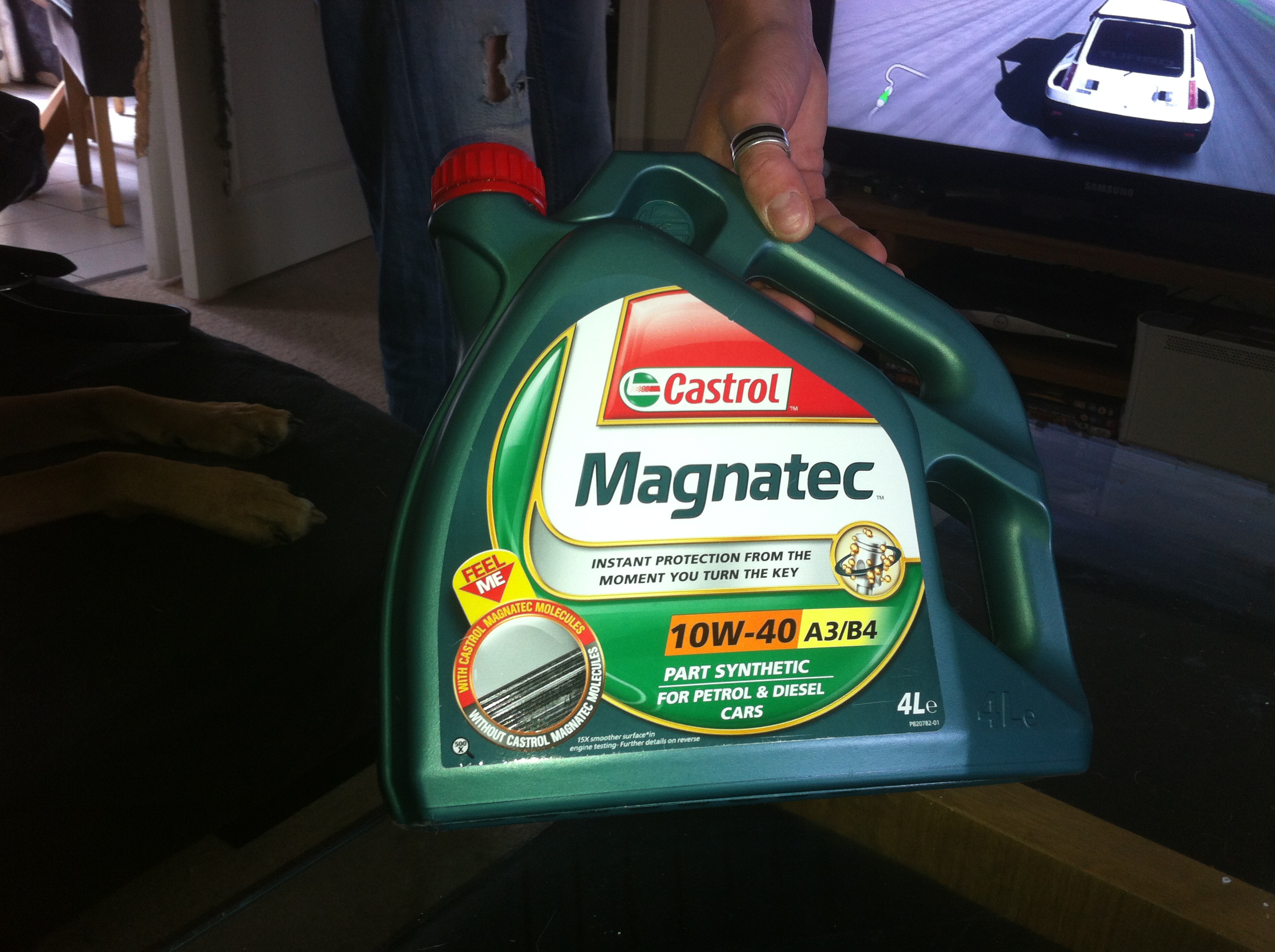

Obviously she was given a very thorough service when she came under my ownership, I'm very glad I have half a clue as when I looked at the car the oil was barely showing on the bottom of the dipstick.. Straight home, fully serviced and treated to some lovely Castrol juice.

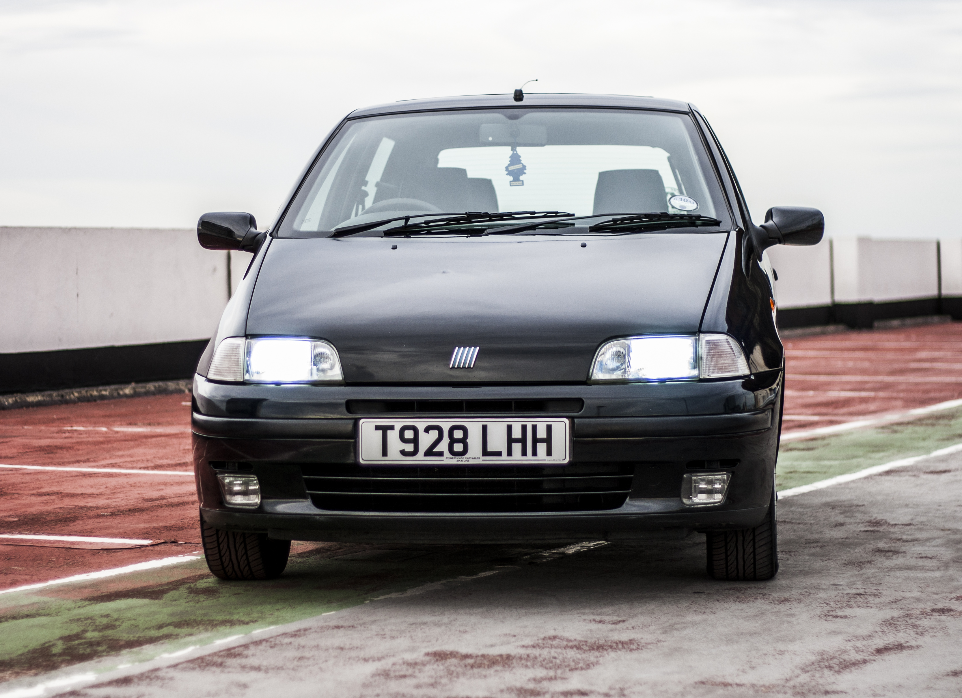

Since then I have just replaced/upgraded bits as they've gone, I recently fitted HID's when one of my bulbs died. (I know its naughty but they are very nice at night)
I also took the oppertunity to replace the sidelights with some nice white LED substitutes.

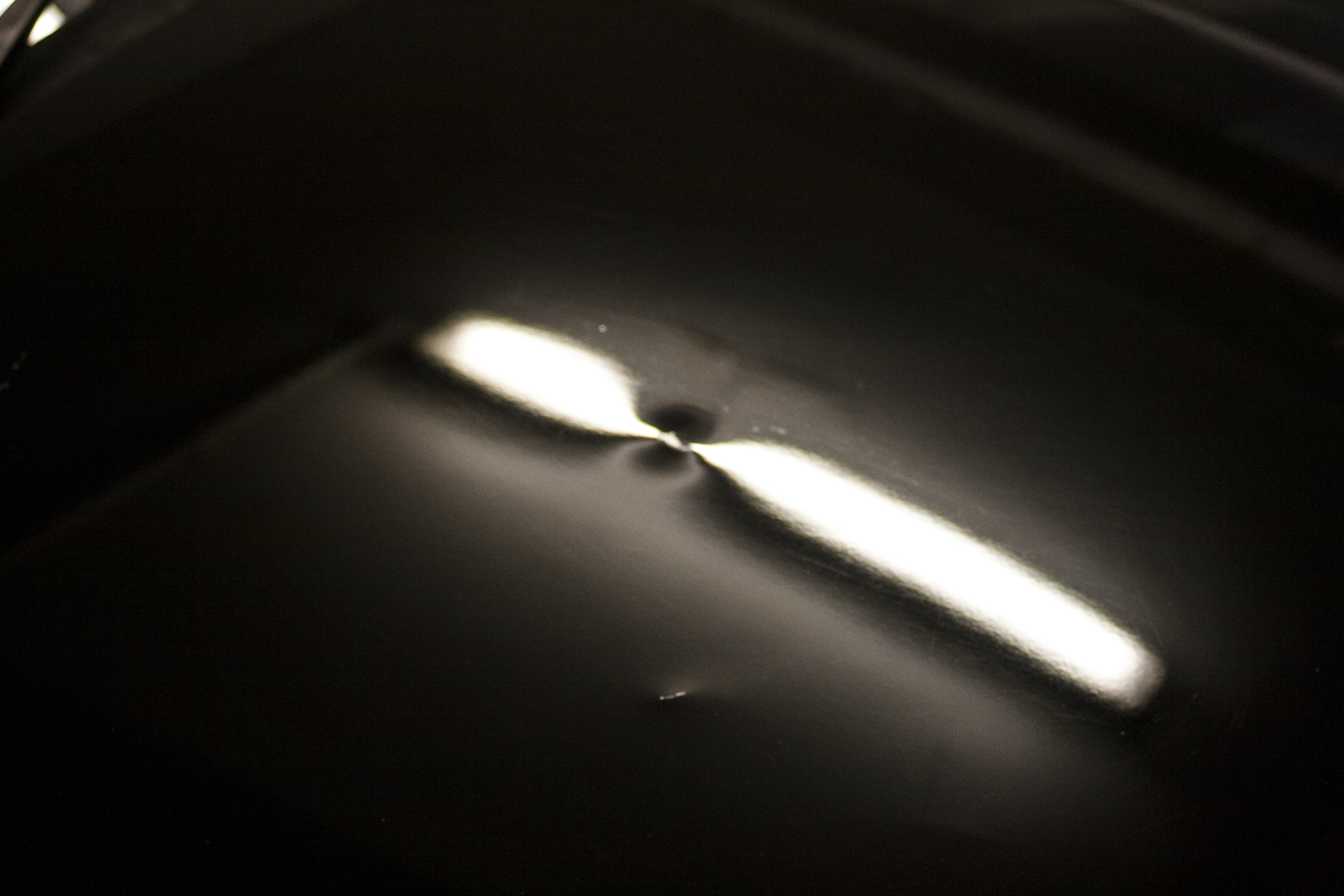

She has some lacquer peel/car wash wounds of the top of the drivers door and a ding in the bonnet as someone has clearly shut it down with a tool on top of the engine.

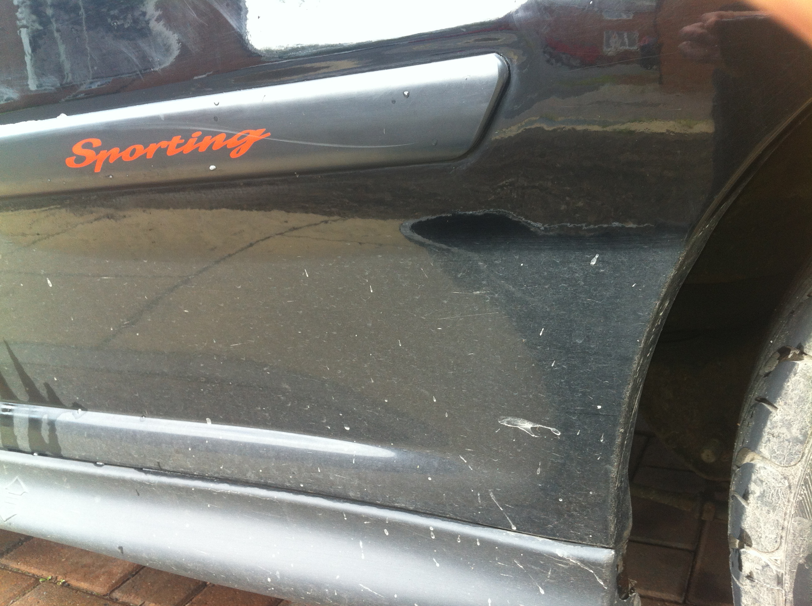

There's also a rather nice door mark down the passenger door, otherwise she is in fairly good nick and under my ownership always gleaming. I will replace the damaged panels along our journey as I plan on having her around for many years to come, even if she's not my daily drive. I'll leave you now with a snap of how she stands now and as always I look forward to your comments.
