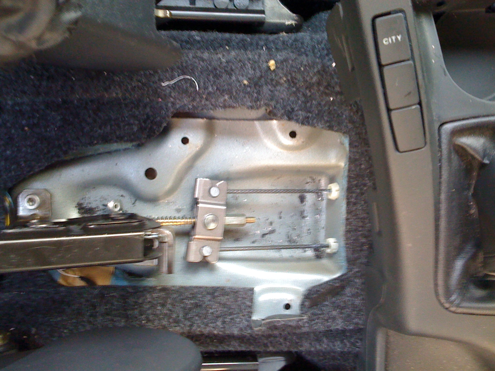

You can see the holes here, which are where the original bracket was, (bare in mind the stilos fitted with an arm rest will have had the bracket rivetted in, so you will need a chizel to remove them) these holes match up on all stilos so you just put the metal bracket over and afix.
