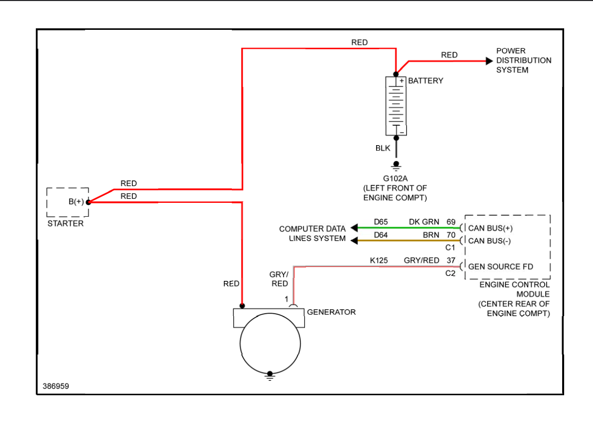

Is this a twinair?Just run it up with meter connected. Sits at 13.1V even if I throttle it.
sounds very similar to by old saab v6
According to the plug-in voltmeter I have in my TA it hits 13.9V within minutes of starting and hardly varies by more than 0.2V if I put the headlights or other load on, returning to 13.9V in short order. It's not a precision instrument (they all have a +/- error up to about 0.2V) but is consistent and is useful to monitor voltage while start/stop is operating.Just run it up with meter connected. Sits at 13.1V even if I throttle it.
I agree, it's not what I'm expecting, especially the no change when throttling it.Dont think thats enough!
That's what I was expecting.According to the plug-in voltmeter I have in my TA it hits 13.9V within minutes of starting and hardly varies by more than 0.2V if I put the headlights or other load on, returning to 13.9V in short order. It's not a precision instrument (they all have a +/- error up to about 0.2V) but is consistent and is useful to monitor voltage while start/stop is operating.
My TA has the battery sensor and stop start so I assume smart alternator (though how smart it really is I question) It shows the same 14.4 when running as the older cars do. Batteries at rest settle at 13.3 on all three at the moment but the TA is 4 and the other cars batteries are just a year old. The 4 year old battery is clearly aging as when left it drops to 12.8 after a week or 10 days. MES allows you to see what the car sees and to compare the ECU voltage to the battery voltage which may help.Is this a twinair?
Do they not have smart alternators they only charge at higher voltages on the "overrun"
E.g when slowing down in gear
Not really, I have a degree in electrical engineering, so just getting started. Finding a decent circuit diagram is proving to be quite a challenge, you know one that says exactly what model(s) & year(s) it covers.... Have I mentioned I HATE electrics (spect you do to by now!) feeling your pain on this! but encourage you to press on!....
