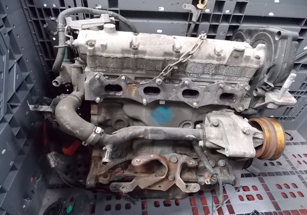

Think yours is a 1.6 Nik ?
This is the only picture I can find of the back. Looks like there are several places a leak could come from:
Head Gasket.
Water pump seal.
Water pump gasket where it fixes to the engine block.
Water pump to metal pipe gasket.
Metal pipe corroded.
One or both rubber pipes to the metal pipe.
One or both of the core plugs.
