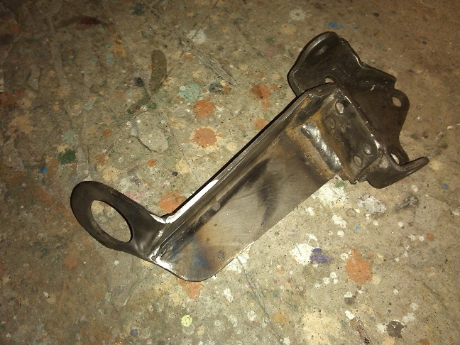

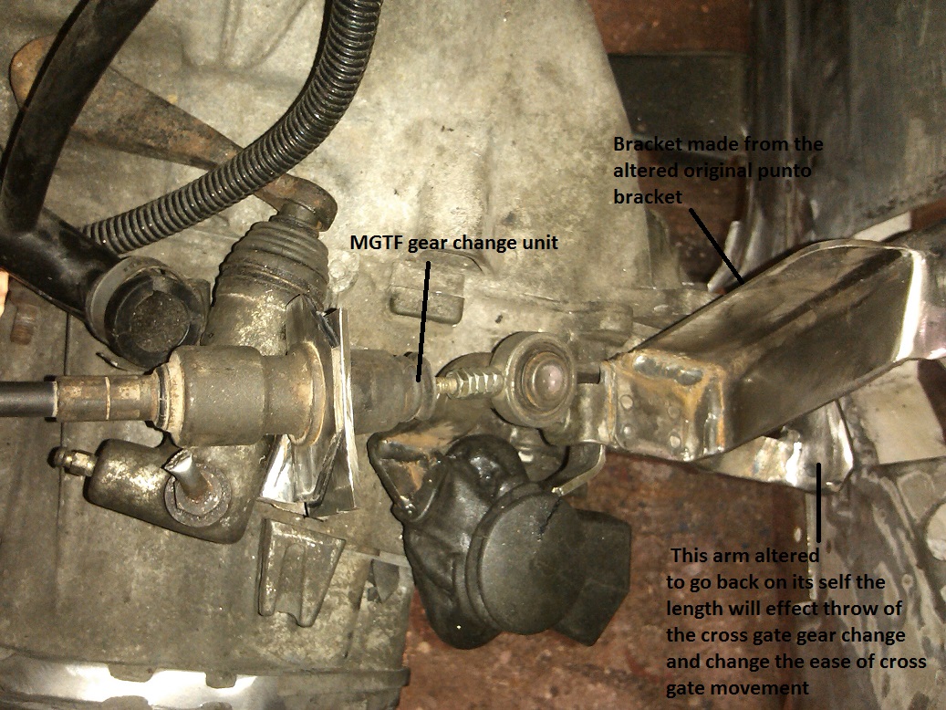

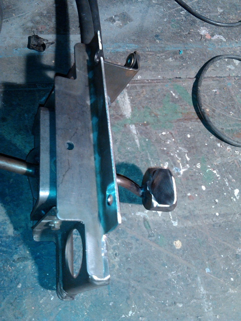

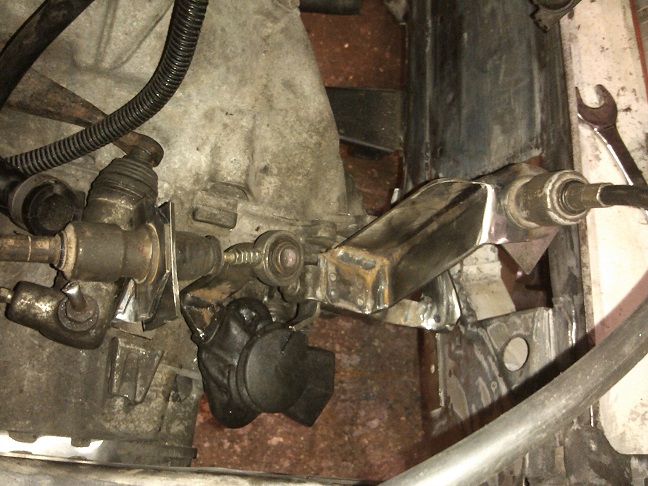

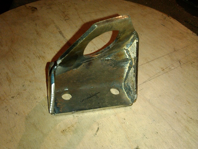

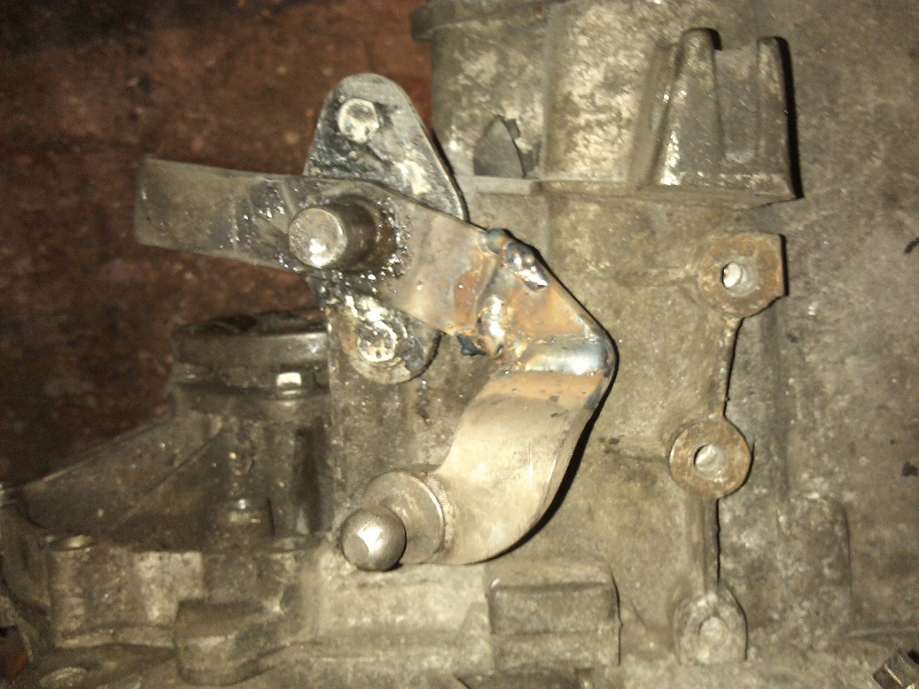

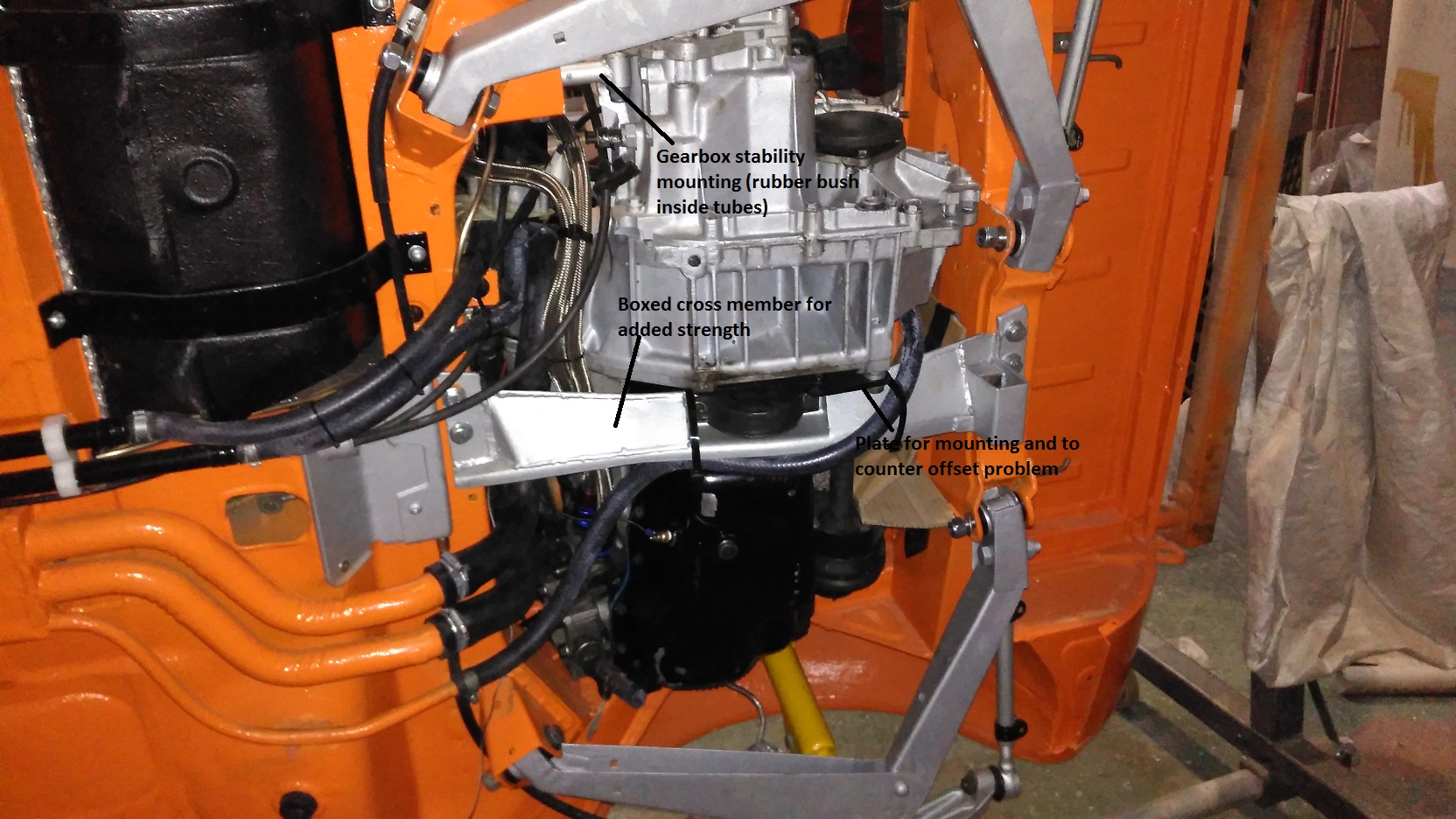

Here's some more pictures that will hopefully help you out.
The cable change is from a MGTF I welded some 25mmx6mm flat steel onto the x body with holes tapped to suite the cable change body, I cant remember if I had to modify the assembly slightly or not but if I did it wasn't by much but the one thing I did was cut the bottom ballast weight down as it was very wide and I wanted plenty of room left in the tunnel.
I altered the arms of the original gearbox change mechanism so that they worked in the correct orientation for the cables as shown in the pictures, A little care will be required to make sure that you keep the angle of the cable mechanism in a straight line to the modified arms so you are not getting extra resistance to overcome.

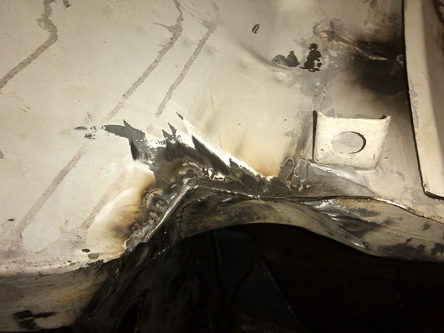

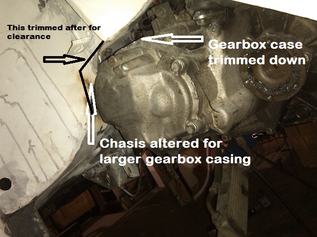

I found that the gearbox case needed to be trimmed down and the bodywork altered very slightly to accommodate the gearbox as it is slightly bigger, I cut and welded my bodywork to suite but you may find you don't even need to do this.
A plate was fabricated to fit to from the gearbox to cross member engine support as only 2 holes lined up and there was an offset of around 10mm and the cross member was also boxed in for strength and a gearbox stabilizer added
I have added some descriptions on the pictures to hopefully make things easier to understand and i'm sorry I don't have better pictures of everything.
