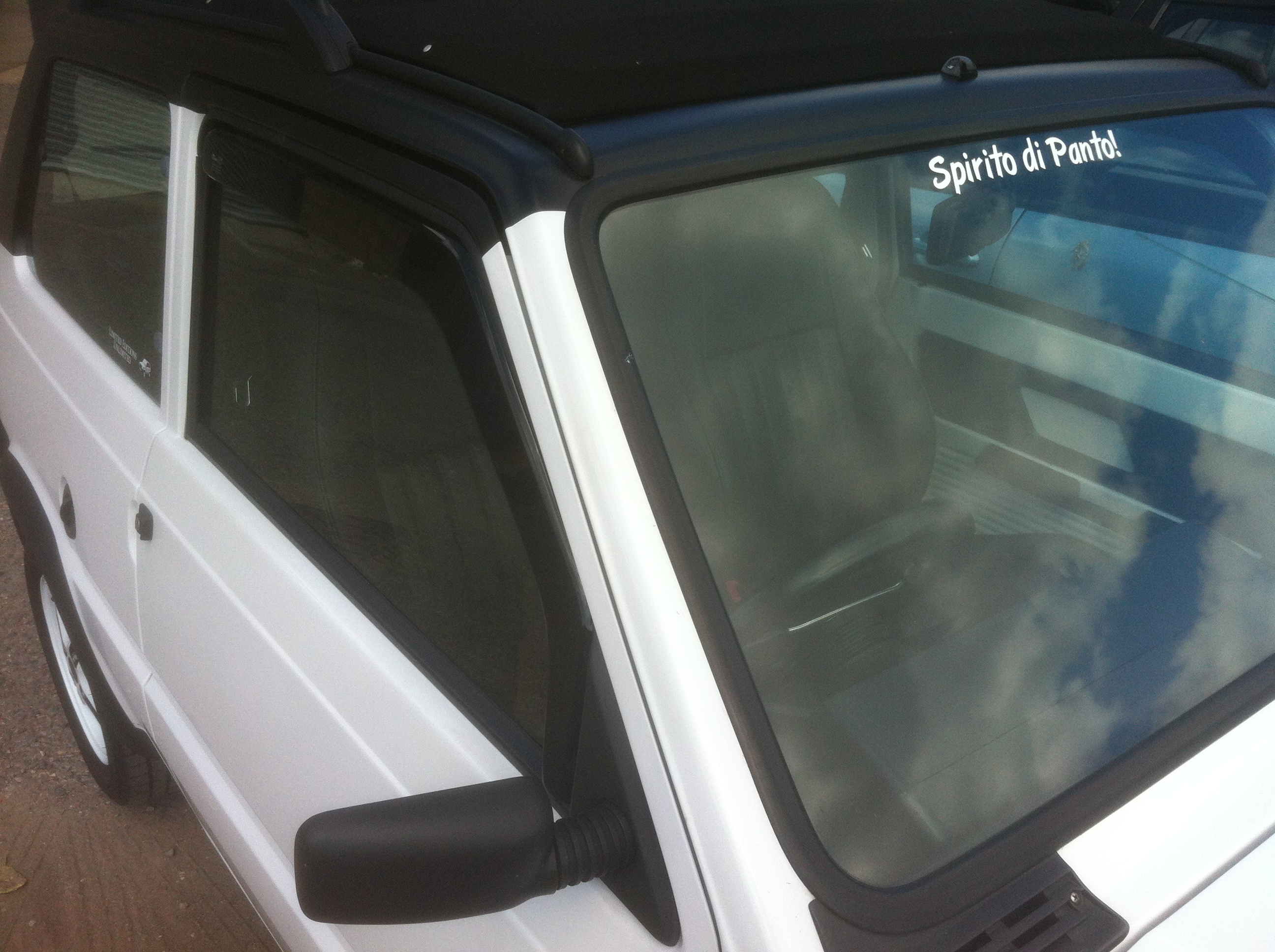

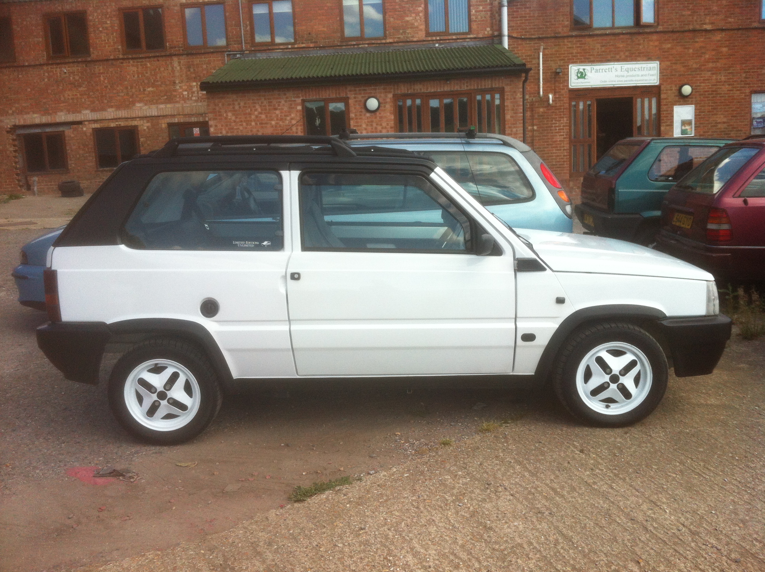

It was decided that Panto may suit those wind deflectors that seem to be getting popular on Pandas so I fitted a spare set I had..........
I think it looks fine with or without, so it's down to practical reasons for me, and as I've chosen to have them on the Blue clx I guess I'd keep them. Gavin, the choice is yours.

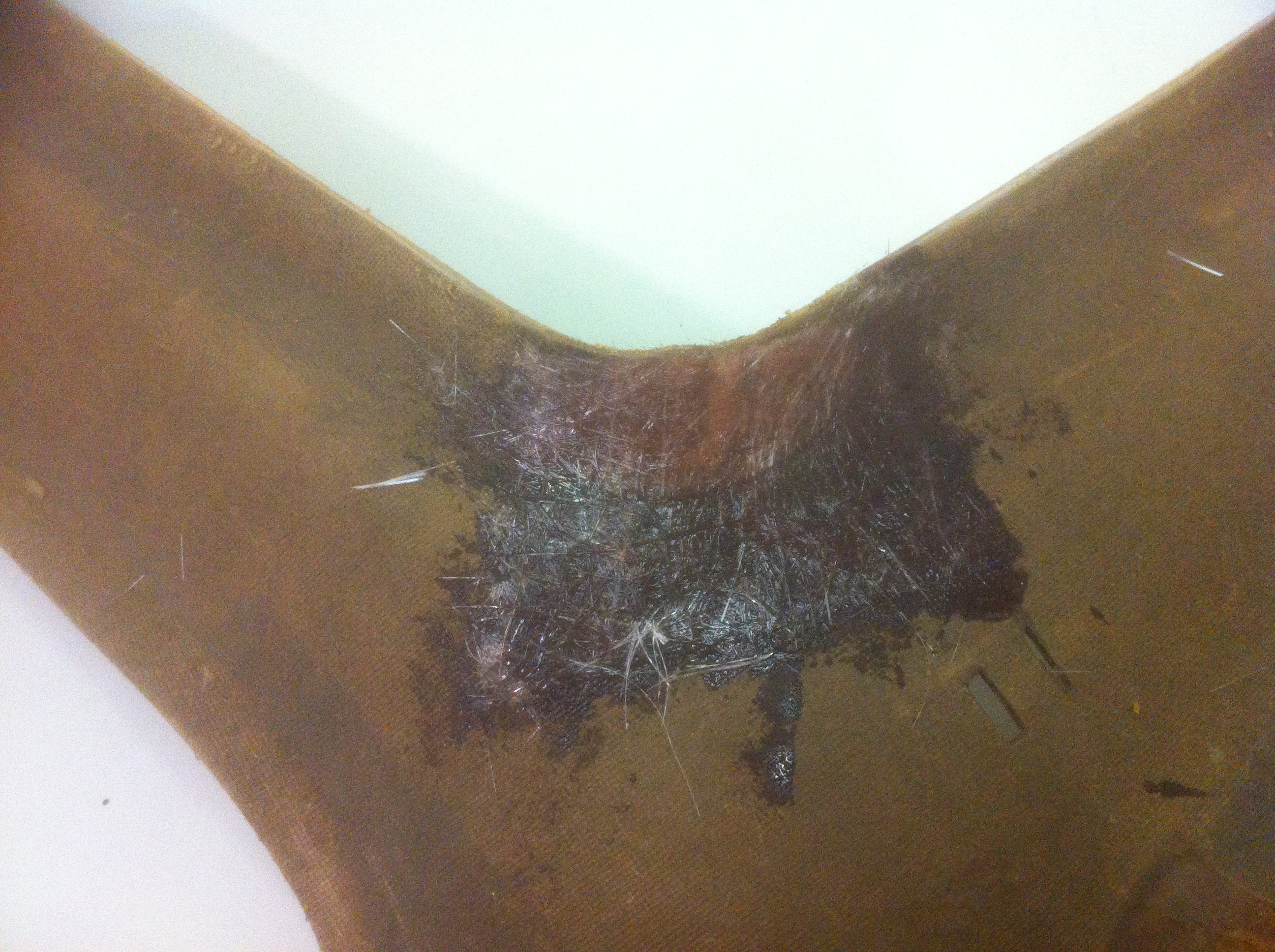

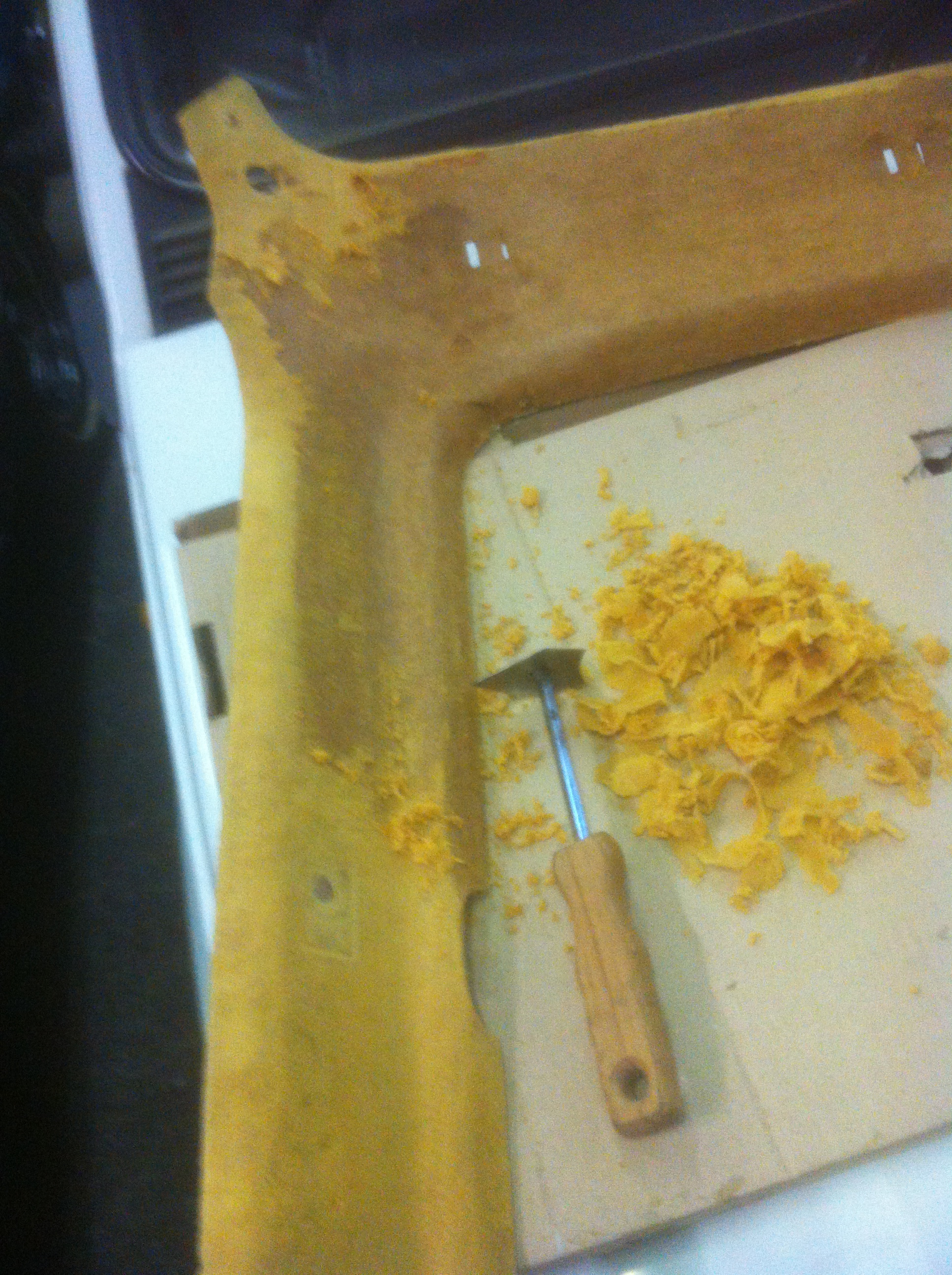

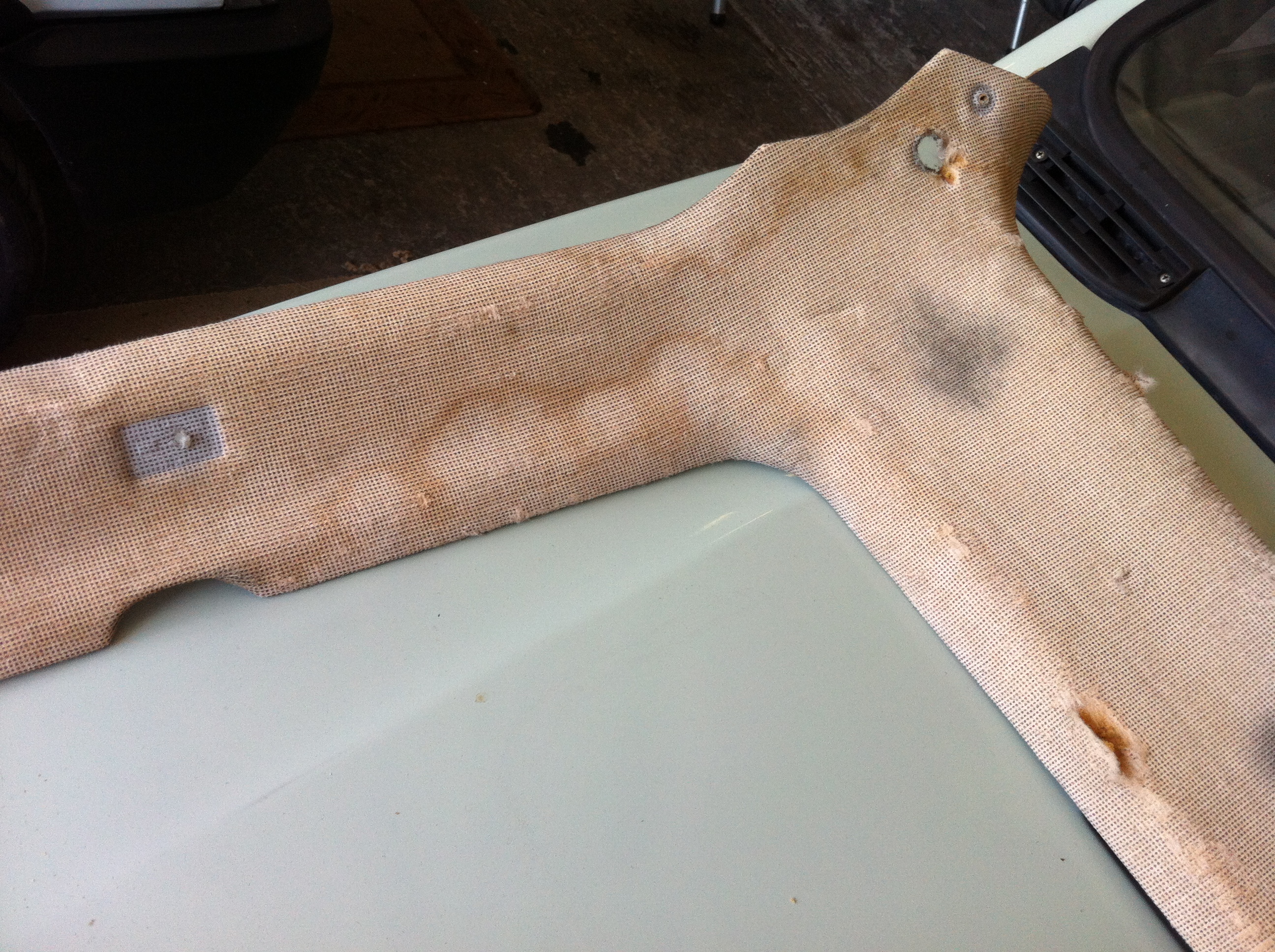

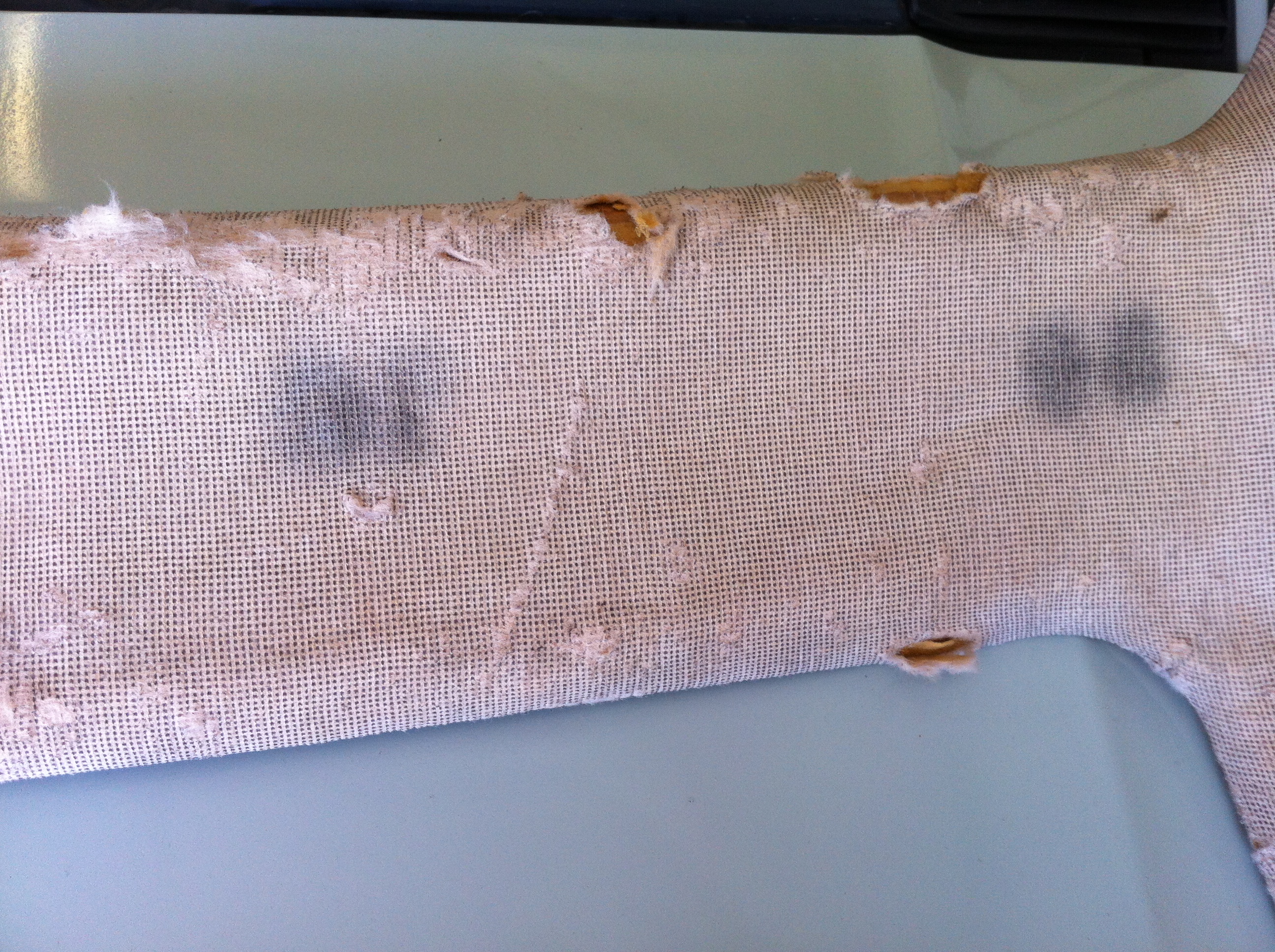

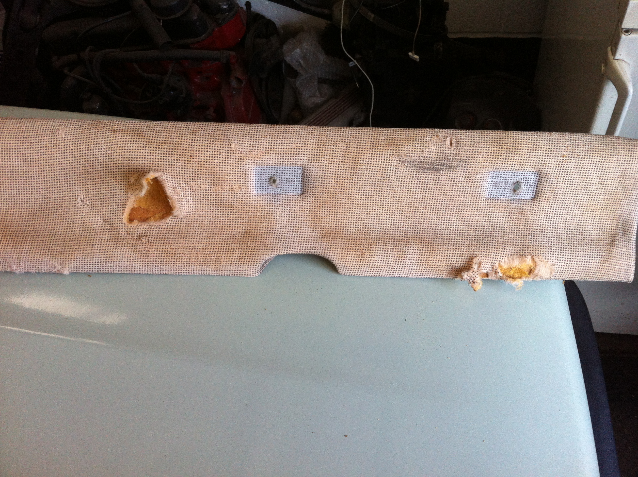

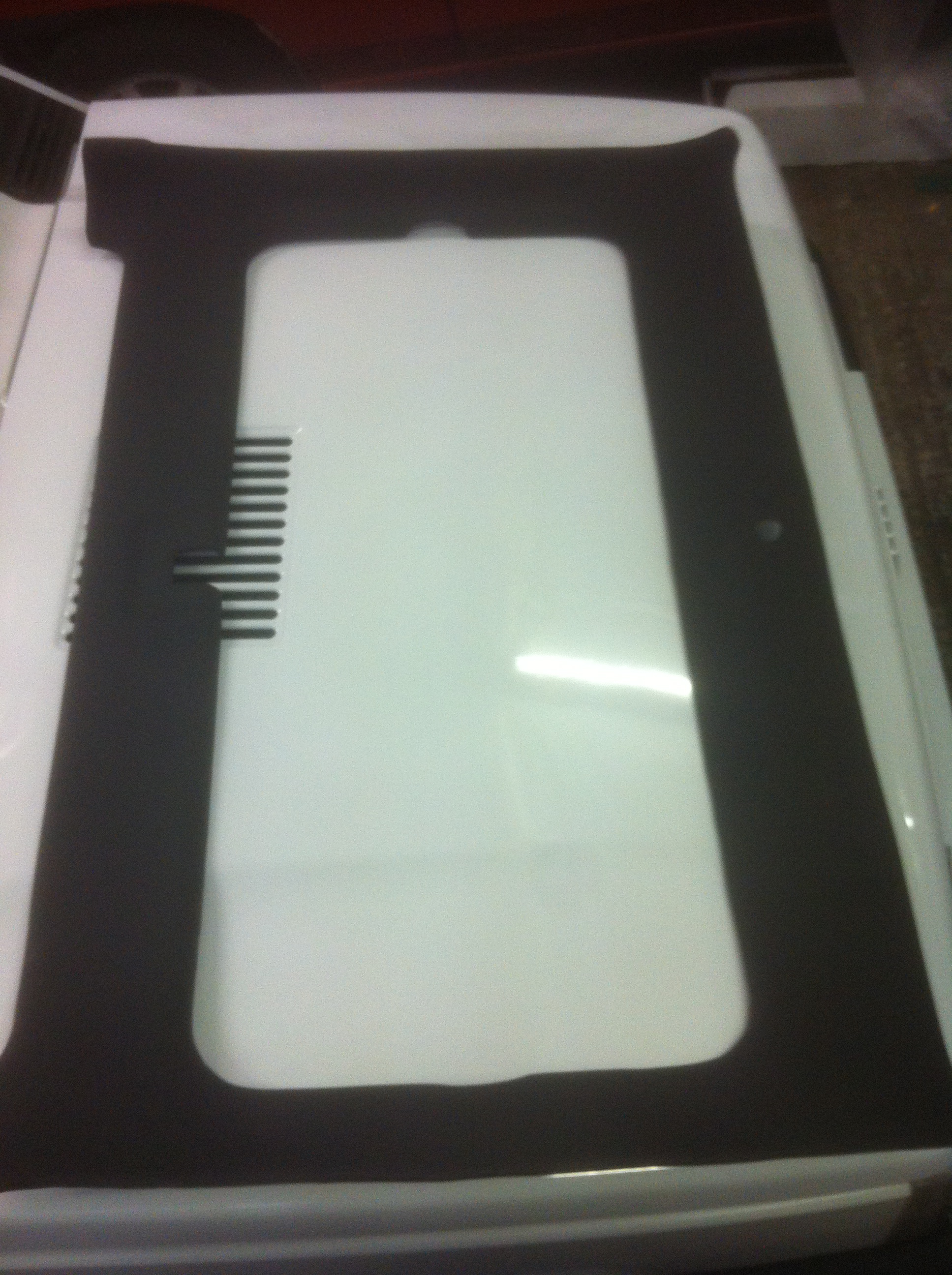

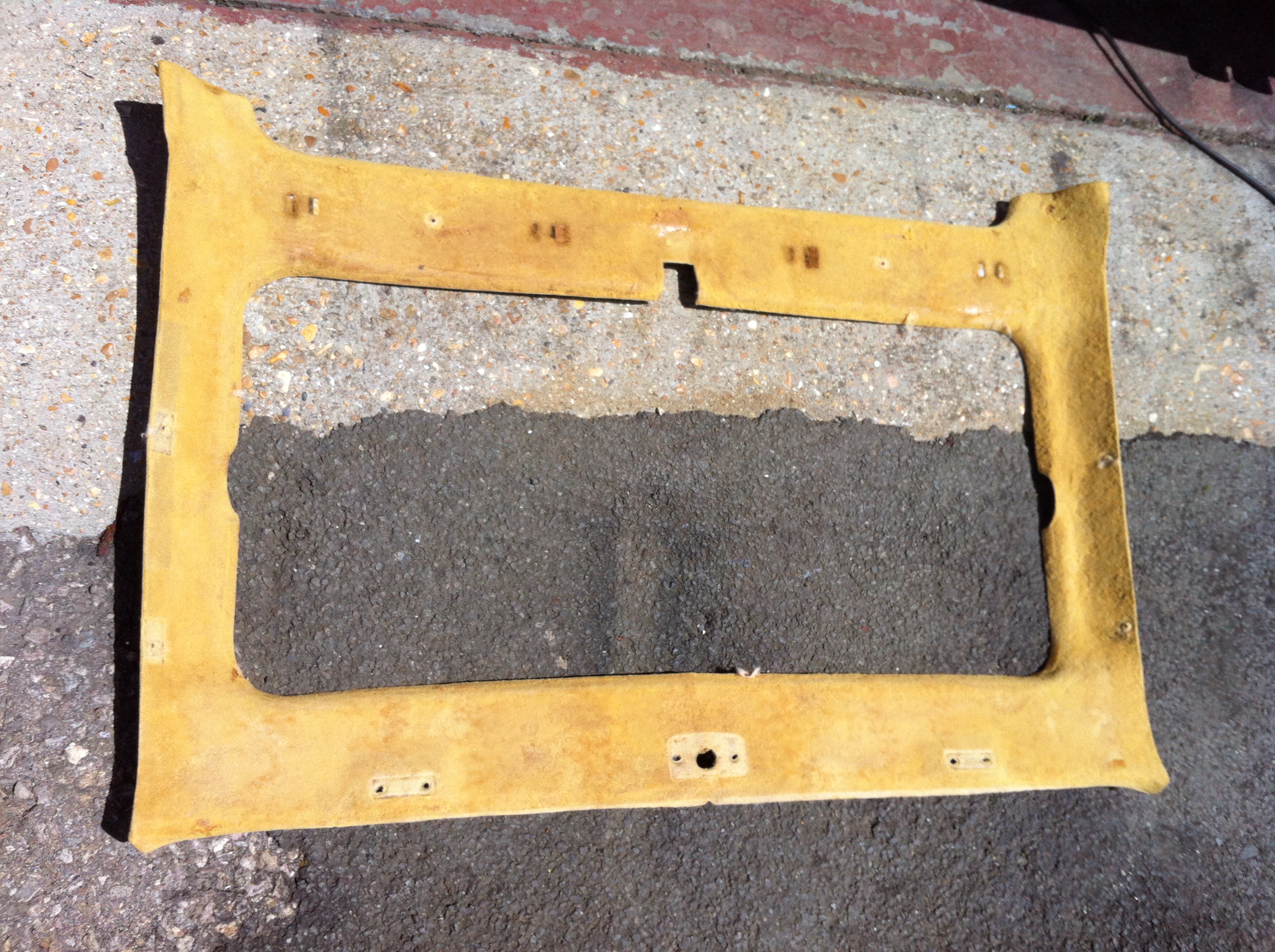

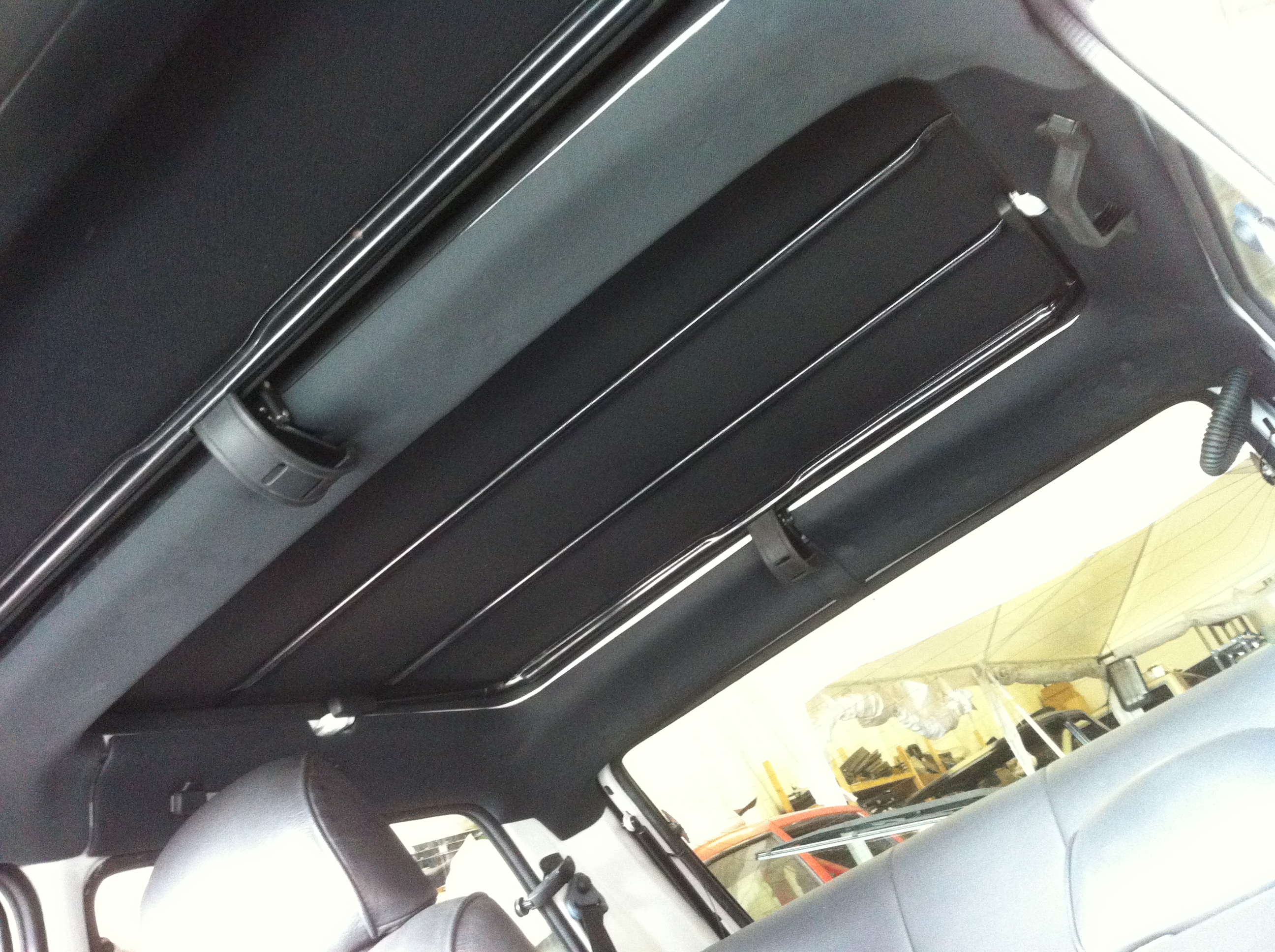

I've also been revamping the roof lining, which on the twin sunnies comes in two sections. The original covering was pretty grotty so would have needed replacing anyway, but as the underside of the sunroofs is black the roof lining needed to be the same.
As you can see from the pics, before I could fit the new material I had to scrape off all the old foam and make a couple of repairs with fibre glass. The new material is the same as that used for the dashboard and is much blacker than it looks in the pics.

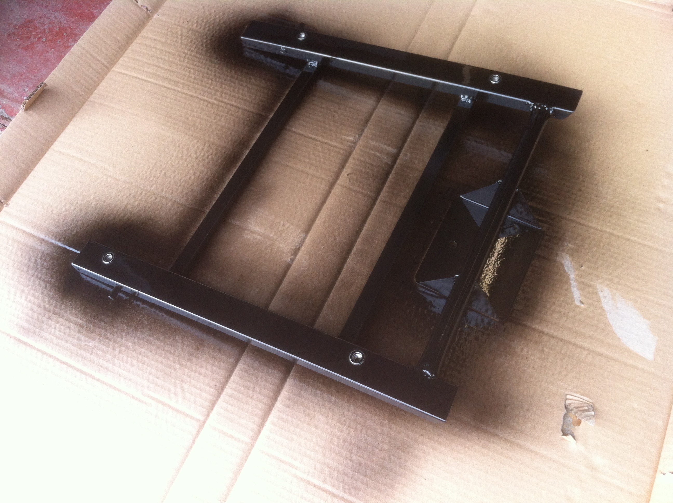

The Alfa seats don't have height adjustment on the passenger seat and the height it's set at is about an inch higher than the drivers seat at its lowest setting. Now in Panto the drivers seat is best set at the lowest setting for most drivers, certainly for Gavin and myself, and as a result the front seats are always out of align. Also, the passenger seat was too high for most passengers anyway, leaving their heads touching the sunroof. I wasn't happy to leave things this way so decided to make another, slimmer, subframe that evens things up..........
It worked very well so will be my design for Alfa seats from now on. This one has an additional cross bar because I wanted to mount the stereo's amp on it, unfortunately the amp was too big and fouled on the seat adjust bar (back/forward) when the seat was moved back. I still think it's a good location for an amp so will be looking for a smaller one.

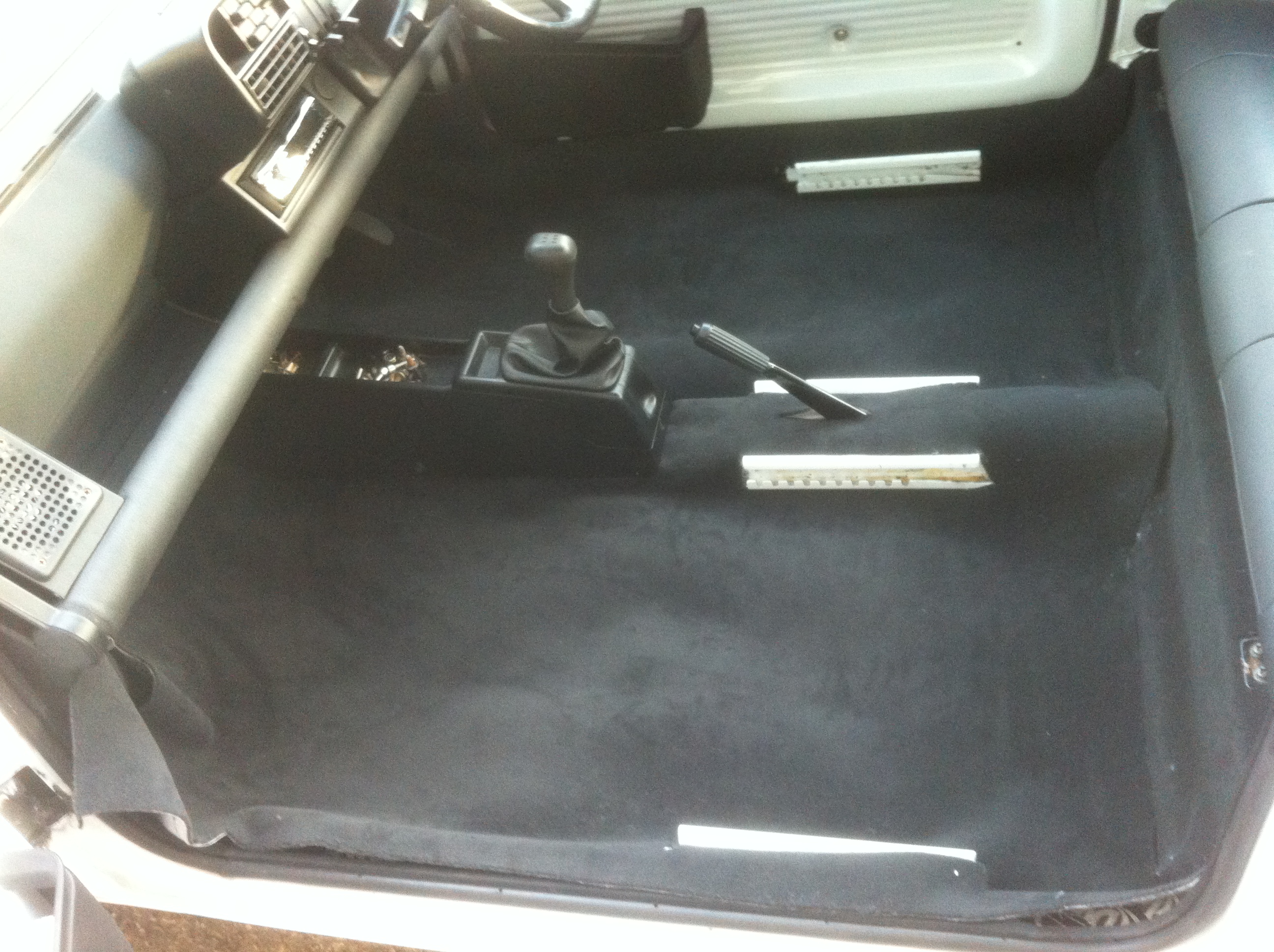

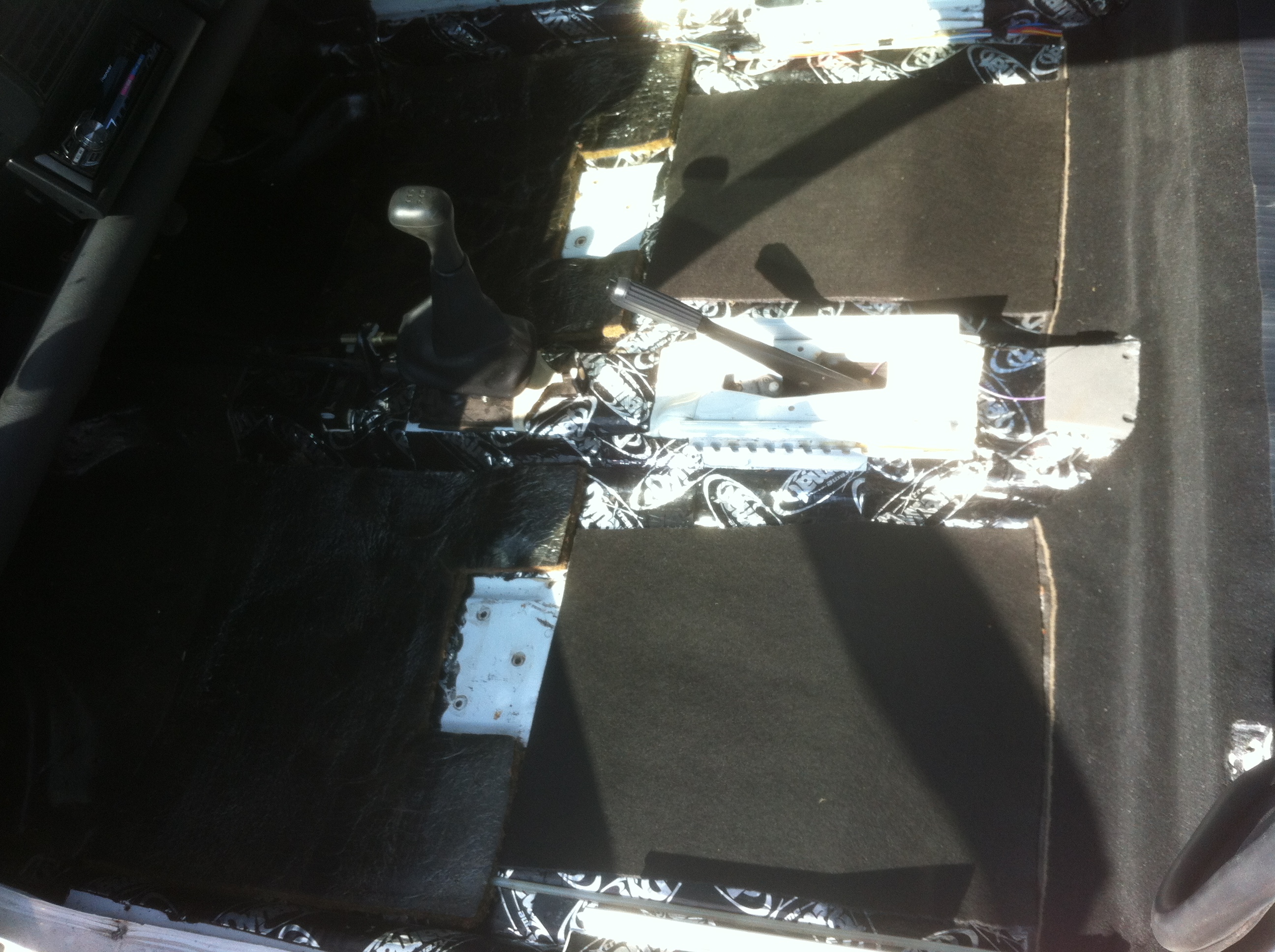

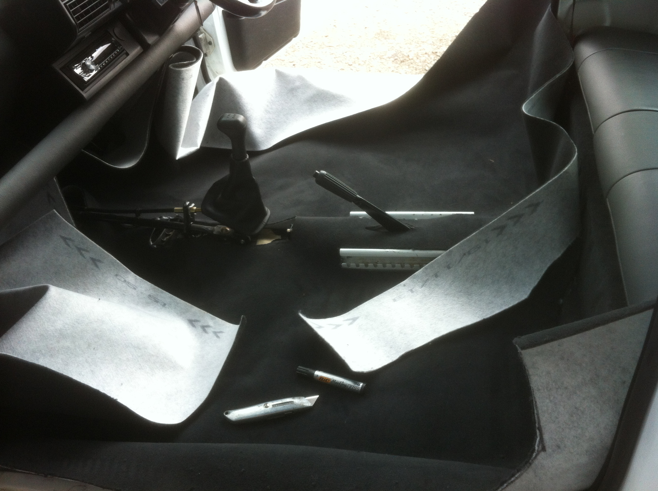

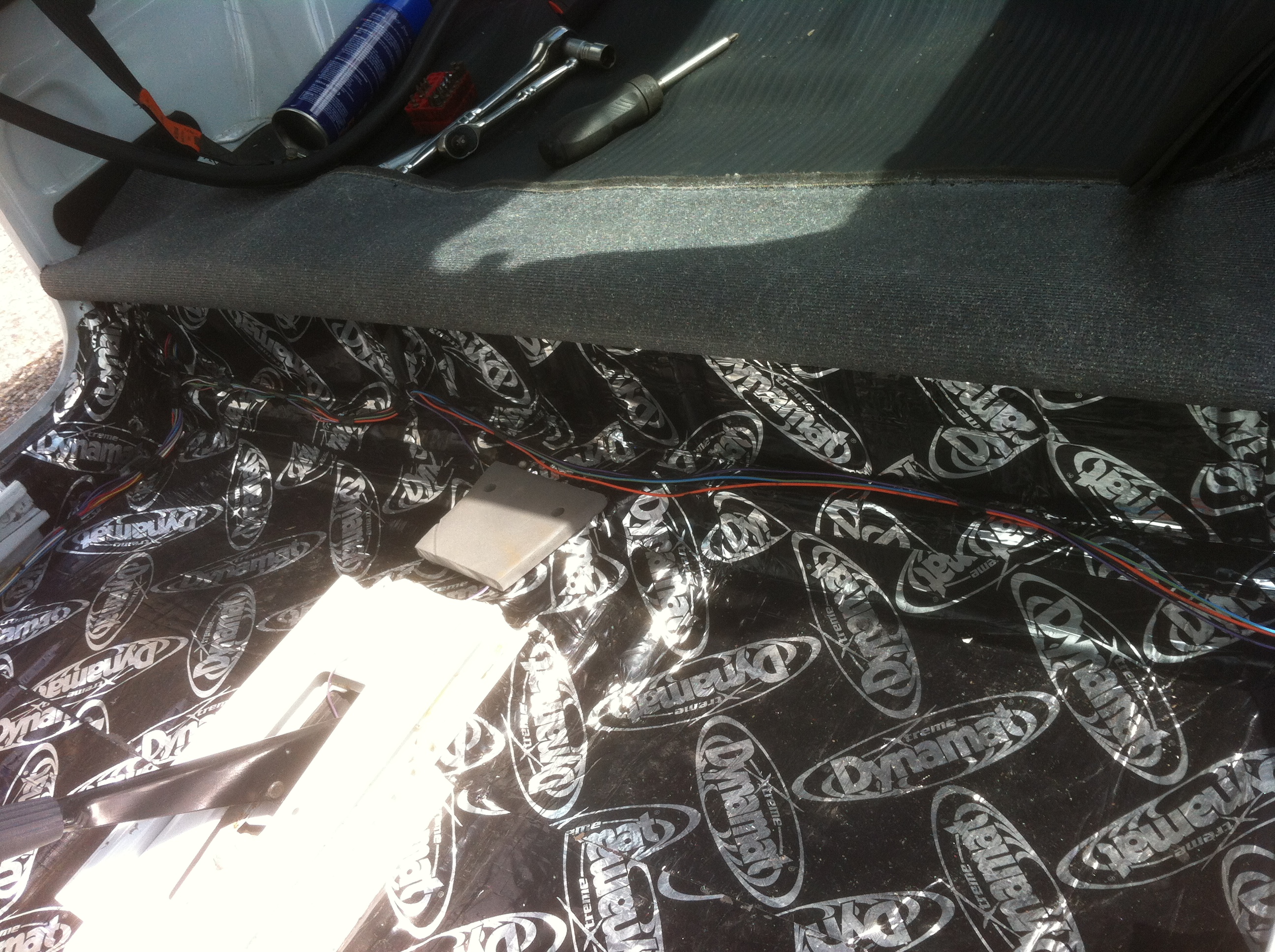

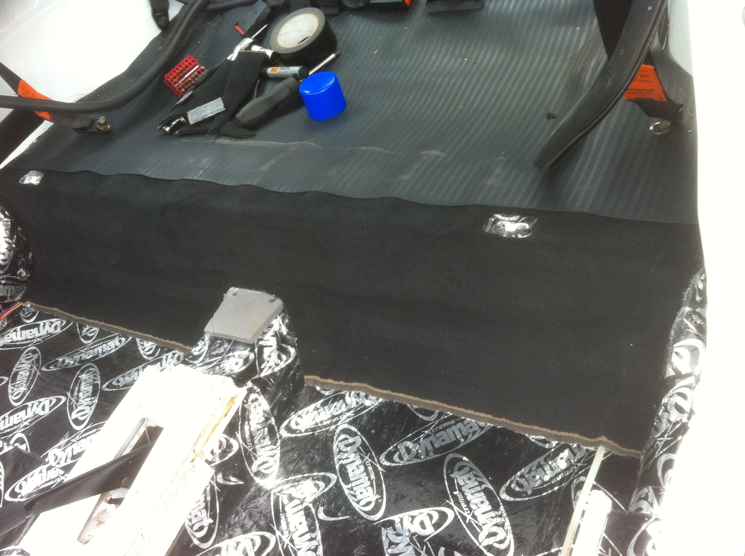

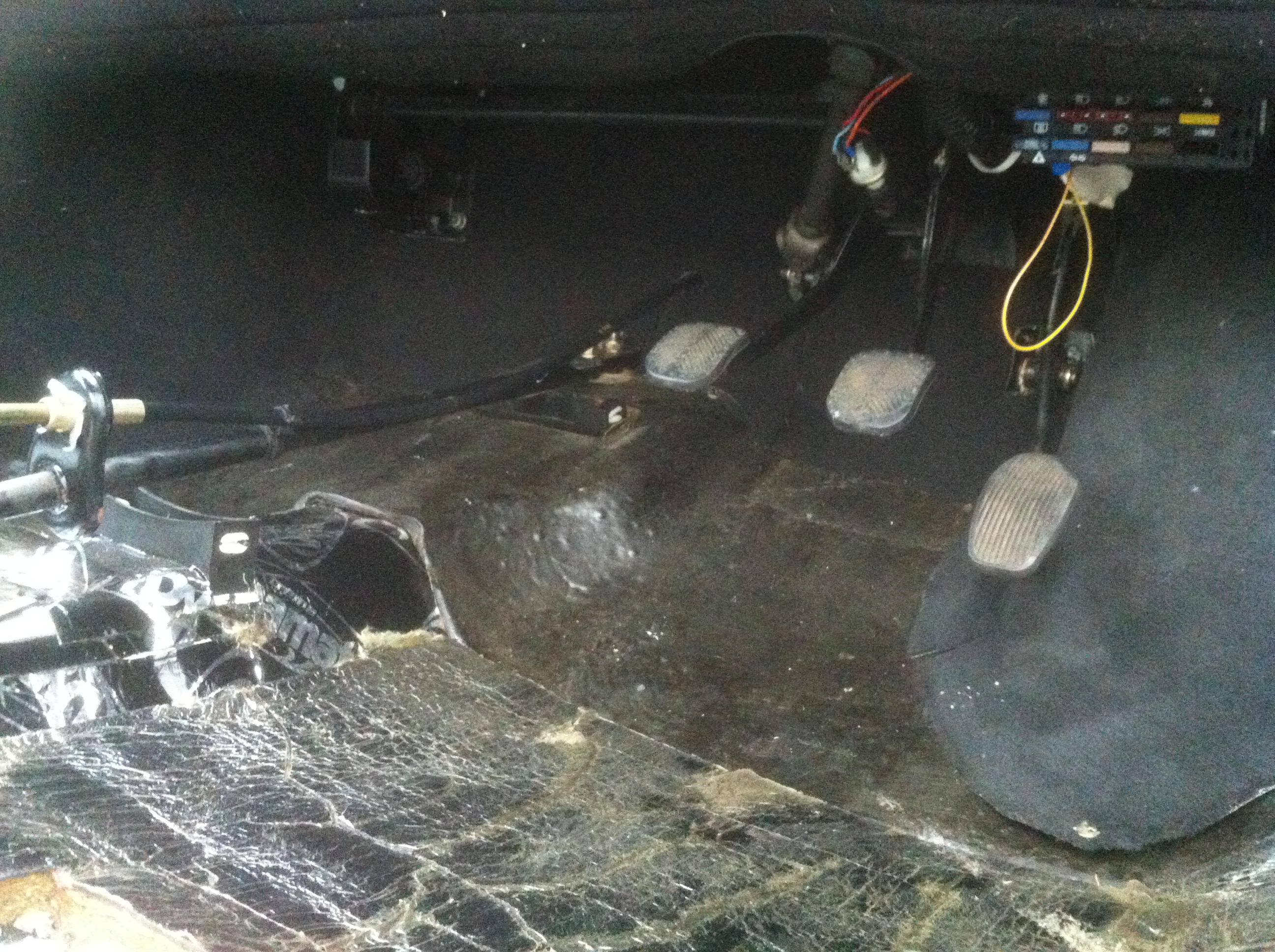

And so to the carpet.*
As the passenger seat was coming out anyway it was a good time to fit the new carpet, so out came the rest of the seats and the old grey carpet.......
I had two pieces of carpet. One was thin and more flexible for around the sides, then a thicker felt backed piece for the floor which should give better sound proofing.
I did add some extra sound proofing too, doesn't show up too well in the pic because of the shadows....
Carpet, particularly the felt backed, is a real pain as it doesn't do compound curves but I did get there in the end......

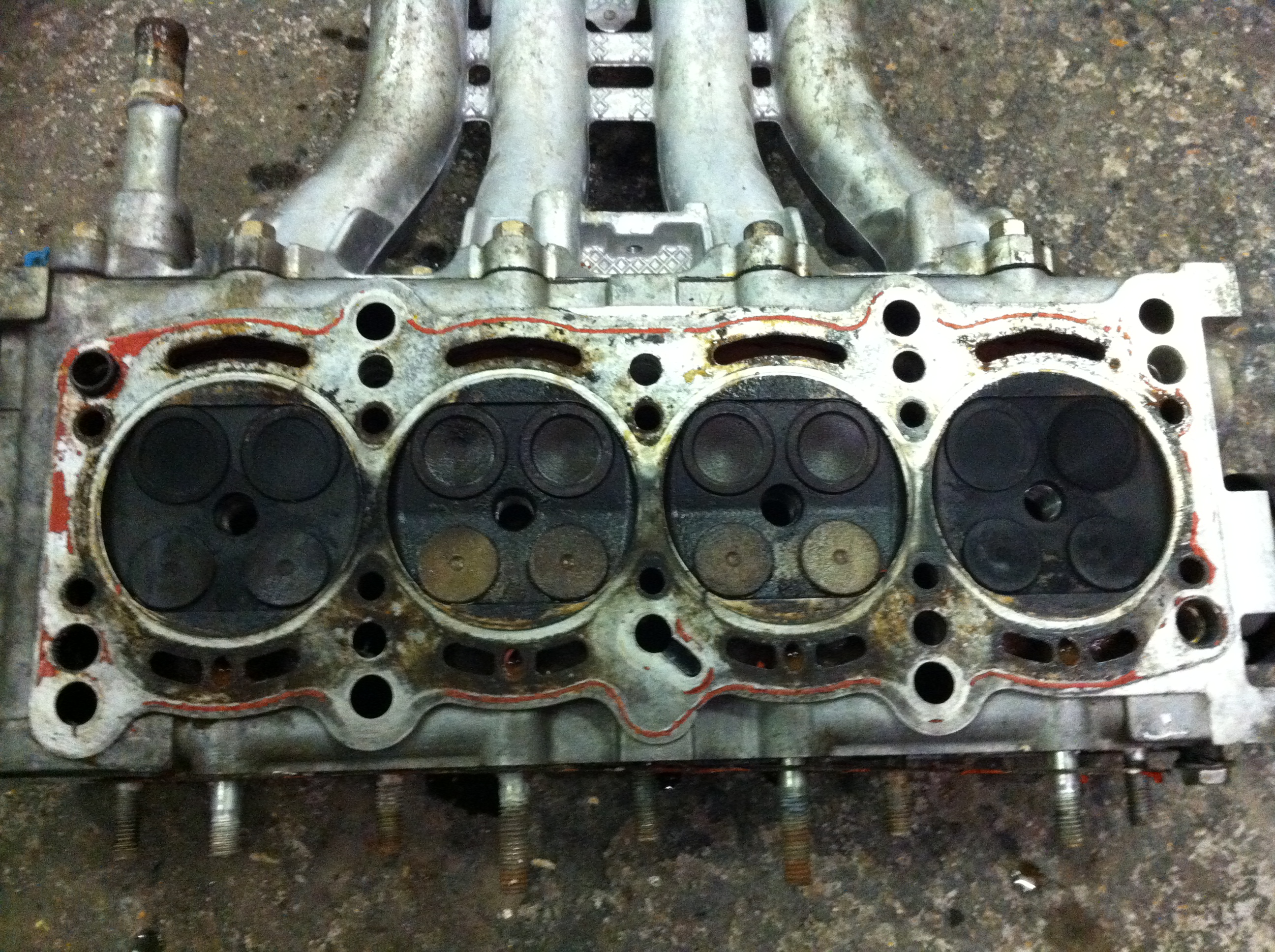

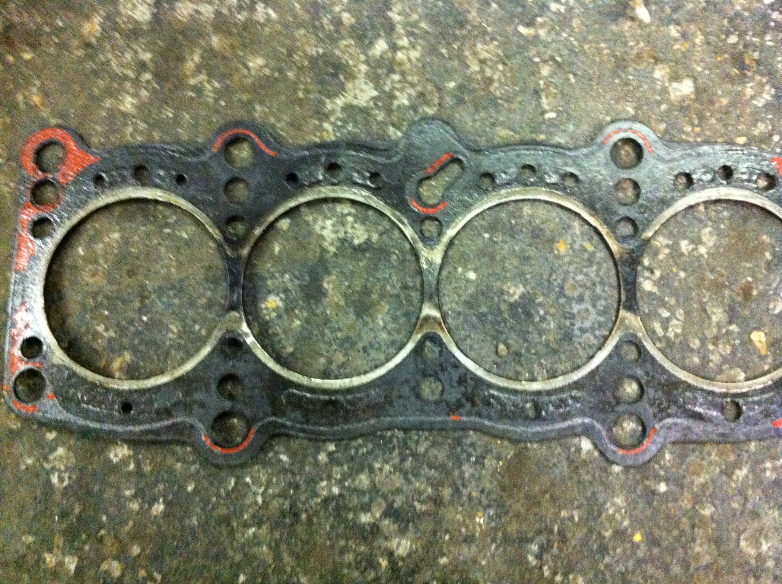

When we removed the head we found this.......

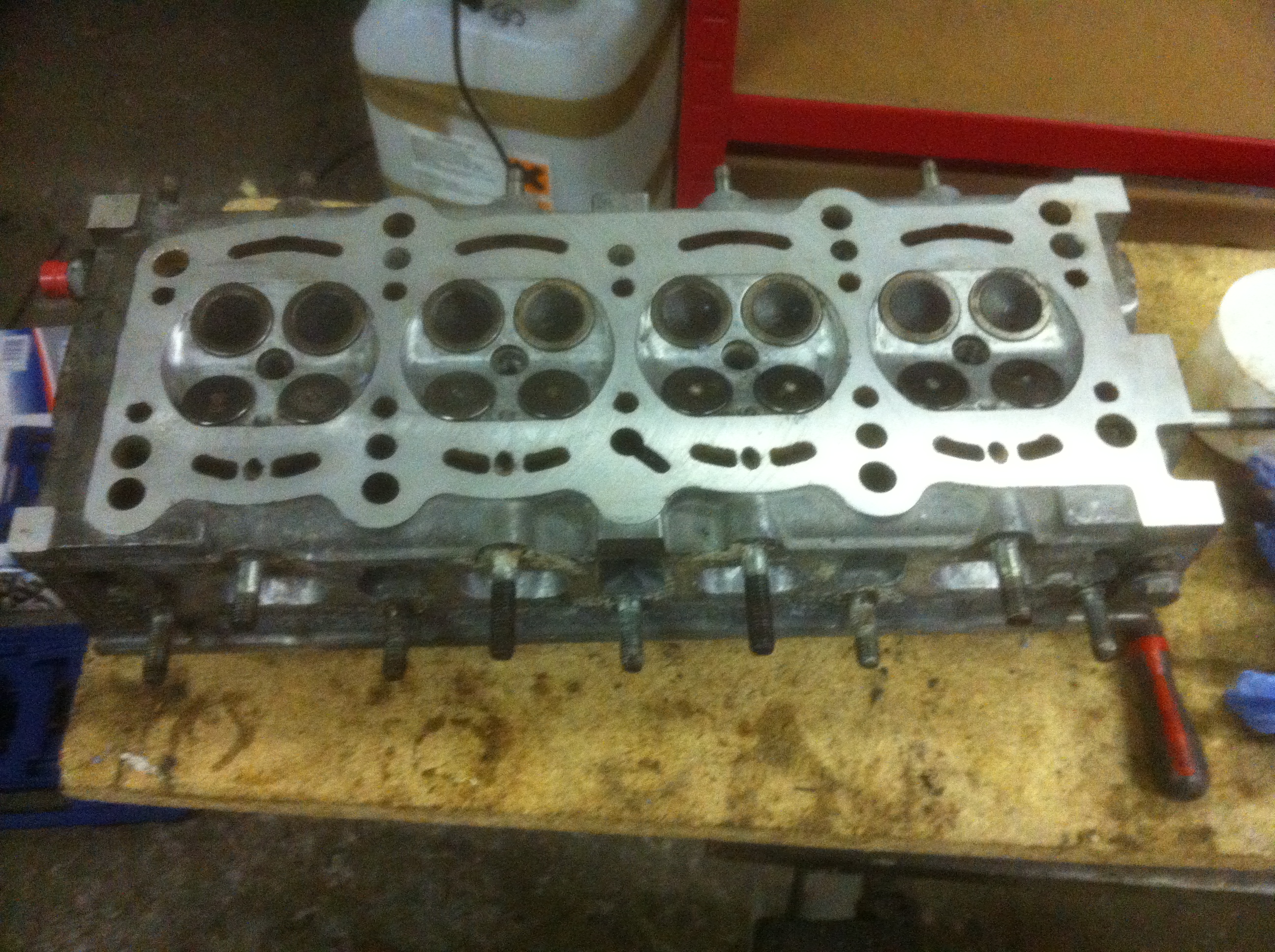

It may not be too obvious from the pics but what we found was a blow around the central area. We diagnosed at Mitcar that cyls. 2 and 3 were the problem areas, this just confirms it. The machine shop I took the head to found there to be a slight bow in the head of 5 thou so this was machined off to make it flat again.
The valves had to be removed to allow for the machining to be carried out, this is when 16v heads become less appealing :rolleyes:. At least it allowed us to fit new valve stem oil seals. Panto had always smoked a little on overrun which led me to suspect the seals were worn so it was good to replace them, although the smoking could have been burning waterless coolant because of the head gasket, but the coolant level never went down during this time so I guess we'll never know. Anyway he doesn't smoke now and that's what matters.
While the head was apart we kept the hydraulic tappets submerged in oil as you're supposed to, but still they took ages to pump up once the engine had started. The first time we ran the engine they didn't pump up at all causing me to remove them again and try to prime them by hand. When refitted they were still noisy but we went for a long run and finally they quietened down. :bang:

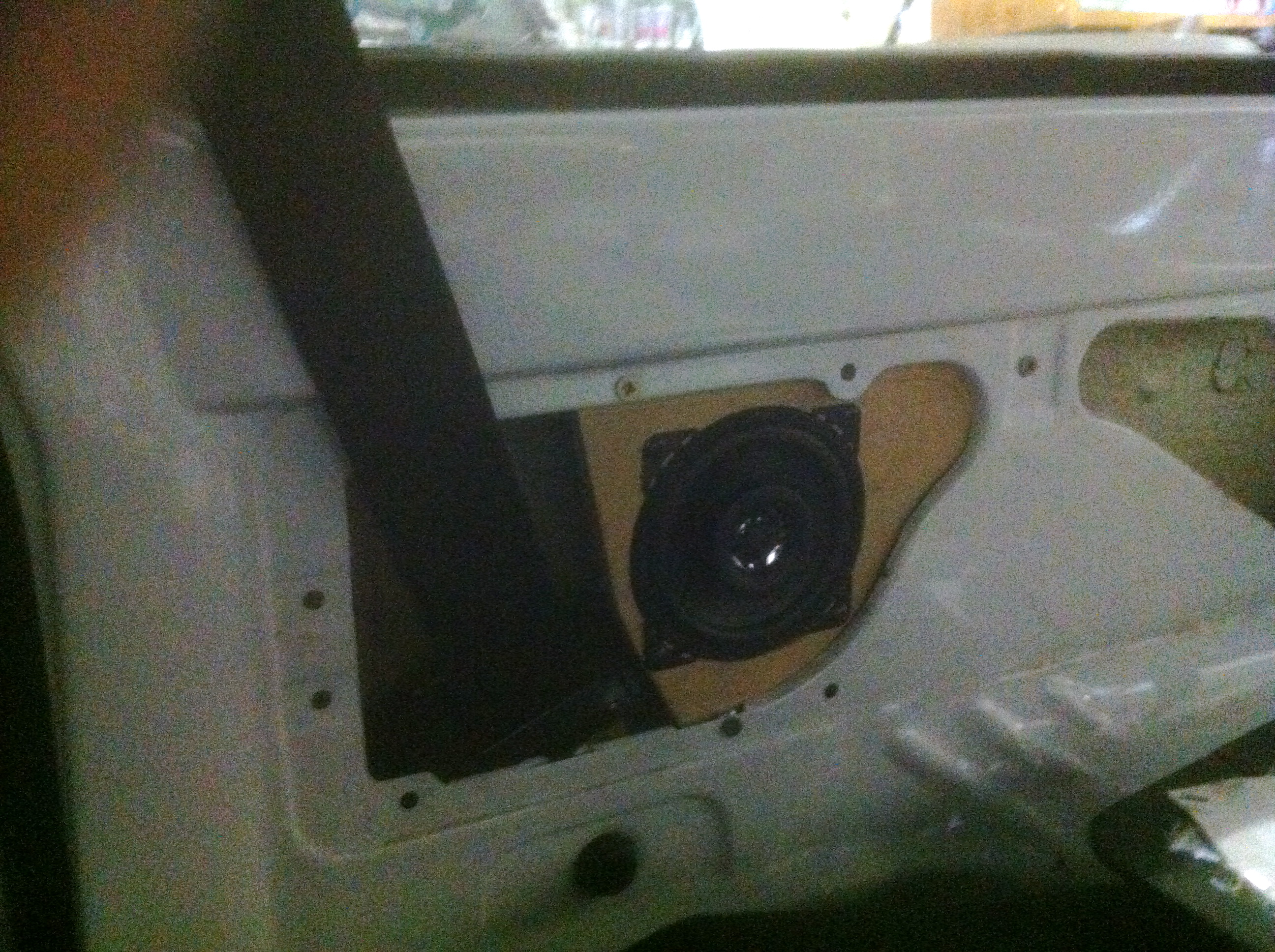

I managed to find an amplifer small enough to fit under the passenger seat and this has now been wired in. The rear speakers are now also fitted, only the grilles had been fitted to the side panels until that point. I didn't want to fit the speakers themselves to the side panels as they wouldn't have been rigid enough with the extra power so I made a mounting board so that they could be bolted to the body.
I thought I'd taken pics of the amp & speakers but can't find them, will take some more tomorrow :confused: The front speakers now have white grilles to give more of a black/white theme so I wanted to show this to get opinions on how they look, well mainly Gavin's.
