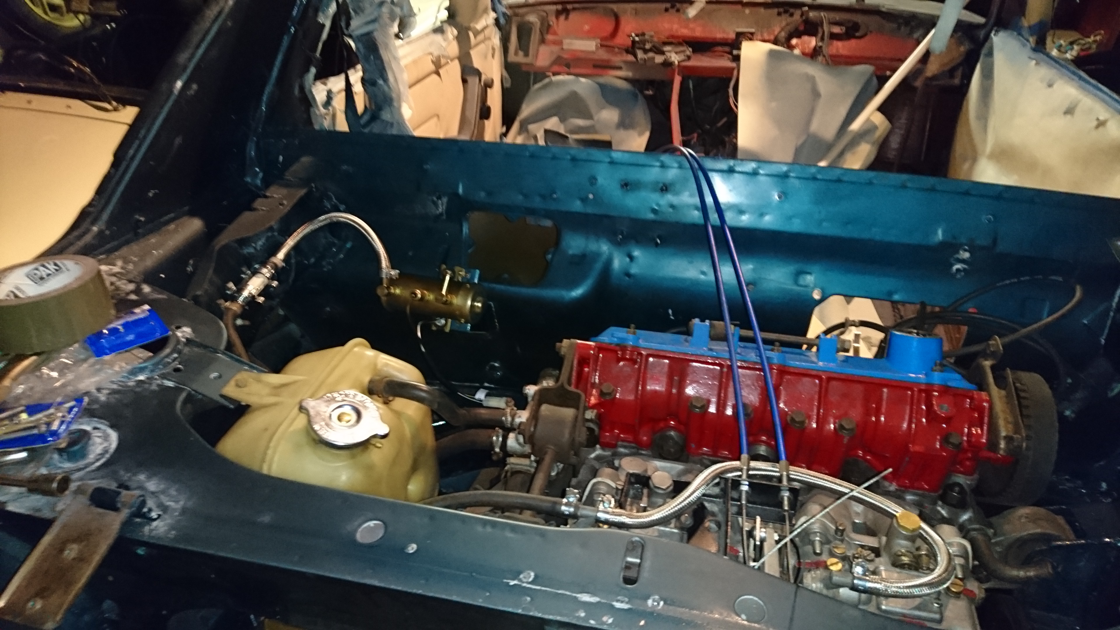

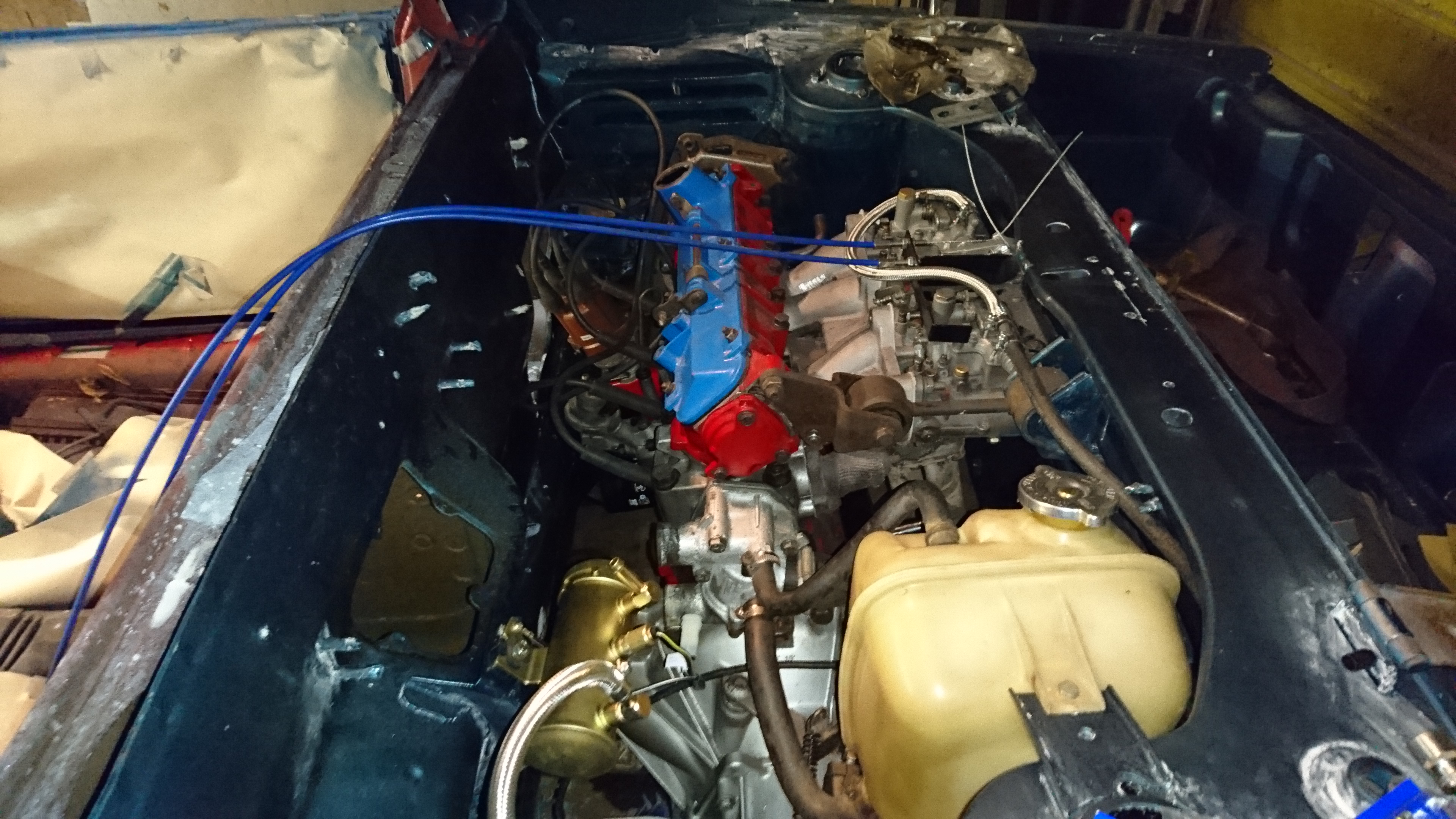

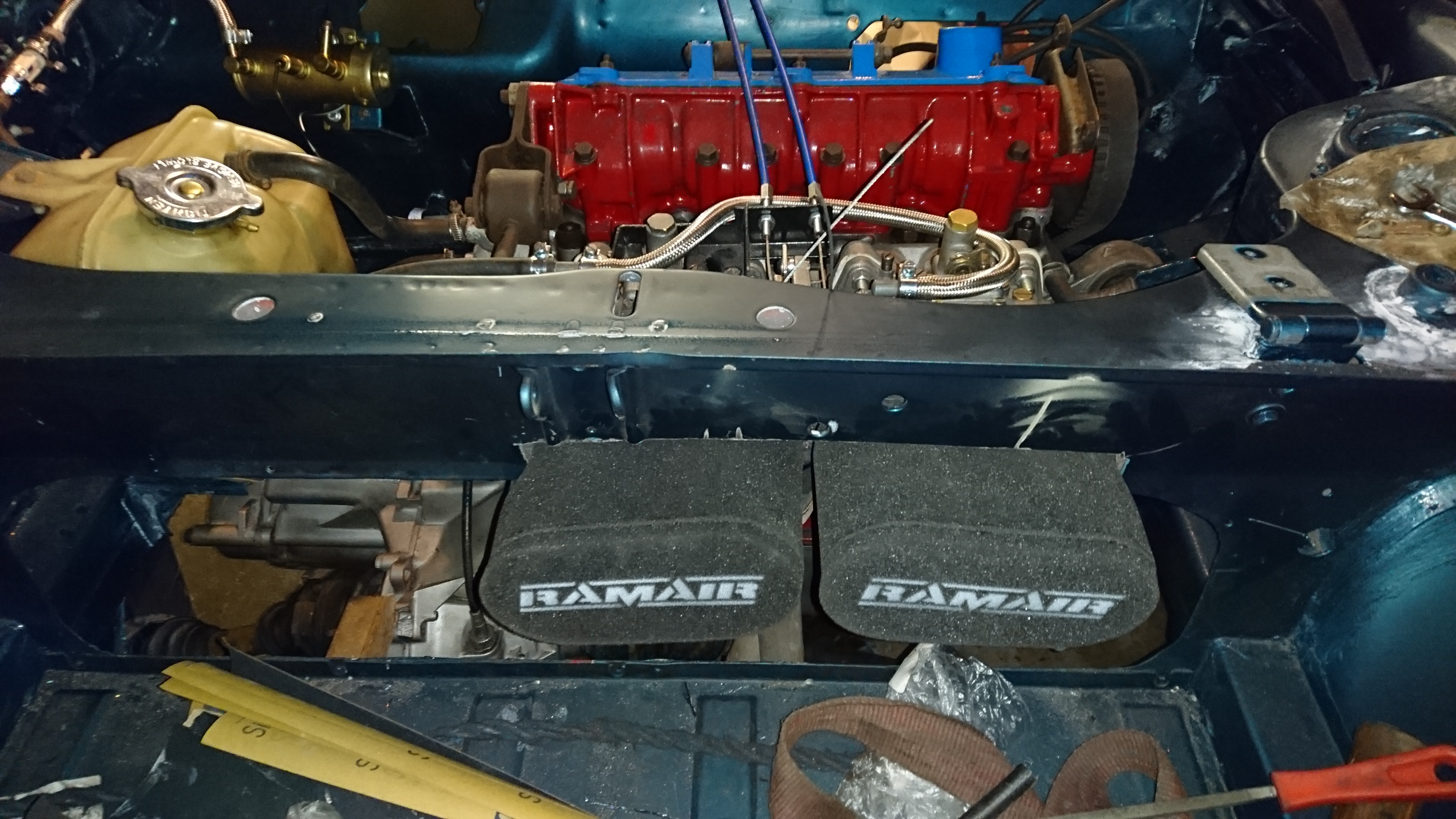

Nice carb set up. Is there space to have the trumpets offset somehow to save altering the body? I guess not.

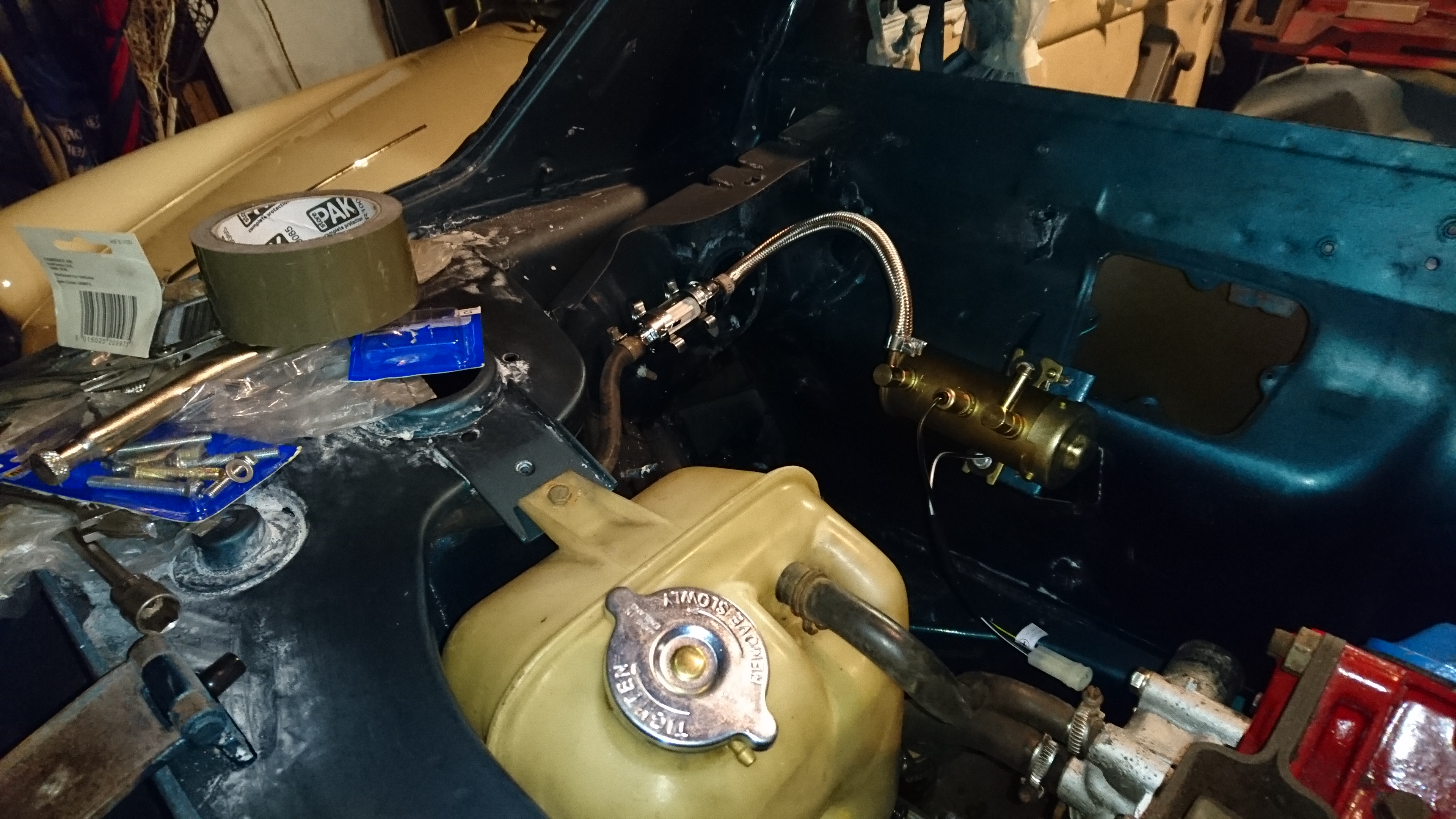

Cut out the rear part of the engine bay and the trumpets fit! Bolted on the exhaust but I really dislike it. Any reasonable upgrades? Or shall I try and build one using a cherry bomb silencer? It'll stay for the time being at least...
