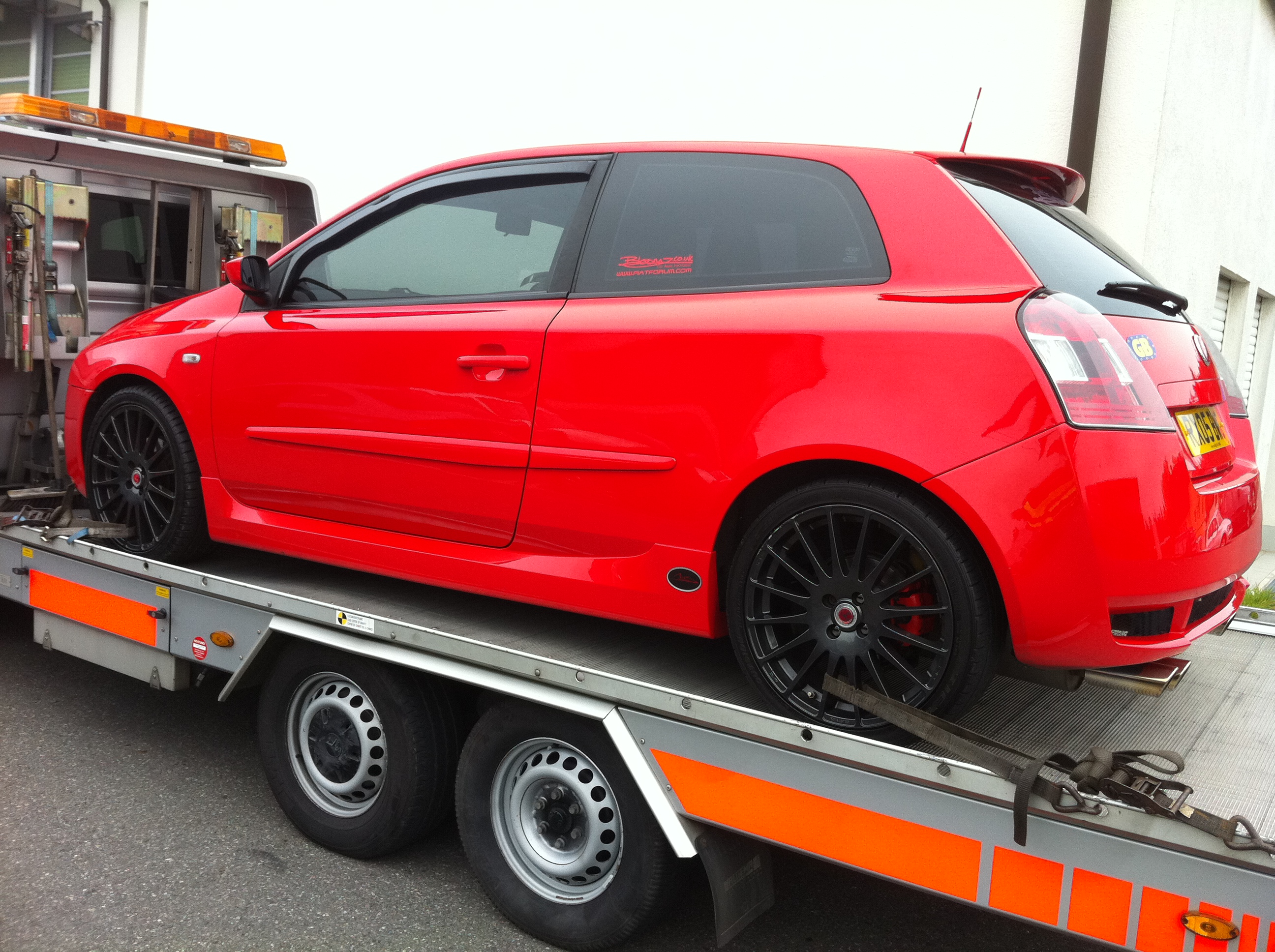

my low oil pressure light came on the suddenly the engine just cut out :mad: and now wont start. Engine made a weird noise when slowing down. Oil level was fine, just under the max line. Away back to Fiat for a check up.
Anyone any ideas before I get a huge bill??? :mad::mad::mad:
Ta much
Cheers for the welcome
Cam belt was "supposedly" changed and serviced before we got the car, but they will say anything for a sale. Sent back to the Fiat garage we bought it from, still in warranty as only just got it. Hopefully they don't hit us with the usual crap.
Will find out the damage tomorrow, will keep posted.
